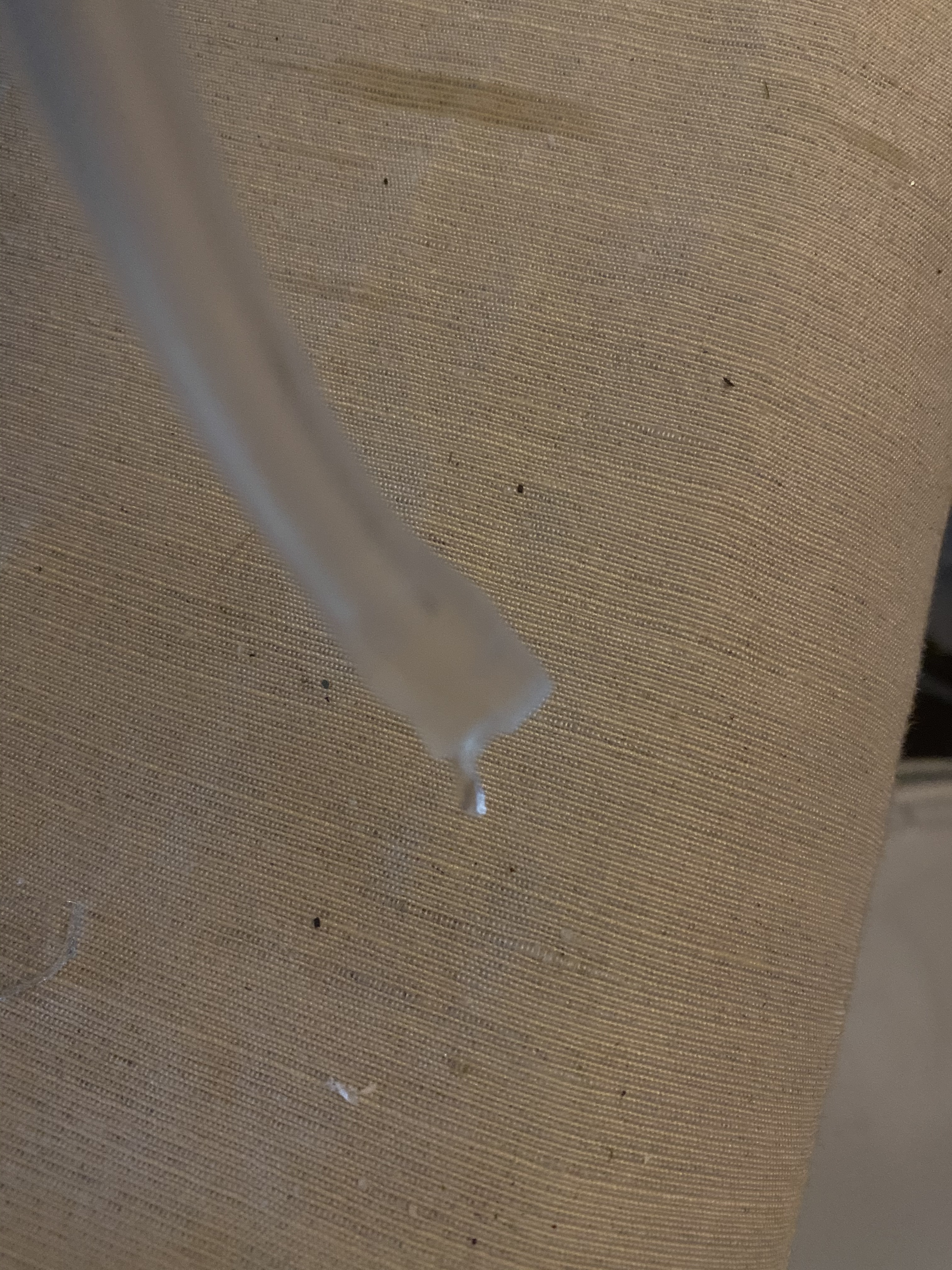

Just switched my machine on this morning and within a few seconds there was water pouring down below the cutting bed. On further investigation it seems at the exact spot where the water tube is attached to the laser has broken. The tube just pulled away straight away and there is broken glass attached. See the pic. I’m assuming I now need to get a new laser tube?
Dang, hate that happened to you. You could try some epoxy, but I don’t think it’s going to be a good fix. Sad to say, but I think it’s best to get a new tube.
Thanks, yeah, I figured I would need a new tube. The other question now would be - should I consider upgrading to a new unit (maybe 50W - 80W)? Would it be worth it or is the 40W just as good and not worth the extra cost to buy a new, more powerful machine? I was engraving slate, acrylic and glass before at a medium volume rate so maybe this could have been wear and tear on the tube? I have had it since late Sept.
For the cooling attachment to break it is more likely a manufacturing fault; probably there was some tiny scratch/crack/internal stress that propagated.

Thanks for the replies guys. I have been using this machine since late Sept with success. It has been in a garden house and the water was successfully cooling the laser. Granted, It has been colder these last few days (but only to -3C or so) and I hadn’t used the machine in a few days as well. It’s a shame as I had committed to getting some slate and acrylic to people this week. In terms of replacing and refitting a new tube, is this a difficult task? What do I need to do this? I may just look to get a replacement tube for the time being (700mm long approx) but def look to investigate the possibility of an extension so I can get a bigger tube - has anyone any advice on how to attach the extension casing and then is it the same as a usual tune replacement?
If ambient temperature was -3C how sure are you that that it didn’t freeze water in the tube? That would do it!

yeah, that’s my suspicion. That maybe the water at that junction was frozen or at least semi frozen and then when I switched the machine on today the liquid pushed the frozen part and caused the break. Unfortunate, but we all learn!! Anyway, way above I was asking if it was worth the ££ in actually investing in a brand new unit but I see that for higher wattage machines they seem to increase in price exponentially. If I was to look for a brand new higher wattage machine, then what kind of prices would I be looking at in the EU or UK market? Or are they even worth it and should I just get a new 40W tube, and try my luck at installing it and starting again :slight_smile:
I leave my water pump on continuously in an attempt to stop it freezing.
I dont know if it will work - I guess I’ll find out one day.
Well, water expands when it freezes. Water freezing in pipes bursts the pipes.

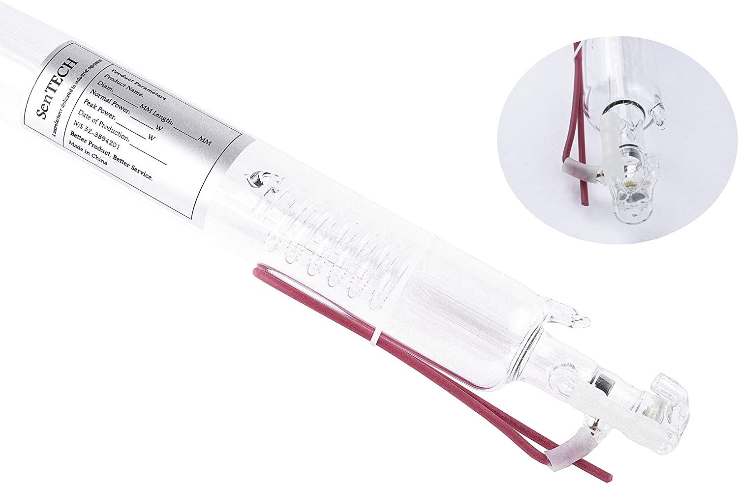

Thanks man - I think it’s def something I want to look into in the near future. For expediency, I will look to get a new ‘40W’ tube ASAP and then look to expand in the future. I want to get back engraving ASAP. I started this in Sept as a hobby and it’s kinda turned into a small business. I’ve been able to cover my costs when I hadn’t even been intending to :slight_smile: Here is the tube I am looking to purchase.
Looks sane. Get silicone tube and silicone sealant for where you attach that red wire they have already provided for you to the wire coming out of your laser power supply. Don’t just wrap it in electrical tape, for example.
