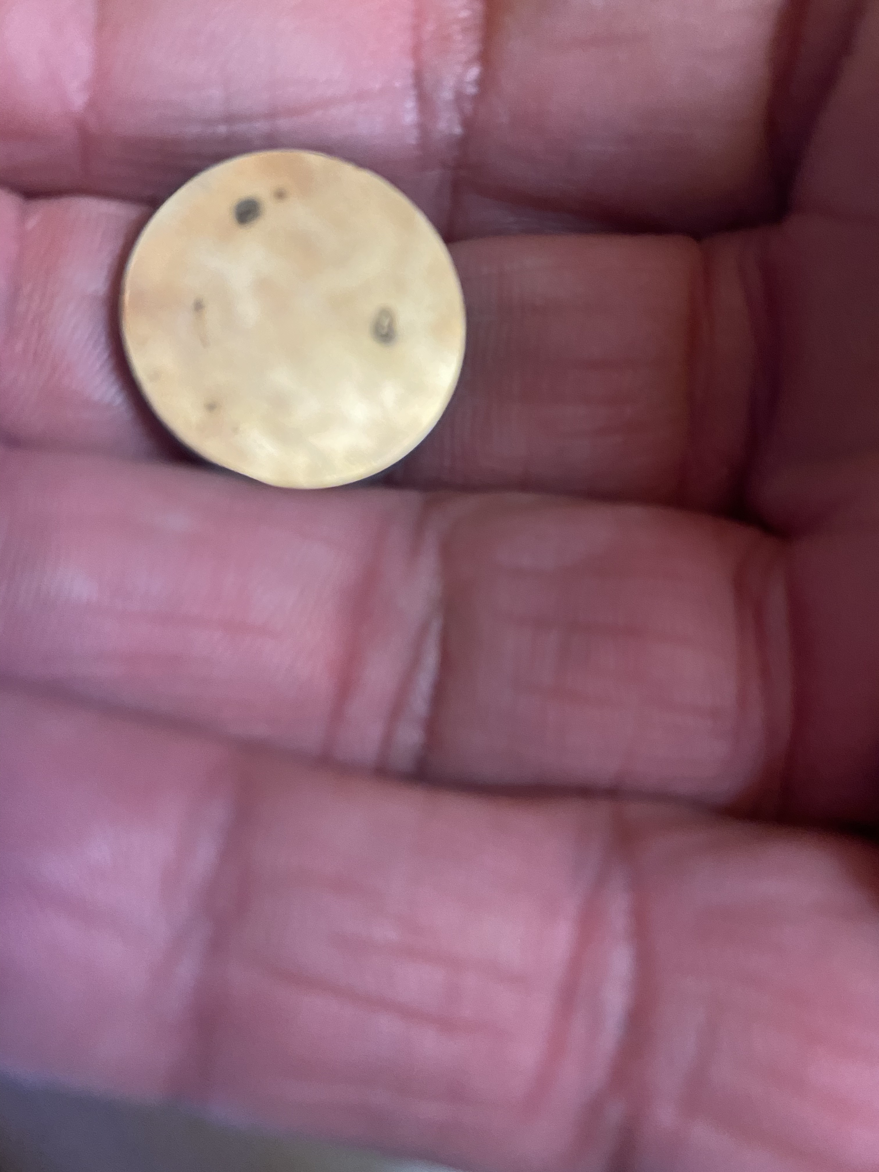

I played about again with alignment and seem to have fixed the splitting problem. But the fading toward the right bottom still remains a factor. From what I am seeing, the beam hits to the centre of mirror 1, then also to the centre of 2 & 3. I took out mirror 3 and it doesn’t look to healthy but that wouldn’t explain the fading though?
That doesn’t even look like a mirror to me.
Is that the front surface?
No telling what that would do!
believe it or not, I took it out from the mirror 3 holder…
Not sure how long it’s been like that but it looks burnt in those 2 areas!!
you could probably do better putting a penny in there …lol
yeah, I think I’ll get some new mirrors (at least to replace mirror 3) to see what (if any) difference that makes!! It just dawned on me earlier to check it :slight_smile:
Better mirrors is one of the best power improvements you can do.
I would check and potentially replace them all …
