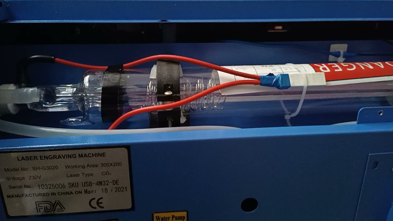

I’ve recently bought a K40 laser and tested it today. Sadly when I tried to test the laser there is just some crackling noise and arcs from the red wire “small white box” from the picture.
I don’t see any water leaking into the tube so I assume the tube isn’t broken or anything.
I’m kind of out of ideas what it could be or what could solve it.
The ground wire is connected to the frame, the mA meter always stays on 0.
I also thought about isolating the white box and the rest with some silicone that came with the laser or the tube could be in some other way defect.
Does anyone have any solution?
By the way, I drew where the arc went out because I don’t want to run the PSU and damage it in the process.

that white box is most likely a splice which was done poorly so you can probably fix this by doing a proper splice. High voltage likes to jump off any sharp points so if you google for how to splice laser tube wires you should see many ways which result in no ends of wires sticking out and probably instructions on how to apply the insulating coverings.
As for the tube Ground going to chassis ground is that really how it’s wired? I would think the wire would come from the end of the laser tube, to the mA meter then from the mA meter back to the L- or something like that on the Laser Power Supply(LPS). Or maybe you are just talking about the AC chassis ground people often mention needing to be cleaned up and made better instead of Laser tube ground going to chassis.
K40 Intro at the top of every page here links into the Getting Started with CO2 Lasers section, including this article with resources on splicing correctly:
An unloaded LPS will arc from almost any weak point even a splice and sometimes directly from the anode.
The fact that you have 0 ma on your meter may mean that the cathode is not grounded or the tube is dead. Either will cause a violent arc from the anode side.

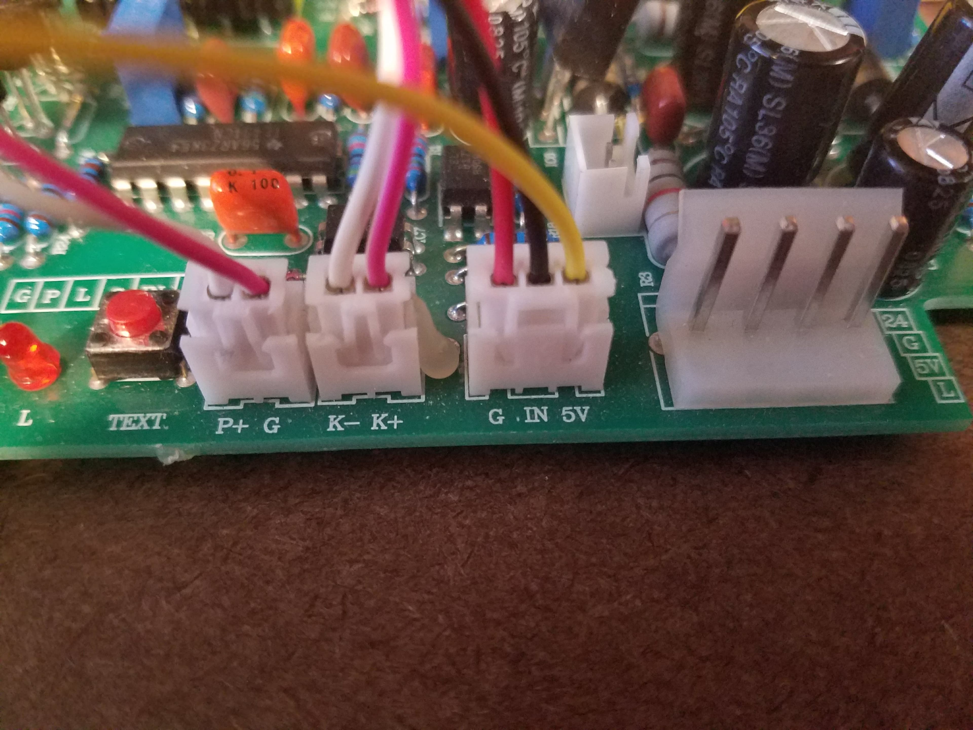

As @dougl mentioned the tube’s cathode should go to one side of the current meter and the other side of the meter should go to the L- on the laser power supply in the leftmost connector. DO NOT confuse that with L on the rightmost connector.
Note the L- on the leftmost connector
If that is wired correctly?
  • Does the plasma in the tube light when test firing?
Post a picture of your LPS showing the connectors.
A video of the tube firing/arching may also be helpful.

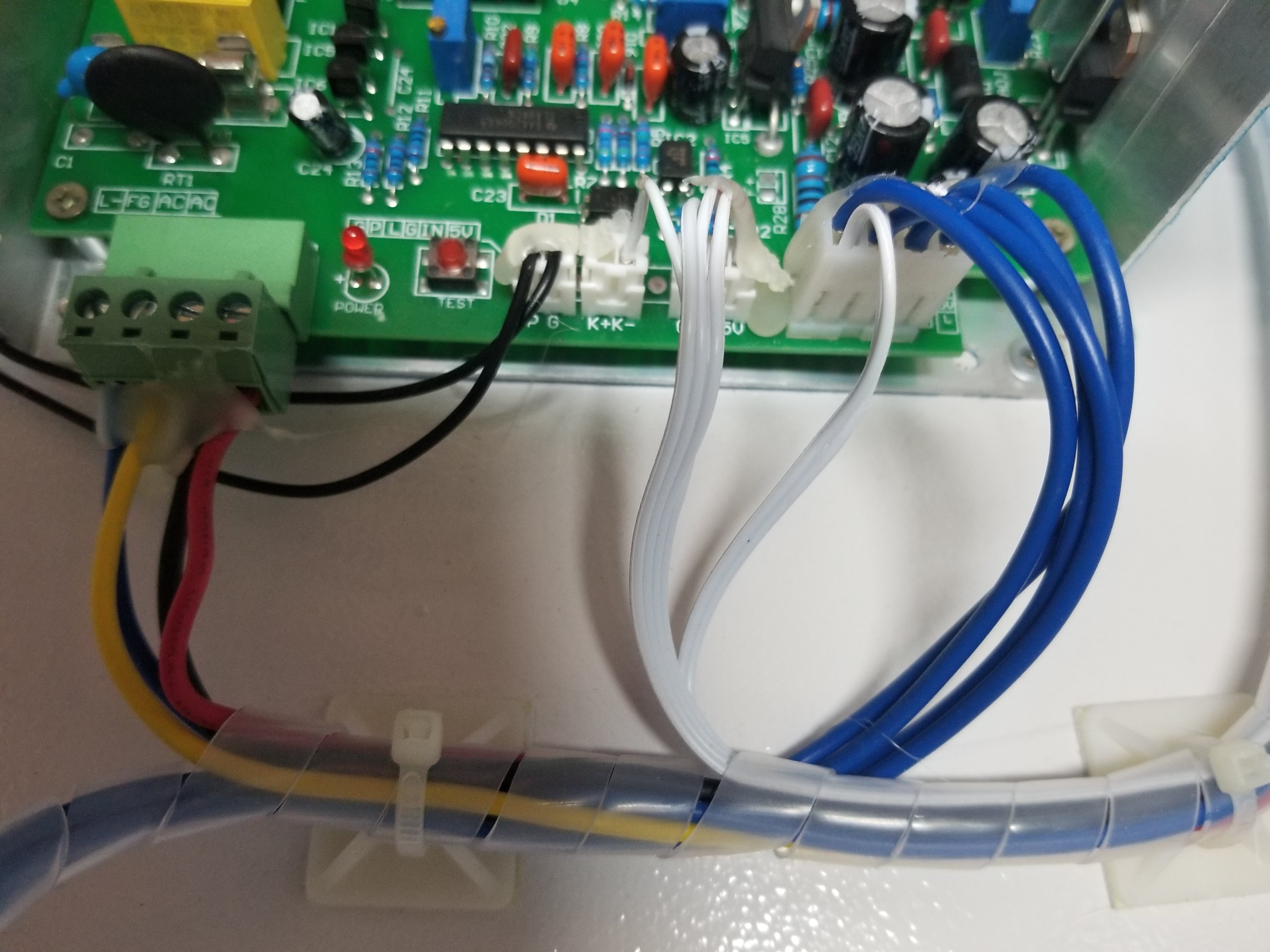

Ok here’s a picture of my PSU and a video of the now suddenly nonexistent arcing, somehow it stooped.
Hope it’ll give you more information.

Caution: It looks like the cover may be off of the LPS?
It’s not necessary to be inside the LPS at this time. This high voltage CAN KILL YOU so stay away from it!!!

**It should be the middle pin on the second connector to the left looking at the LPS.
