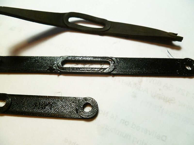

Hi Don
Thanks for your reply and thoughts on my problem.
I attach a picture of a broken original and a couple of 3D printed ones in TPU which is sold as ‘high elasticity’ but at 2mm thick I can’t make it move lol!
As I hope you can see from the picture the bands are 2mm thick with thicker 3mm raised areas around the holes at each end and the slot in the centre.
So I need to make the new retaining ‘bands’ look as near to black ‘vulcanised’ rubber as possible as this is a ‘concourse’ restoration.

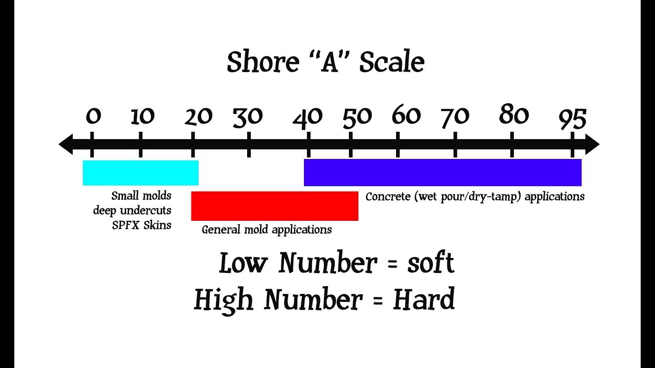

What durometer do you think you need?
Do you know what the durometer of the original piece is?
I think getting an estimate of the hardness of your application will be important.
These aren’t to $$$, mm I may get one.
@HalfNormal also needs one:
Looks like a good place to research is under “mold making” as they use different hardness silicon for various molding applications.
Interesting video on hardness in mold making:
This stuff runs about 30A: " A 30A hardness is in the soft to the medium-soft range, between the flexibility of a rubber band and pencil eraser"… reads like the range you are looking for. A rubber band is about 25A.
