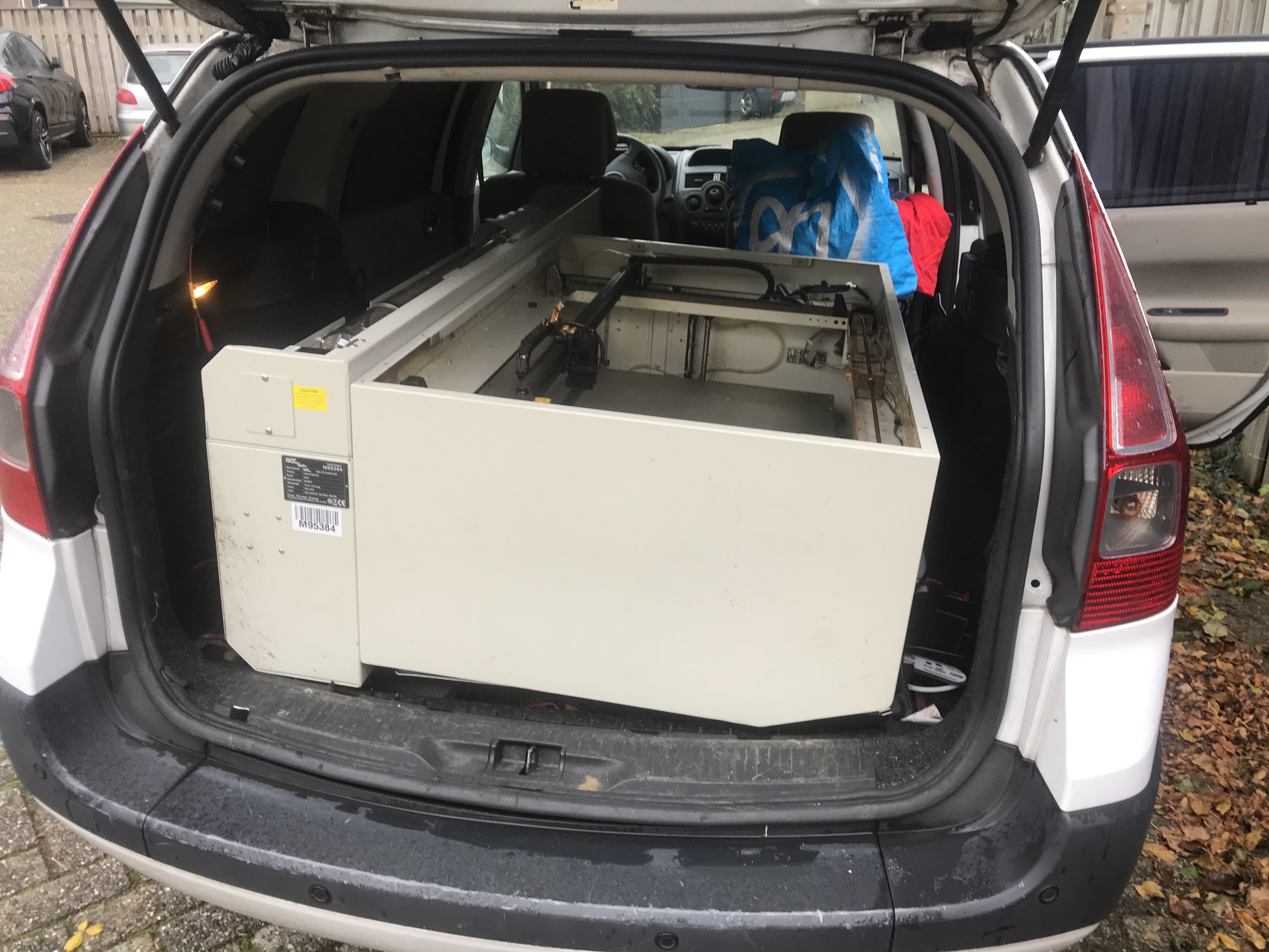

Hi, I found myself a Lasermachine for an offer that i couldn’t resist :wink: It is a Gcc X252 machine with the gantry etc but missing a lot of parts. Since i like a challenge i started my new adventure.
I’m looking for more info about the parts in this machine. Does anyone here have such a machine and can tell me something more about the mirrorholders, and the psu voltages for the mainboard. However I’m in doubt to get it all out and replace everything with for example a Ruida system. Since the servo controlled X motor is also missing, or can I replace it with a closed loop nema 17. Lots of thinking and tinkering to do. :smiley:
But for now I would be really happy if anyone can share a photo or measure the mirrorplates for me. It should save me some time. The plate from the head is most wanted.

We need a lot more information.
Pictures of well… almost everything :slight_smile:

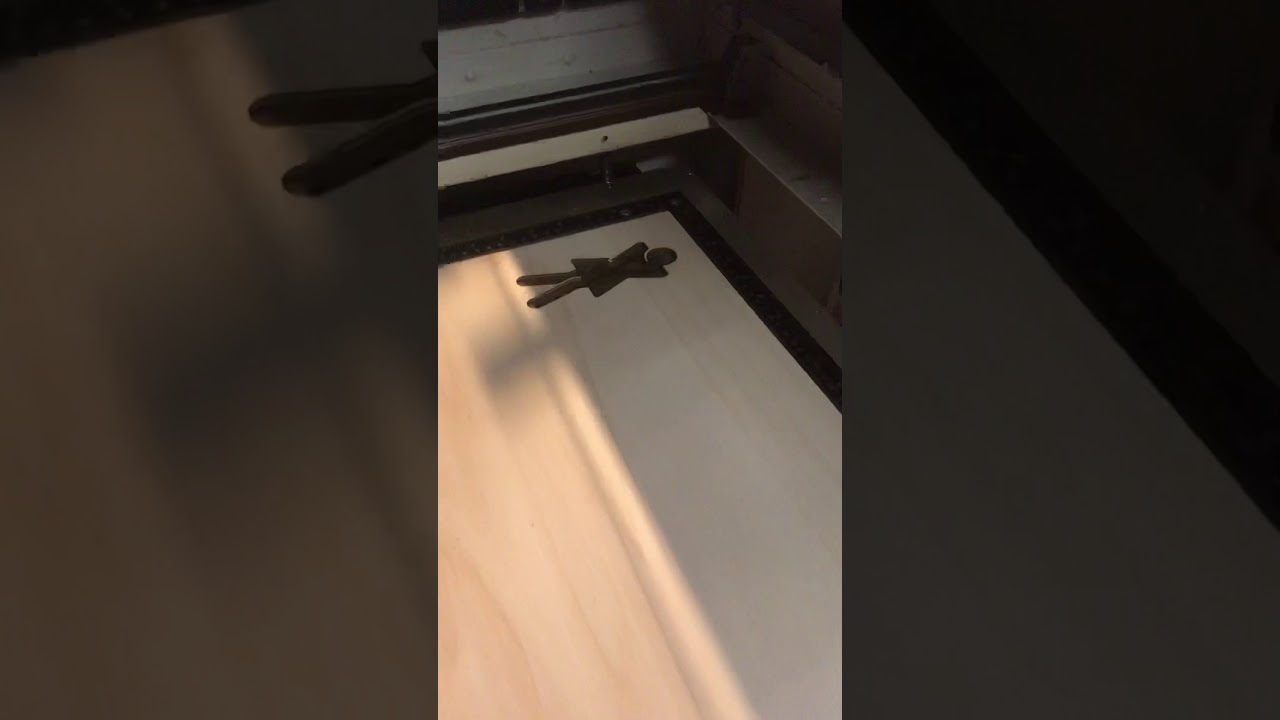

My first succeedings. Used Closed Loop Nema 17.
That is sweet!
