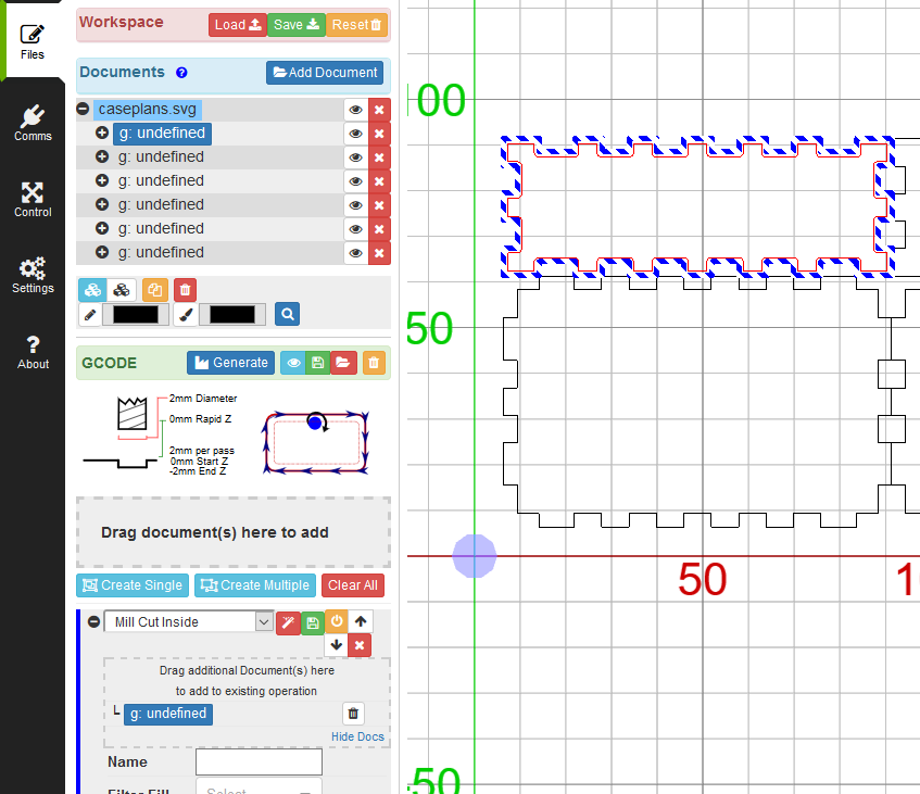

I don’t see any way for that to actually enable CNC mode. I’m sure it’s hidden somewhere, but I’m not finding it now any more than I found it last time… I just see it set to false in configuration and don’t see how to change that.
The CNC-Mode flag was removed long time ago, because it’s not needed. You just have to select the correct CAM operation (like “Mill Cut Inside”).
Aha! Progress! Thanks.

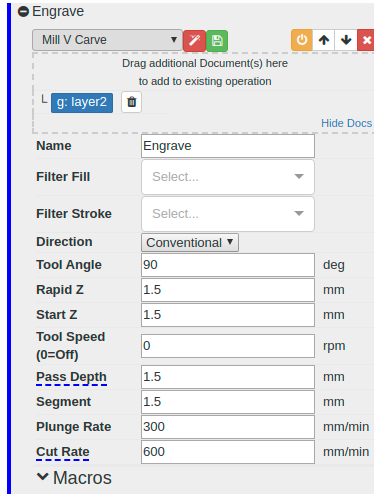

Unfortunately, the layer with a few lines to v-carve gave me an empty job. I think maybe I don’t know how to set up v carve operations.
; Operation: 0
; Type: Mill V Carve
; Paths: 0
; Direction: Conventional
; Rapid Z: 1.5
; Start Z: 1.5
; End Z: 0
; Pass Depth: 1.5
; Plunge rate: 300 mm/min
; Cut rate: 600 mm/min
; Retract
G0 Z1.500
That’s the entire operation. Having an End Z of 0 it makes sense that it wouldn’t do anything, but there’s no option for End Z that I see in the UI:
The v-carve operation needs outlines around forms (closed objects) to v-carve the inner part. It’s like mill inside. Single lines will not work.
Oh, v-carve is for chamfer, thanks. What operation(s) can cut single, unclosed, lines? I see that at least Mill Cut can, and seems to have done what I expected.
