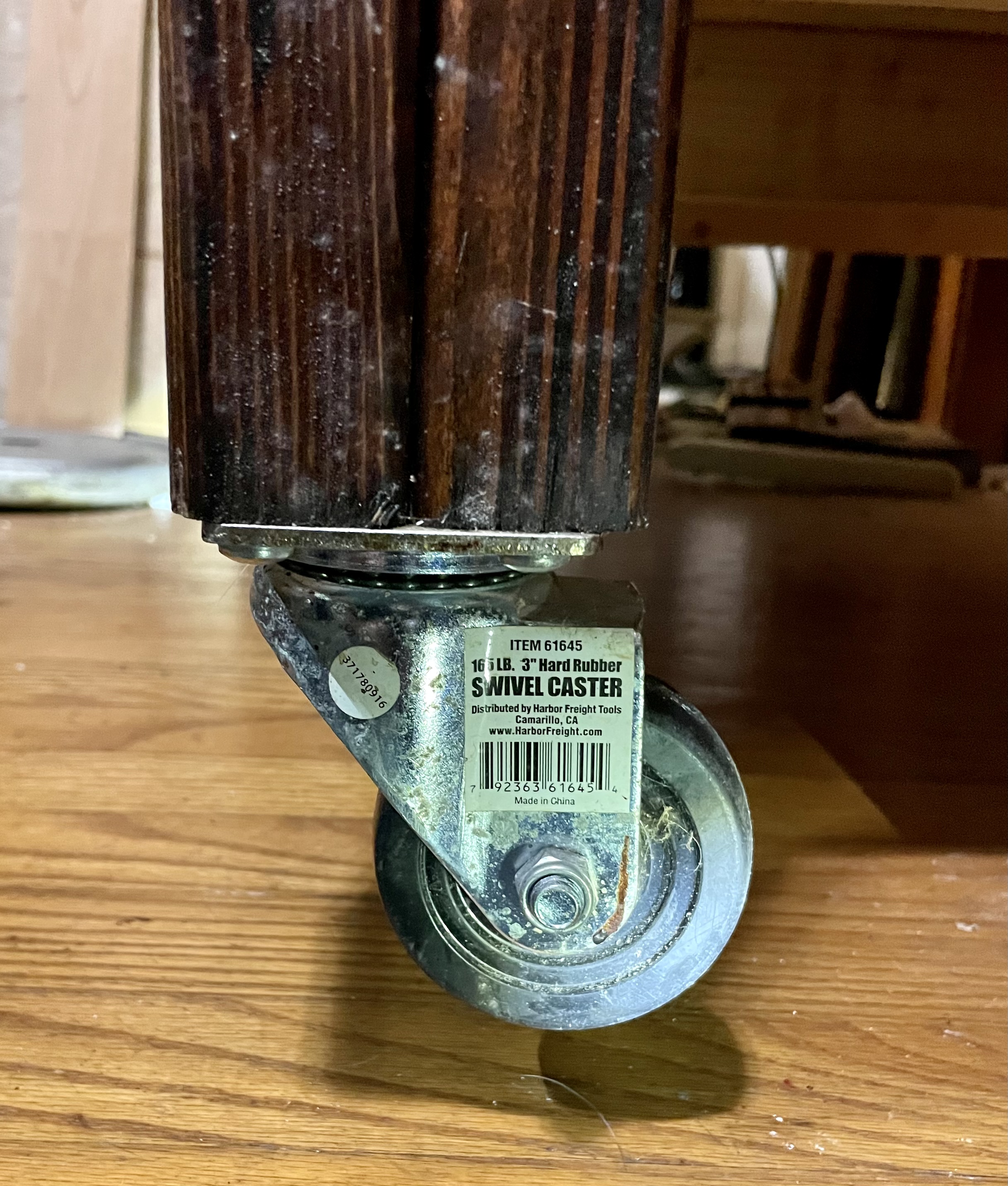

My new 50W laser really starts shaking when I do engraving. The problem is that the table I made was originally for my much smaller K40 and rests on swivel casters so I could move the table to get behind the machine when I needed to. The swivel casters have some play in the swivel joint by default. This was fine for the K40, but the 50W has a much higher mass head which sits much higher above the table, giving it a greater moment arm to induce oscillations.

Because of the way the table is made I was able to put the new casters on the inside of the legs so they are out of the way. Work like a charm and very little shaking when engraving now. May add some cross bracing to the back of the table to stiffen it up a bit.
