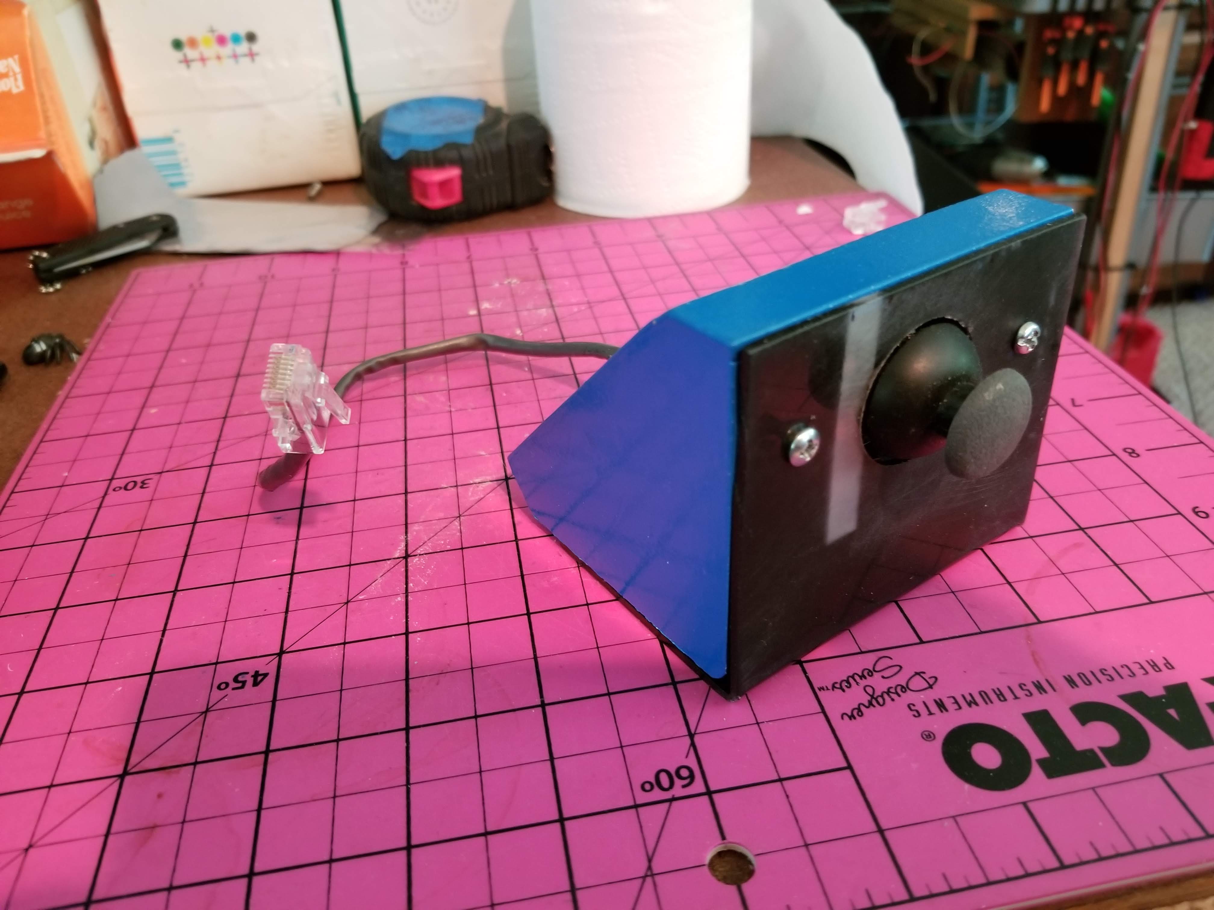

I got tired of the large and kludge’ey controller that I built from LO electronics.
I am about to complete a new LO lift table controller and I will post on it soon.
It uses and arduino/easy driver and joystick and fits neatly in the bay.

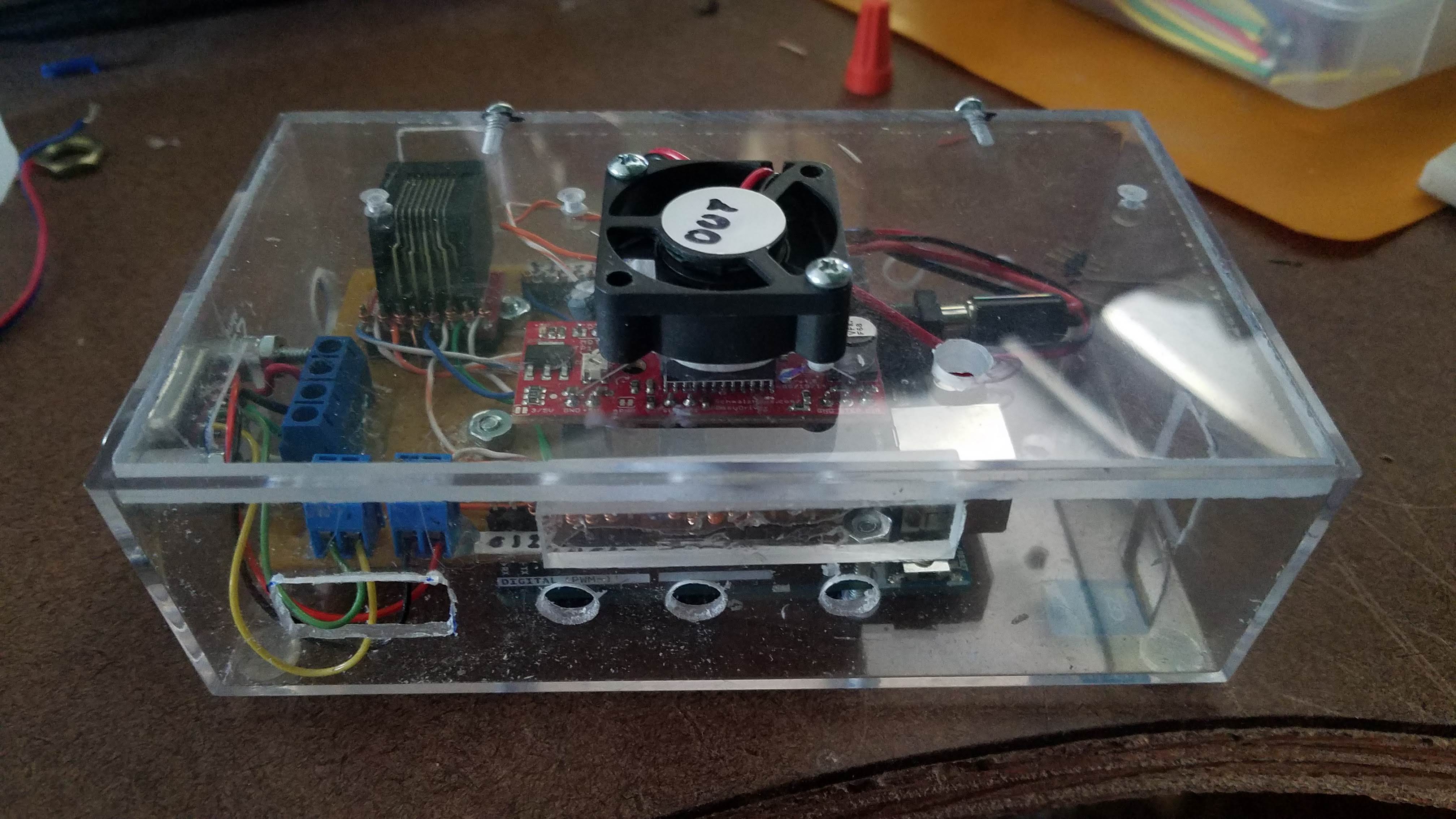

On my new controller I had to add a heat sync and a fan.

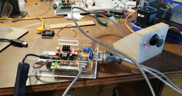

I to date have built 3 controller protos for this thing!
When I built the first arduino controller (#1) I measured the current as much higher than the driver could handle and that always puzzled me because the motor specs weren’t that high.
I abandoned #1 and built an external controller with cheezy switches just to get running.
My guess was that the table’s mechanical resistance is causing the elevated current?
That is why I went the route of an external controller but I never really liked the implementation.
Then after seeing users searching for a lower cost controller that was arduino based I figured I would try again. Build controller #3 which would meet my needs and those wanting a cheaper solution. Along with this controller I adjusted out binding in the shafts and lubricated all the moving parts. I had to crank the current to max and add a heat sink and fan to keep it cool enough. This version is completely stand alone and has these features:
  • Up down motion using a small joystick mounted on the front of the machine
  • 3 speeds with indicators set by the joystick switch
  • Endstop limit controls
  • Built in diagnostics
  • Open source code & schematics.
  • Made with an easy driver board and arduino both of which are pretty inexpensive.
  • Integrated 12VDC supply
  • It is run off of the LPS 24V [which I am now revisiting].
Then as I was researching methods to interface this with the software I found out that C3D and Lightburn already had this all solved quite elegantly interfacing an external driver with the stepper controls and treating the table like a z axis…nice! There are some cool cutting features that come with this setup when using Lightburn.

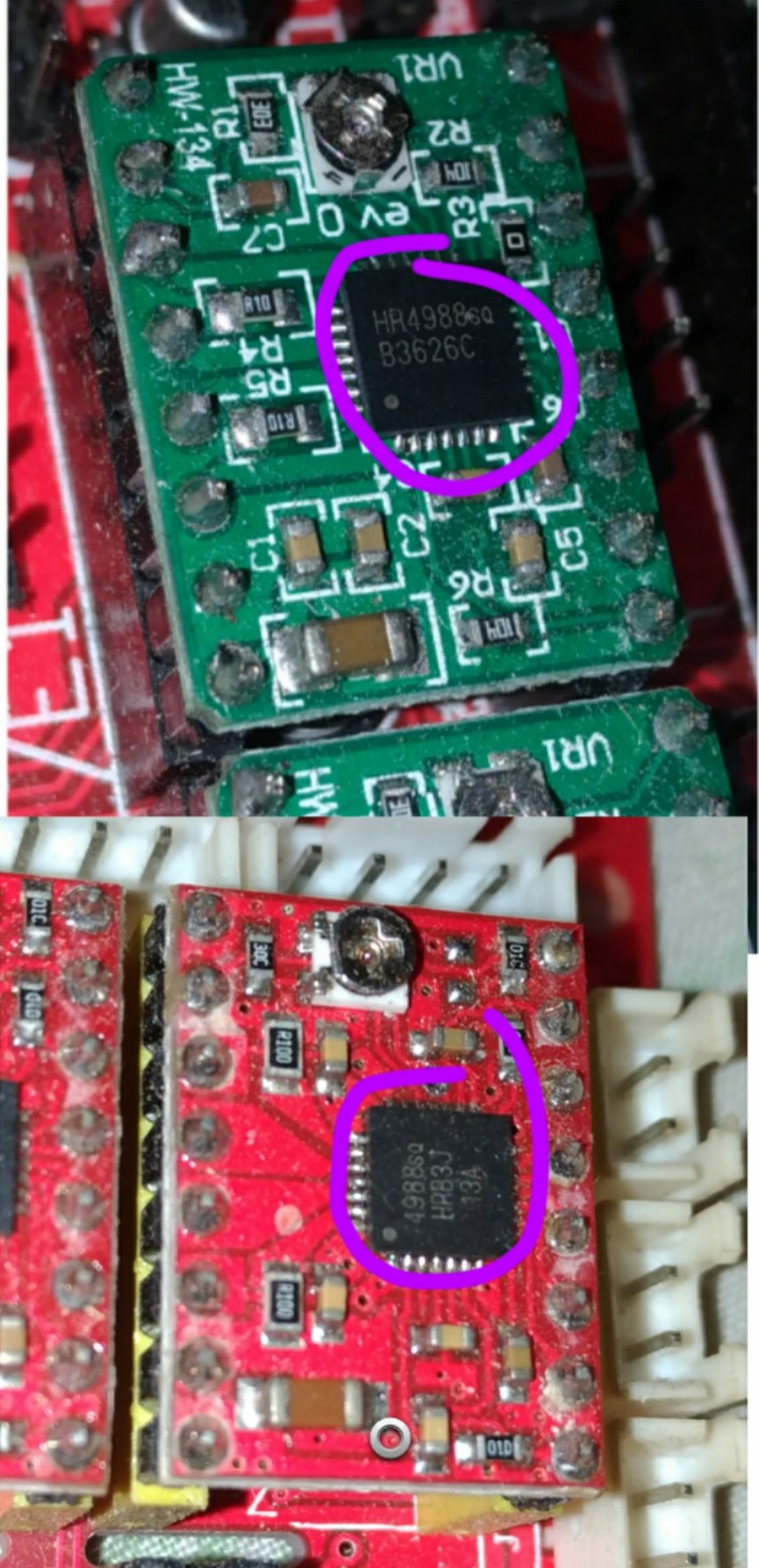

hi, excusme
week ago i bought some driver A4988, when it’s come i got HR4988 green color,and i’m see the chip it’s different with my oldest red A4988, like this
.i want tok asking in here,may anybody can explain about spesific and comparison driver between A-4988(red) and HR-4988.
thankyou verymuch
