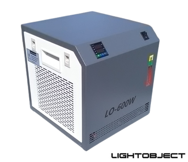

Lightobject 600W Mini Water Chiller
I have to say, one of the upgrades is working really nice, it was expensive, more than the cost of the laser, but it is great not having to worry about having ice.
Nice but pricy.
