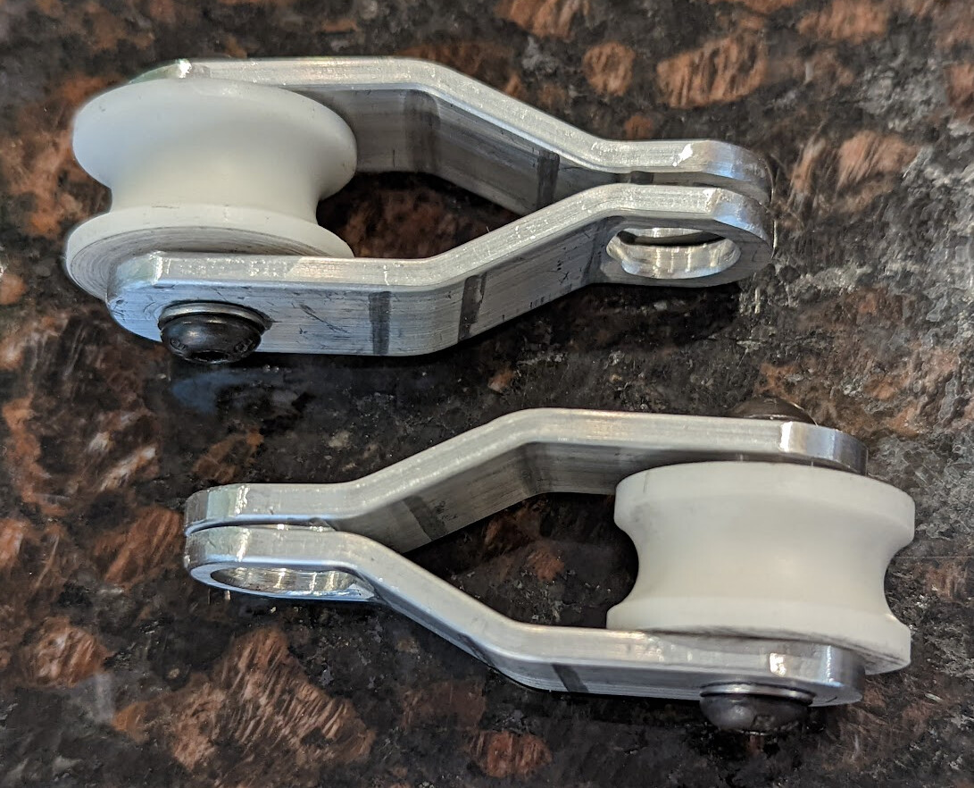

My son brought the Freehand snatch block set we made freehand camping, and it made me curious about improving the design, as I documented in that thread. I got out FreeCAD and got to work. Weeks ago, my son and I machined a press fixture to make precise bends carefully located, and today we finally got back to the project. Here’s the end result:
What follows is a build log for your entertainment. This design has not been analyzed by an engineer, and I honestly don’t know how strong it might be. Also my build technique probably made it less strong than it could be. We will not use this in any way that puts health or property at risk if it fails.

When we were done, we had a pair that looked like this:

We reused the pulley we made when making the freehand set, and assembled the whole thing with M5 washers, M8x5 button head screws, and a dab of loctite in each end.
:feather: 32 grams total :tada:
Lather, rinse, repeat:
All in all, a fun and successful father/son project.
