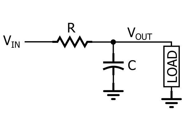

The resistors and capacitors in your original post are electronic filters that allow some frequencies to pass relatively unimpeded but absorb others. What you want is something that blocks high-frequency signal and passes low-frequency signal. This is called a ā€œlow pass filterā€ and here’s a technical explanation:
The values of the resistors and capacitors determine what frequencies to pass and which to block.
Basically, fast voltage spikes from interference pass through the capacitor without raising the voltage at the input to the point that the Arduino detects the switch has been triggered, but if the switch is actually activated, the capacitor quickly ā€œfills upā€ and the Arduino triggers. There are resistors inside the Arduino processor (called pull-up resistors) but they are between 20K and 50K so the 4.7K external resistors in your diagram reduce susceptibility to noise.

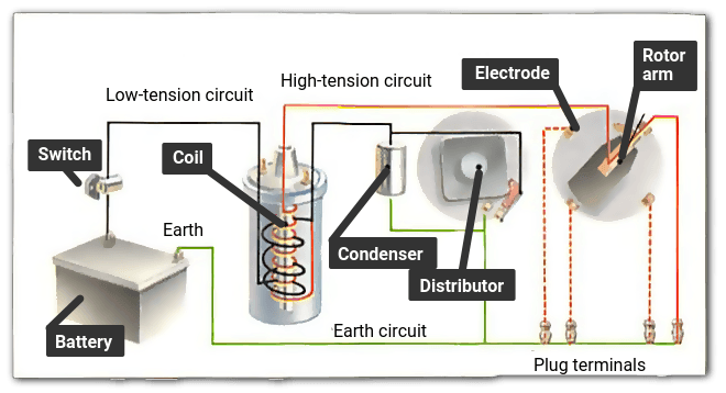

I think if you drew the circuit with the points closing the circuit with one side of the coil and see the cap across the points you’d notice when the points are open, the coil field collapses and at that point the coil and capacitor are in series with the cap grounded and the high side of the coil at 12V. Points side is floating. Back EMF from the collapsing field buffered in the cap and might be some settling but nothing with enough power to affect ignition.
Great drawing… As I stated, it’s across the points, it purpose is to protect the points.

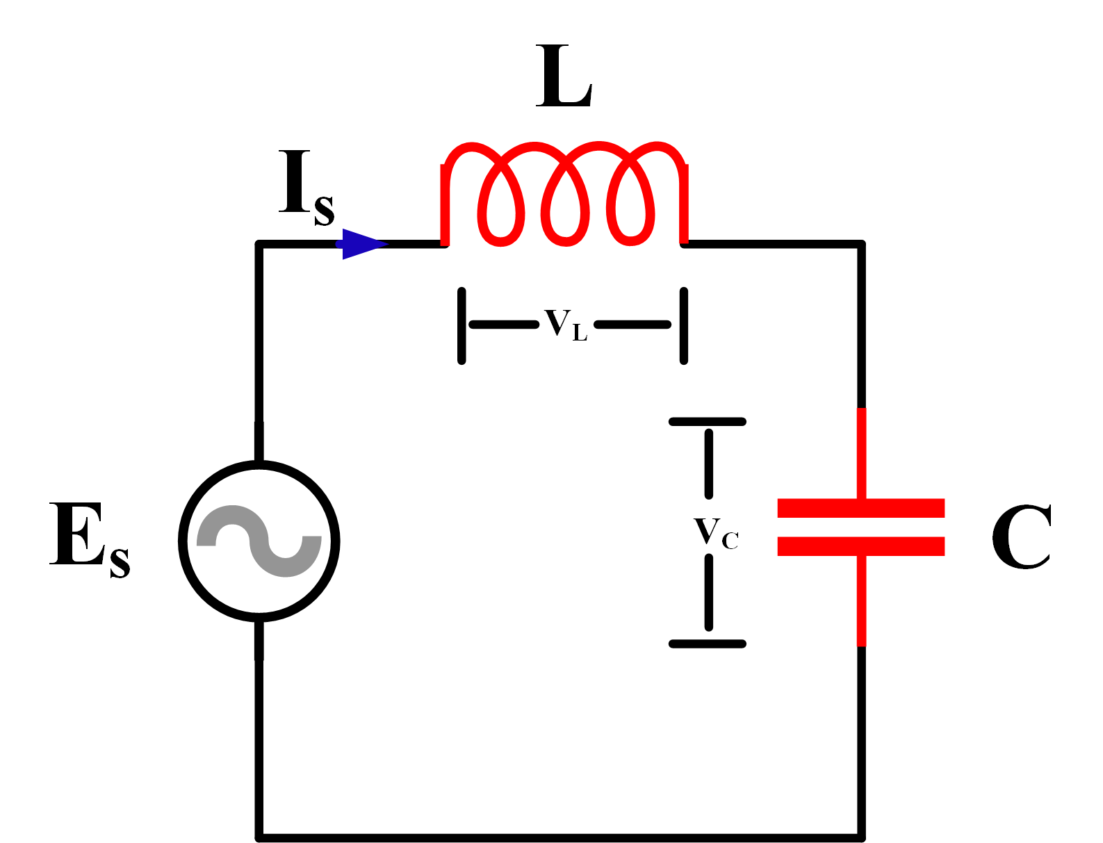

I’d like to ā€˜point’ out that there is a series lc circuit. Here’s a schematic, but it’s fed with ac, not dc and the capacitor isn’t ā€˜shorted out’ through 1/2 the cycle or part of the operation.
