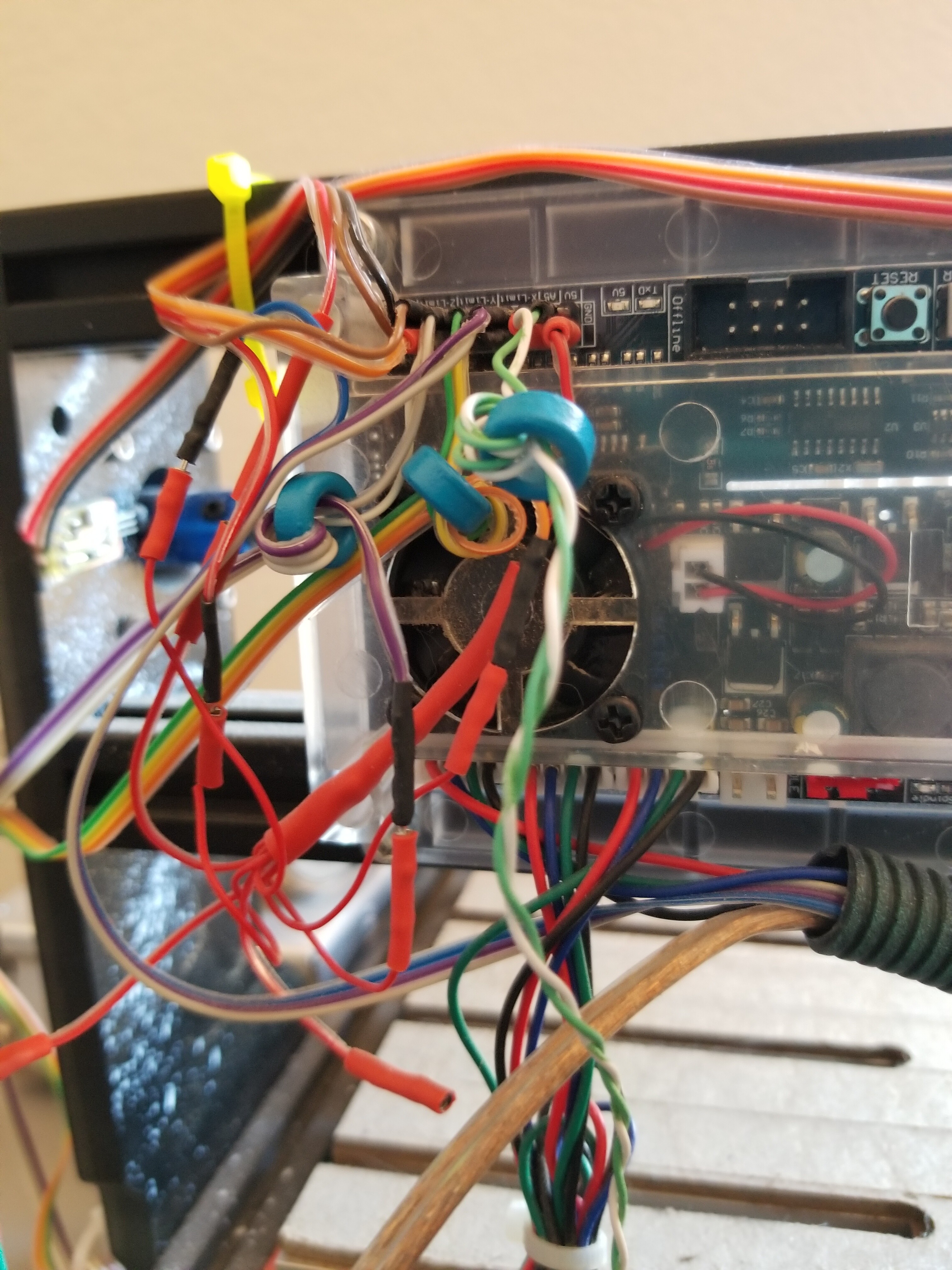

When I first installed limits, I had put protection in the wiring ā€˜nest’ as it was close to a birds nest… They are the blue ferrite cores that I looped the twisted pair through. I found I didn’t need them, but they are a cheap approach to suppressing rfi.

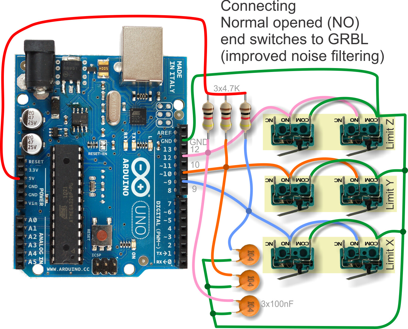

  1. Never run a data line or Vcc line without a return (ground, aka common) line right next to it.
  2. Use twisted pair for runs more than a few inches, Ethernet cable is good for that but it will not stand much flexing. So don’t run it through any cable chains.
  3. A capacitor across switch contacts means you are eroding the switch contacts, as the capacitor discharges. It also makes every switch radiate a little RFI as the switch closes.
  4. Lowering the value of the pullup resistor makes the data line more ā€œstiffā€, ie, lower impedance, and so less affected by nearby RFI pickup. 4.7k is rather high resistance for operation around motors pulsing currents in the range of several amperes. Try 470 ohms.
  5. Don’t daisy chain grounds and Vcc lines. Use star connections. In other words, don’t just loop one ground wire around to every switch. Each axis should have its own ground wire and data line, as a twisted pair.
I realize that drawing is a Fritzing pictorial, not necessarily how you will wire it. But I must mention that dressing the wires (ie, where you place them) is very important. As drawn, that entire outside loop of wire is just begging to pick up inductively from motor currents.

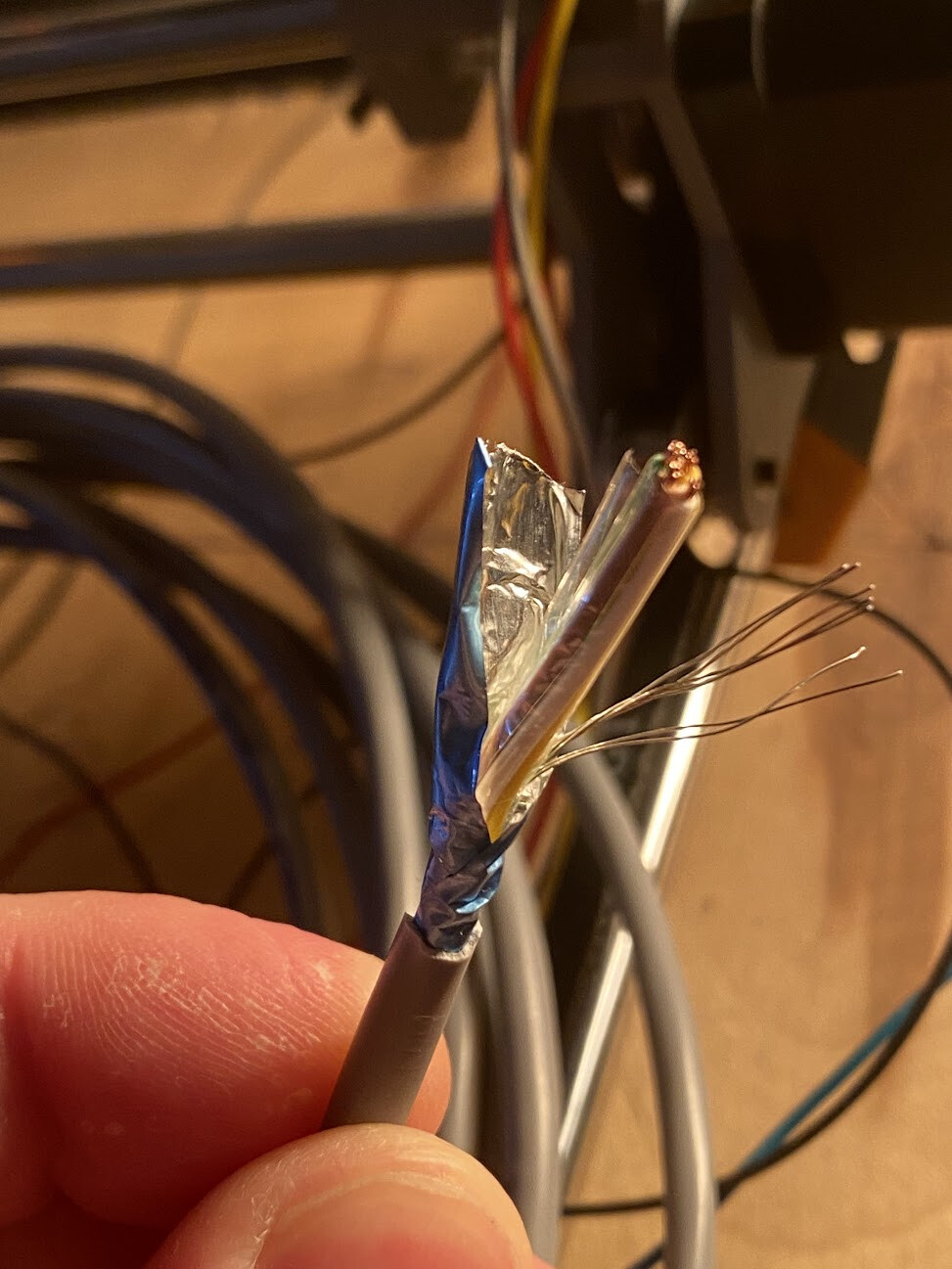

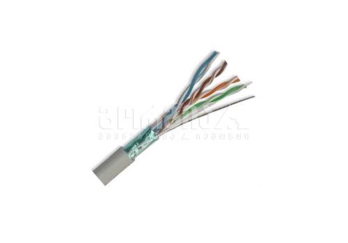

I found this 4 wire cable in my house.
Is that shield around ?
Yes, that’s a shield. Note that the shield should be connected to ground only on one end, by the controller where you should have a single point to which all grounds are connected. Don’t use the shield as a return path for a switch, either.

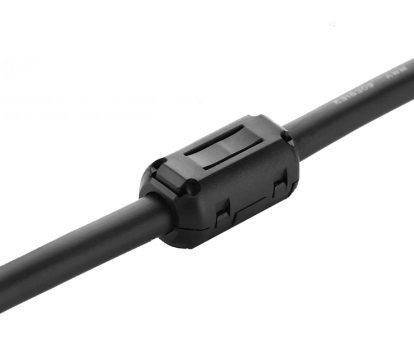

What kind of filters ?
Like this??
