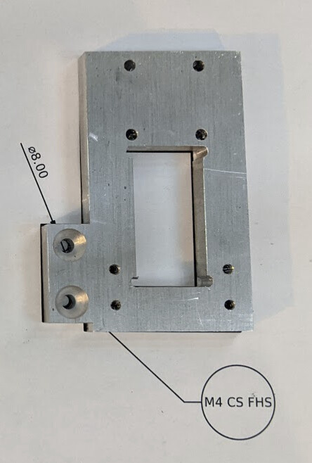

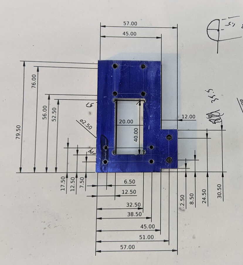

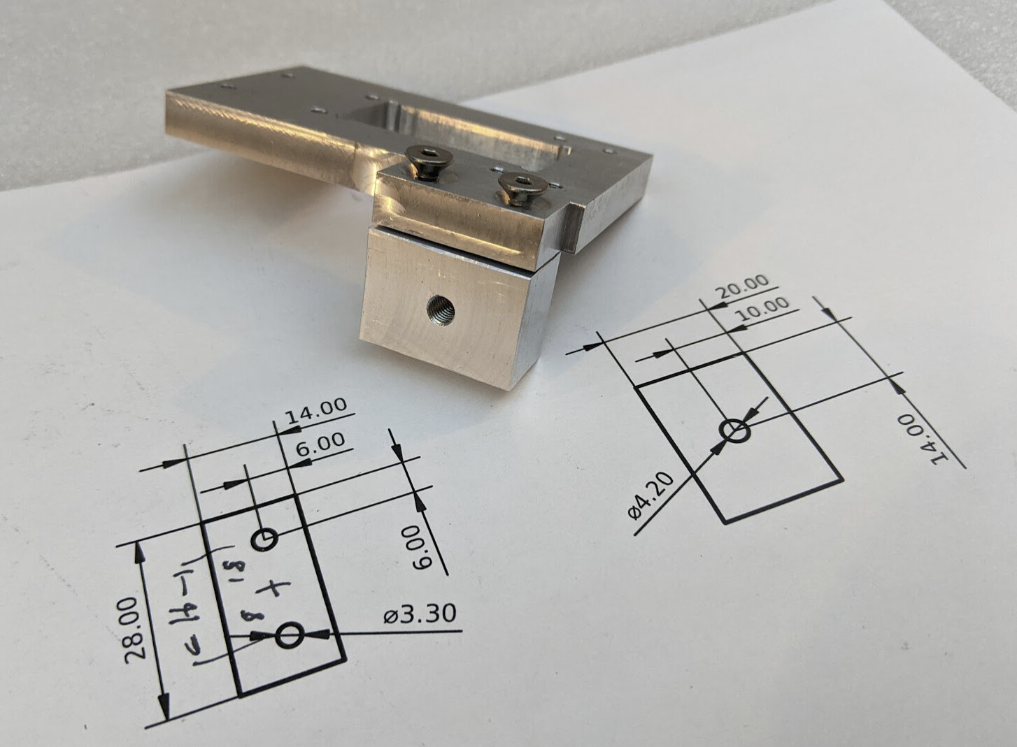

It was tricky to tension the belt with the printed version. For the aluminum version I designed the idler block as a separate piece that is screwed to the gantry plate. I haven’t made the idler block yet, but my youngest and I spent a few quality hours together in the shop, and he did most of the saw and mill work to make this:

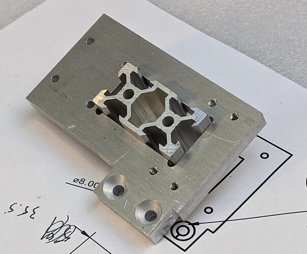

A piece of 2040 extrusion is a precise fit:
We finished the inside cutout with a 3mm endmill and made I-beam dogbones to stay clear of the 3.2mm holes on 20mm centers for mounting to the MGN12-H carriages.

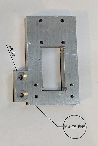

Idler block finished and attached:
Out with the old,
In with the new!
I think I should change the design to use the separate idler block when printing as well as when machining.
