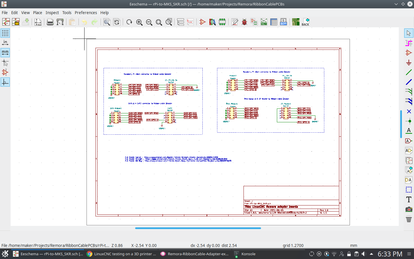

I made some PCB cable adapter boards in KiCAD for both the MKS Sbase v1.3 board and the SKR v1.4/v1.4 turbo boards.
I uploaded and ordered boards today so not yet validated. “should” be ok since I made them to mimic the boards I made for the SKR board using perf-board and connectors listed in this schematic.
https://dirtypcbs.com/store/designer/details/13122/6524/remora-mks-skr-adapters-zip

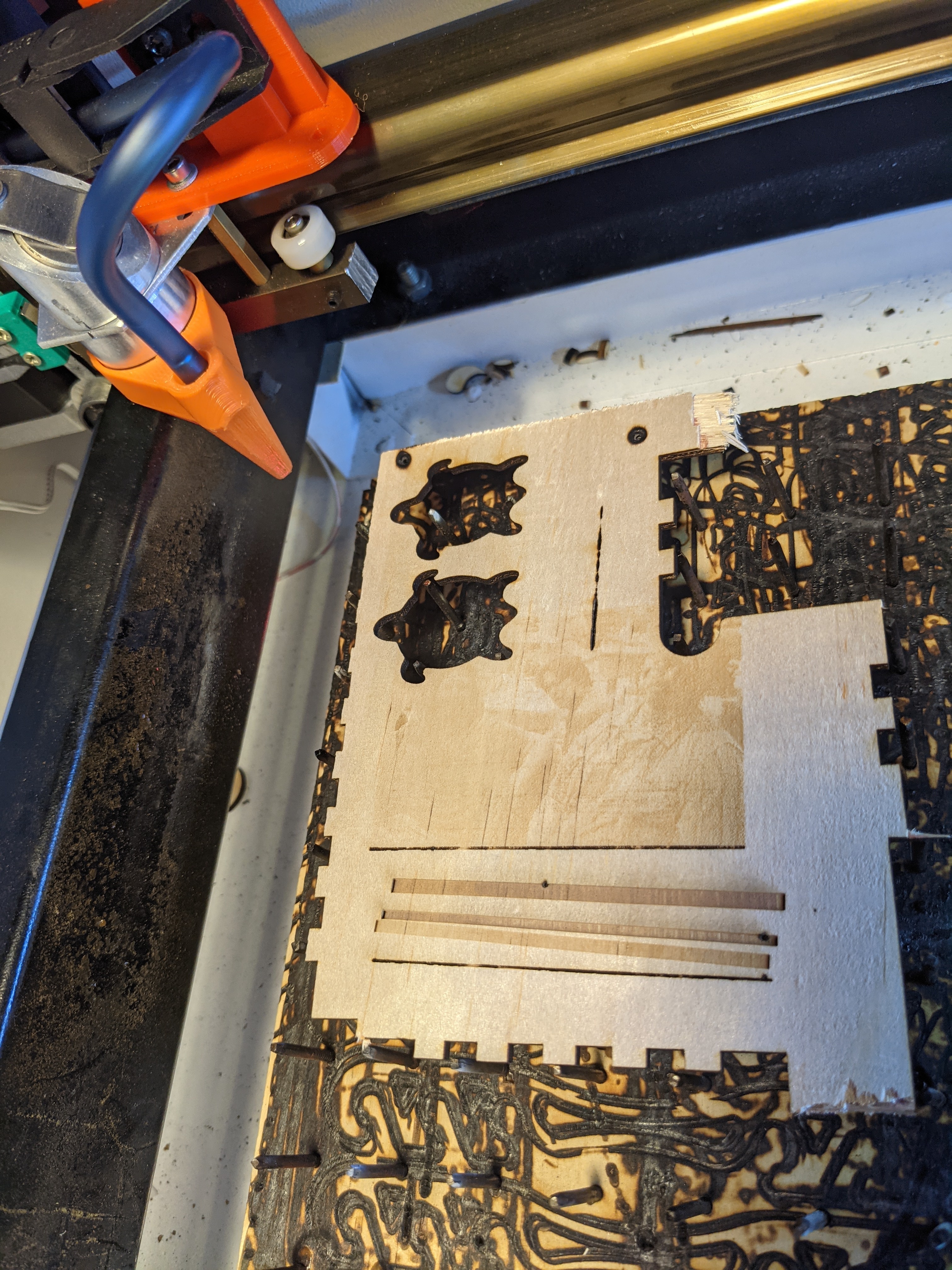

It’s WORKING! I was having problems with LinuxCNC parsing so many small moves( at 254DPI each move is 0.1mm ) and did lots of tests at 25% power, 15% and 5%. When there was parsing problems even 5% power was burning deep black lines instead of surface etching.
It may not look like much but it’s at 5KHz PWM, 5% power setting, 200mm/s dithering of a 75mm x 50mm image but it works. I can see Walter and Donny, can you?
Here is the original image:
lebowskibowling
I thought I was being fancy by using both the synchronous M67 command and the asynchronous M68 command. Turns out, putting the M67 command on the same line as the movement was the magic which resulted in the motion speed needed to allow there to be variation in power levels which can present variations in image perception.
I’ll do some tests changing the PWM frequency and then see how this handles grayscale.

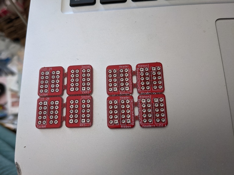

I created some GLCD ribbon cable adapters for the SPI connection with either the MKS or the SKR boards and the rPi. I’ve validated they work on both of these boards.
Remora MKS and SKR ribbon cable Adapters PCBs
Here are some pics of the boards, boards with 2x5 socket and 2x5 header pins and installed on a MKS board.
PXL_20210708_215835664.PORTRAIT

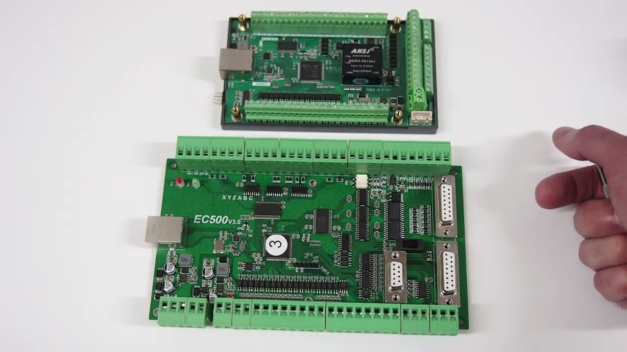

It’s been a while since I checked on what ScottA was doing with Remora and he’s still quite busy updating things. And while his documentation(Welcome to Remora’s documentation — Remora documentation 0.0.1 documentation) doesn’t show it, I found he’s posted videos on flashing the EC500 CNC controller with Remora and flashing the NVEM controller with Remora. The EC500 3-axis controller will then be 6 axis capable.
and
