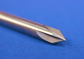

I wonder if this sort of 4 flute counter sink bit could have the flutes filed to more blade like edges for punching straight down?
SNAG-0008
Bits usually are hardened steel and a file will skate right over them. But a an abrasive wheel on a rotary tool (dremel) might work!
A high speed steel tool blank and a bit of time with a bench grinder could do the trick.
Blanks are available in a variety of sizes but here’s the first result on Amazon as an example: Amazon.com
Even a cheap-o bench grinder like this Wen would work: Amazon.com
This isn’t as convenient as an off-the-shelf blade but at the end you’d have a bench grinder and a new skill!
