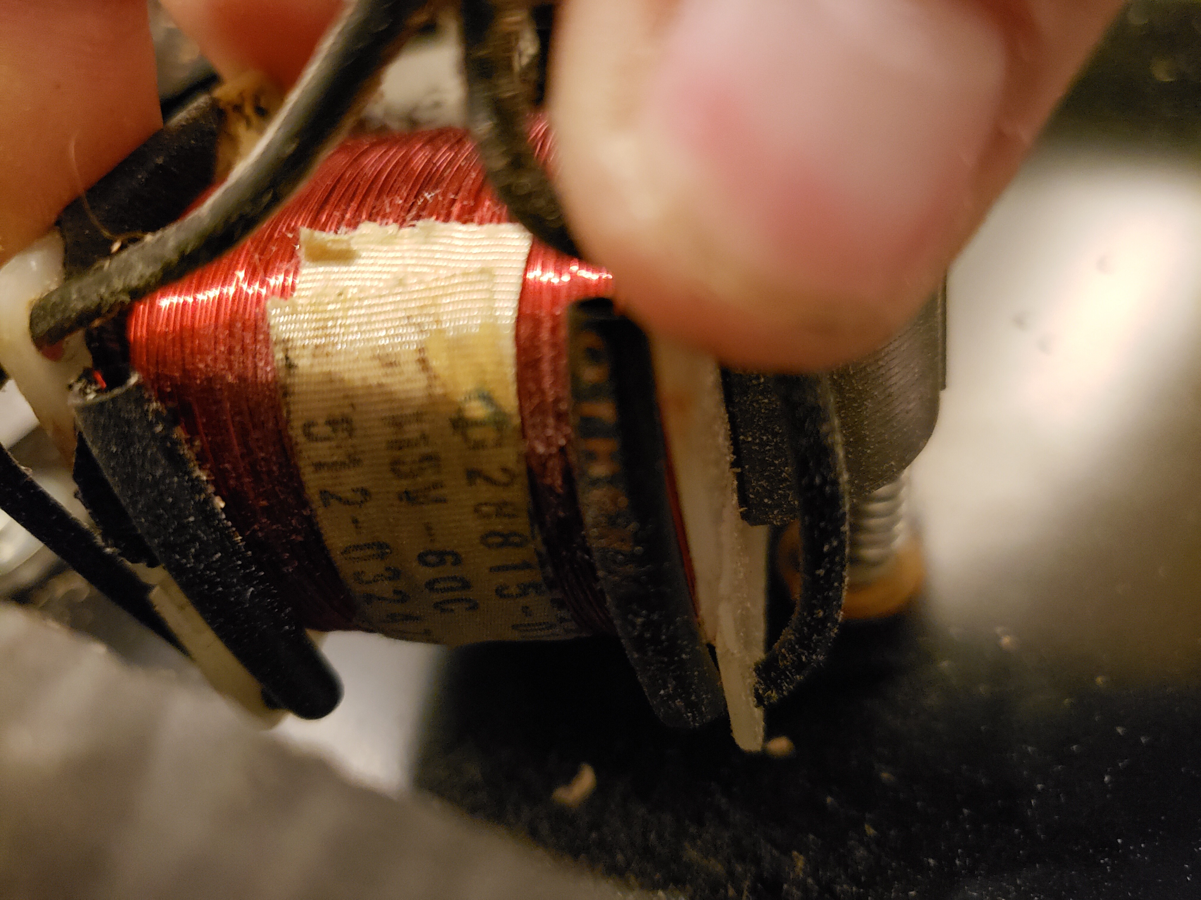

Does the AC motor currently installed have a “data plate”? If so, can you post a picture?
There are definitely motors that can do the trick, but we don’t know how much work the trick is. :relaxed:

Hey, yes, I wanted to post pictures with my original post, but I had a fussing baby to attend to.
On second inspection, I think the reduction is probably a lot more than 20x, but I don’t have time to check it at the moment. There’s a piece of tape on the motor that says 115v, 60 cycle, and two part numbers.
The 512 number is an internal model number for Baldwin. I will Google it.
The second number is possibly a date code or something. I don’t think they give much information.
