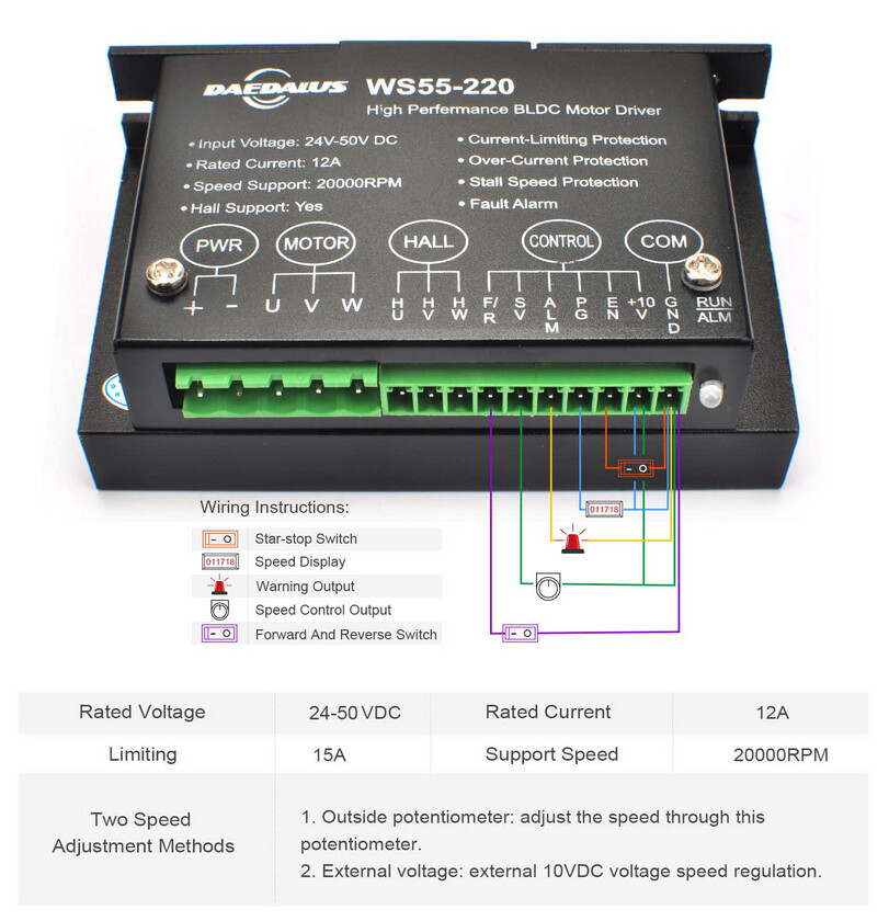

A DC motor needs to be commutated somehow… A brushless DC motor is basically a three-phase motor with a built-in VFD. Most of the brushless spindles I’ve seen are explicitly a three-phase spindle with a separate VFD controller.
For example, take a look at this example package on Amazon (not a purchase recommendation, just a reference):
https://www.amazon.com/Daedalus-CNC-Brushless-Motor-Kit/dp/B08RWDXB5W
Look at the connections here:
The motor connections are three phases labelled U, V, and W. It has position sensing with hall effect sensors labelled HU, YV, and HW that it uses to control the electronic commutation between the phases.
On this kit, 10V on the 0-10V connection is 20,000 RPM, but the spindle is a 12,000 RPM unit, so I believe you would actually need to limit to 0-6V range (or, probably, 0-60% duty cycle PWM) on the SV control input.
