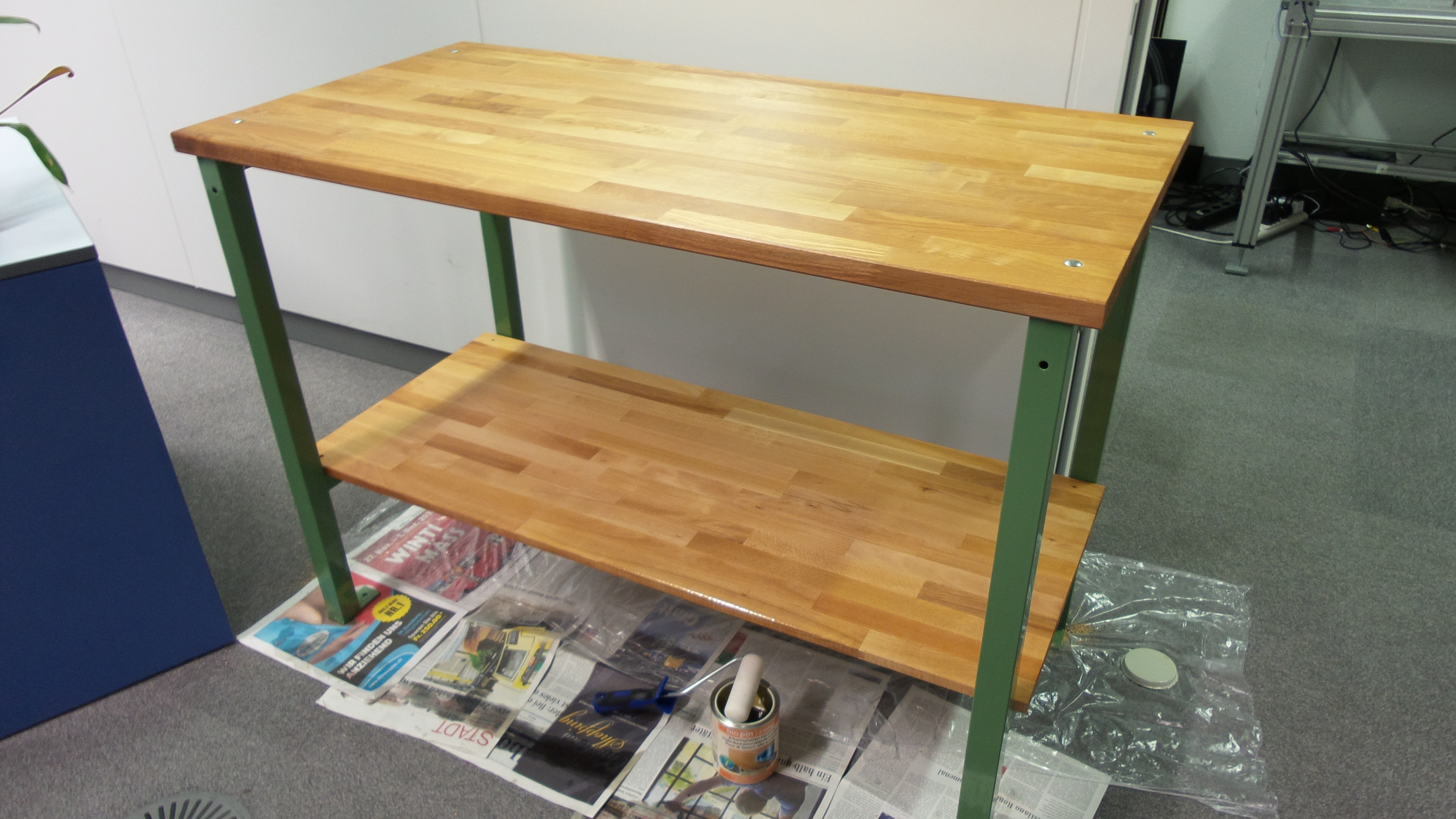

I made my workbench with a beech kitchen workplate, that I soaked with special linseed oil, which makes it harder and dust resistant. I got that plate for about 70$ in a hardware store.
