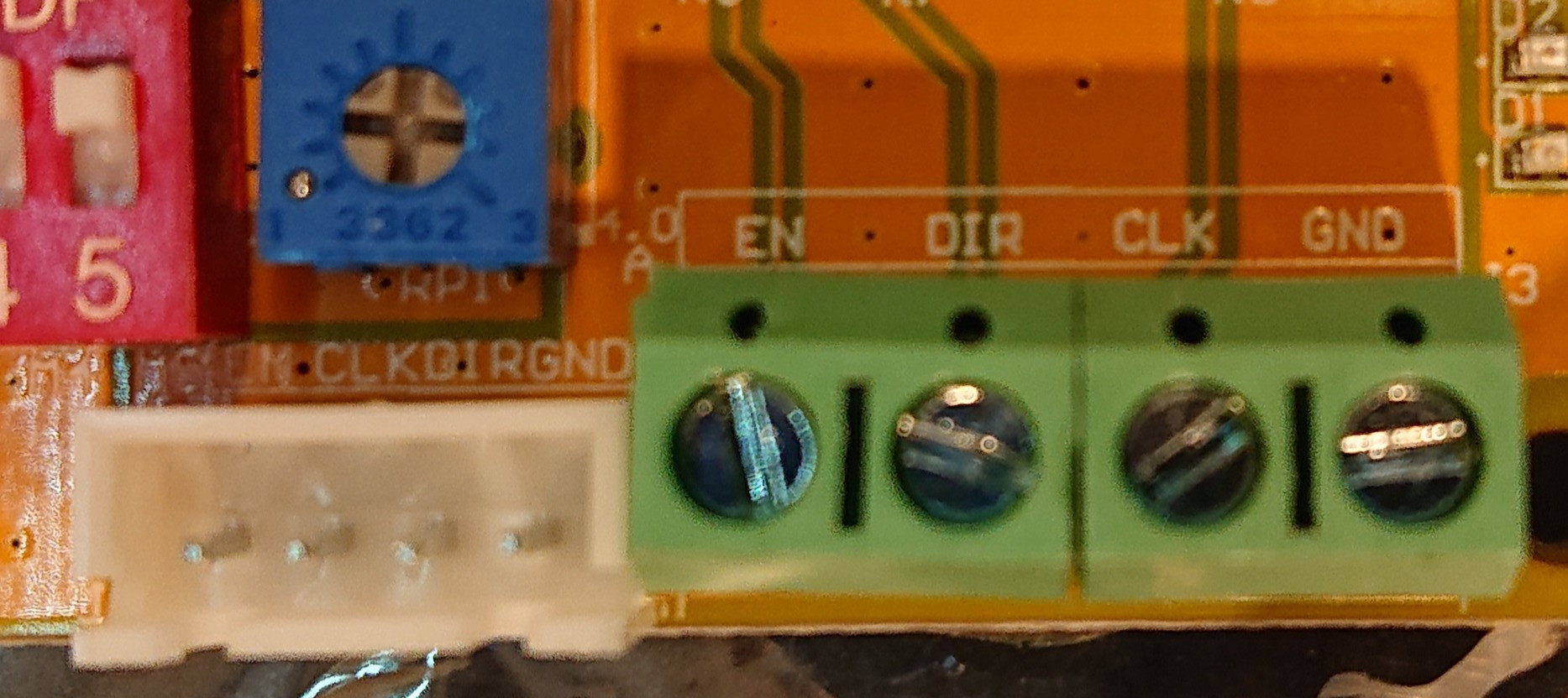

Note that the two control connections are different. One is EN CLK DIR GND and the other is EN DIR CLK GND — it’s not a silkscreen error, I confirmed with multimeter.

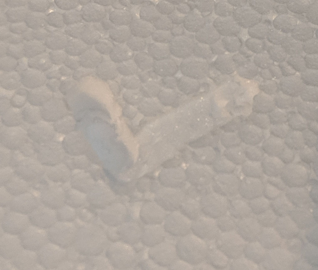

Even with $1=255 set, axes are doing uncommanded moves. I got a hole from drilling (only Z movement, X and Y stayed at 0) that looks like this:
That’s not a round hole. And I felt the Y steppers actually stepping while it was drilling, with this gcode:

It worked better with $1=10 than with $1=3; the hole I drilled looked like a hole instead of a backward L. But the Y axis was still hunting slightly during drilling, the circles were still offset, and there was still some step-over on the outside contour cut.

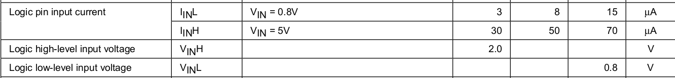

Data sheet indicates 3.3V should be fine:
But I don’t know whether there are optoisolators under the heat sink that I’m really driving. If so, then the classic MOSFET-based bidirectional logic level shifter might not source enough current, and I should instead use active level shifters to switch my 5V source. I ordered both TXS0108E and TXB0104 devices to try for this purpose, since I’m sure I’ll need more as I do more work with ESP32s and having some of them immediately available is likely to come in handy.

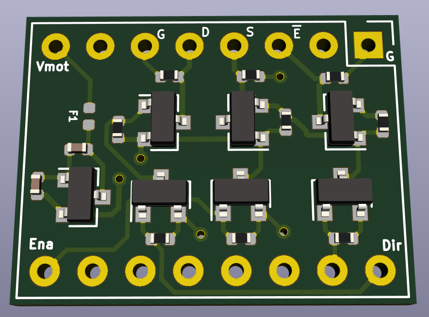

Untested design for an adapter that sits in a normal stepstick 16-pin port and converts the four output pins intended to be A1/A2/B1/B2 to 5V high-current GND/STEP/DIR/~EN pins.
I uploaded it to circuithub just to see what their instant quote interface looks like, but that would be $300 for one sent out in about three weeks, so that’s not the route I’ll take! :relaxed:

I did an updated version that doesn’t invert the signals last night.
Can you post a picture of your board? It’s very hard to imagine for people that can’t read gerber files (like me) :wink:
It exists only in the computer…
I haven’t even tried breadboarding it to make sure that I didn’t do something stupid in the circuit. I used 0402 passives because I wasn’t sure what would fit; the render made it clear that I could move to larger passives that are easier to do at home without a microscope. But I ran out of time right now to do any more work on it in the short term.
