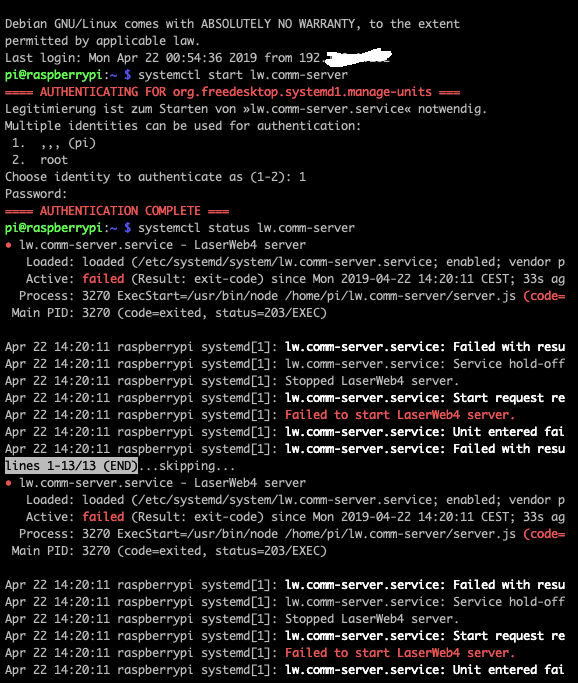

Hi everybody,
i installed laserweb 4 on a Raspberrypi according to this manual https://github.com/…/lw.co…/wiki/Manual-Installation-(RasPi)
so far so good…
but now when i start the LW-server it seems to work. but when i try you check if it works using the following command “systemctl status lw.comm-server”
i get the following response.
has anybody an idea what i did wrong?

The actual error messages are cut off.
You could systemctl status lw.comm-server | cat so that it doesn’t trim off the errors.

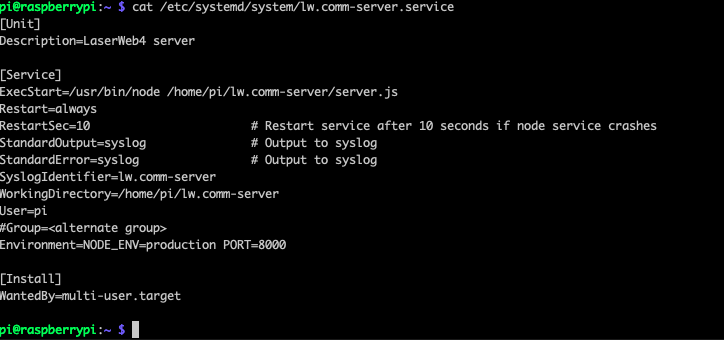

Ok, then the problem seems to be at the linux service script (or user rights). There are some pathes in the service script that probably need to be adjusted to your system. Check the script lw.comm-server.service at /etc/systemd/system/.
Unfortunately I am not a linux pro.

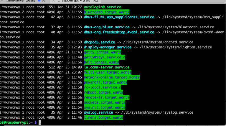

The directory /etc/systemd/system should contain a file lw.comm-server.service
ls -l /etc/systemd/system/lw.comm-server.service
cat /etc/systemd/system/lw.comm-server.service

its there…but what about the permissions ?
mcdanlj
(Michael K Johnson)
April 23, 2019, 10:10pm
11
The permissions are fine such as they are. It’s not a big file, just 512 bytes. The second command I provided will show the contents of the file.
