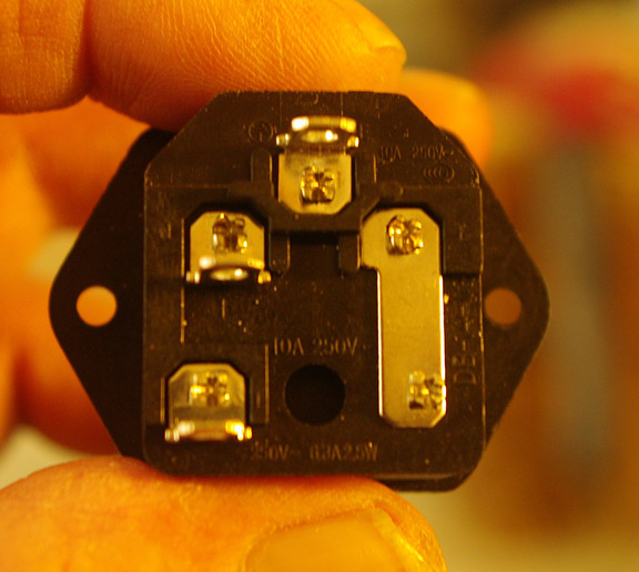

also I could not get the fuse out so I unhooked the wires…marked them with felt pen on tape…but marks came off I know which wire goes on top but now am concerned that I will get the two on the left side wrong…another senior moment
Ah! Makes sense

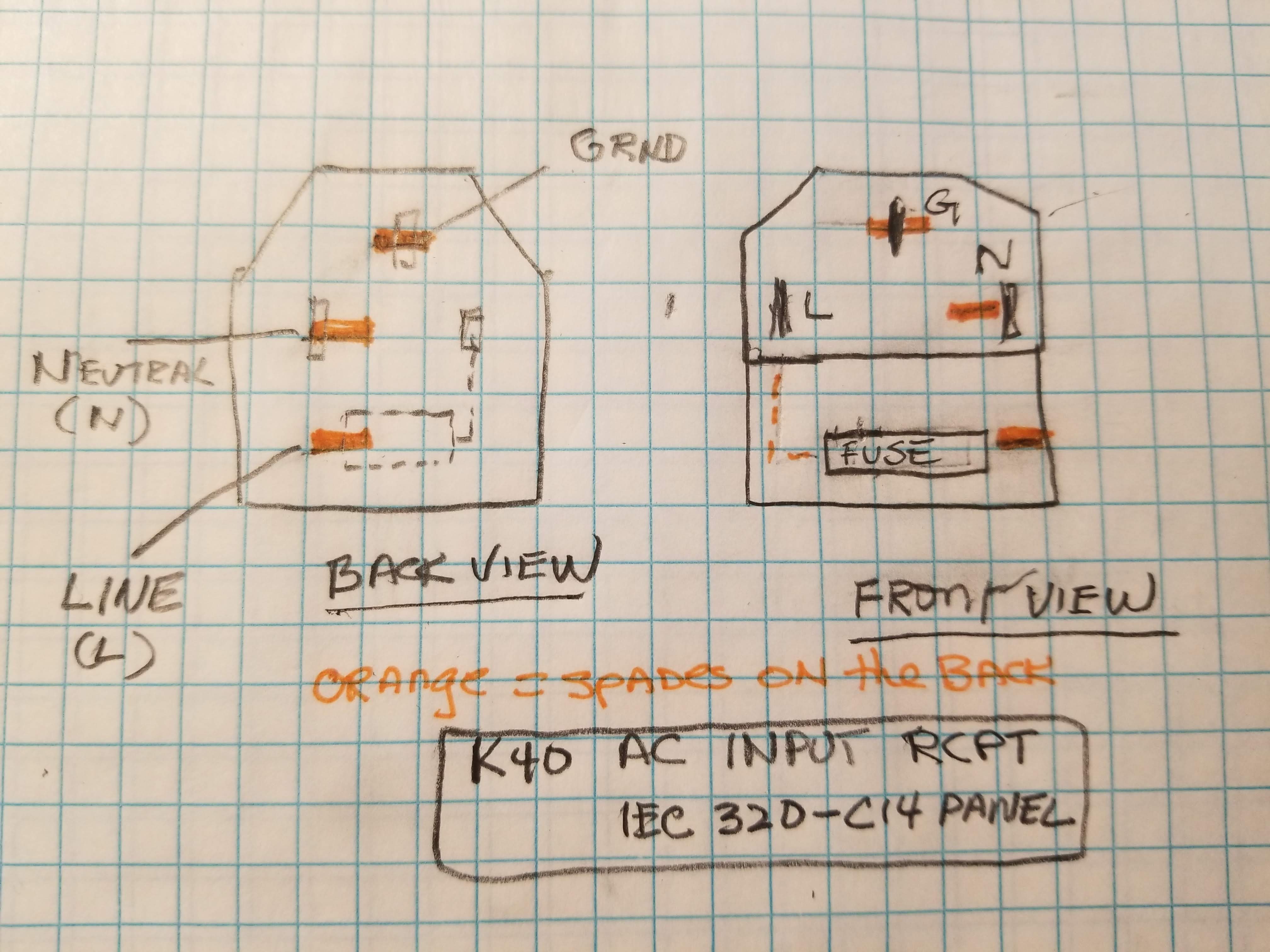

Below is a sketch I made showing the back and front of that socket.
I do not know what the wire colors on your machine are but typically:
G (Ground) = green
L (Line) = black
N (Neutral) = white
Note: if your wire colors are different let us know, with pictures!
1. Did you manage to get the fuse out and check it??
If you cannot get the fuse out by hand you can try to thread a string in and around the fuse and pull it out.
Sometimes a needle nose pliers will also work.

Ahh, thanks for that. I was wondering how that plug was wired internally.
Thank you Don. The fuse looks ok. Both wires on the left side are blue on my unit. The seller stated that these can be connected arbitrarily and to check the power supply again.
