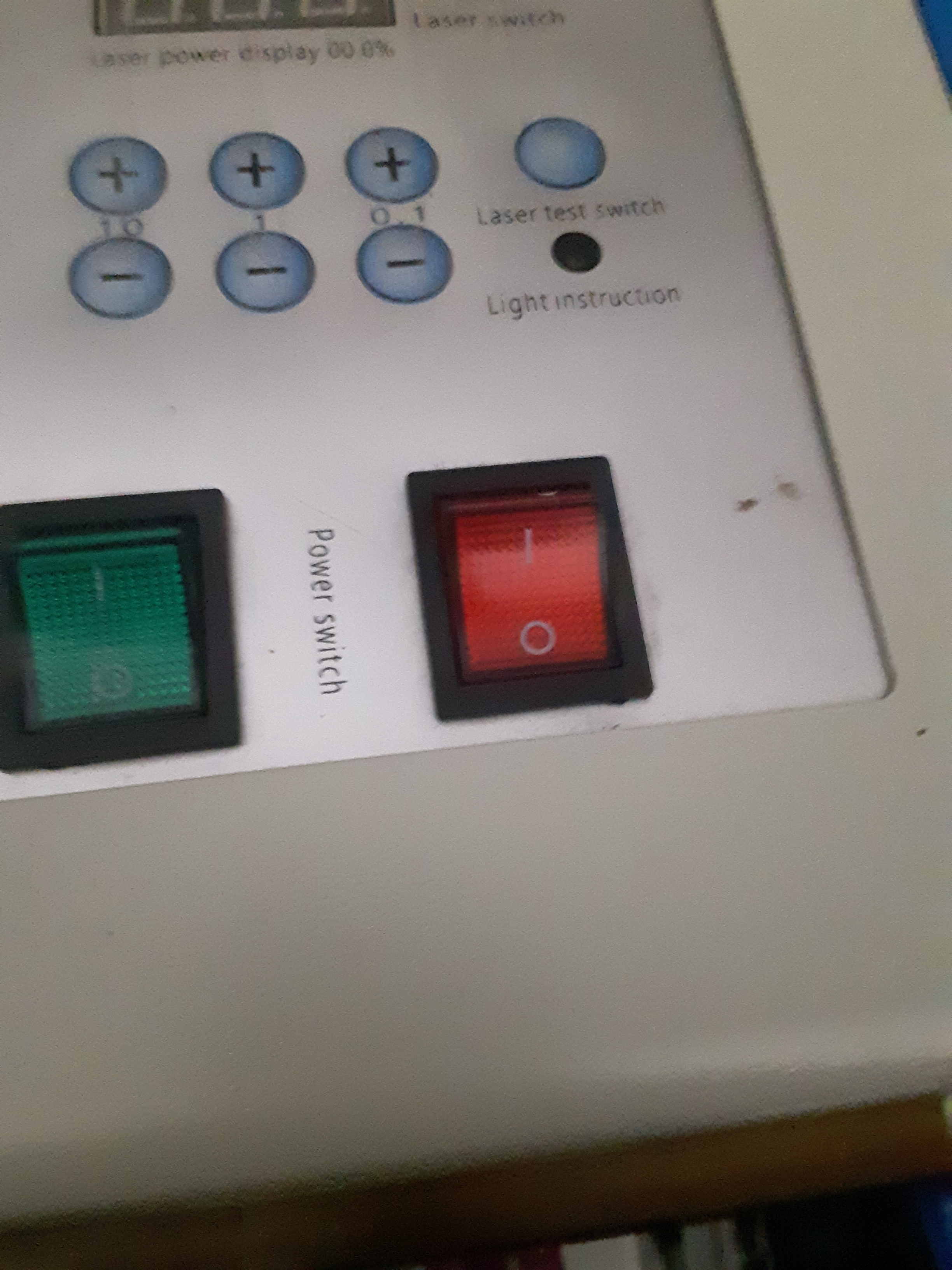

So, putting the multimeter to the red power switch gets a readout of 1 when the switch is off and bounces around when it’s in the on position. Trying the same thing on the machine switch and estop next to it does not change whether on or off.
Also tried different power outlet and still no response. Should I try a different multimeter setting for the machine switch and the estop? I tested the screws holding the leads onto the switchest. Should I be doing it a different way?
How do I best go about testing the socket on the back of the machine?

We can try and walk you through the troubleshooting but we need to be methodical and get as much visual information as possible from you.

Send a picture of the entire control panel just to insure we have the switch layout to reference.
