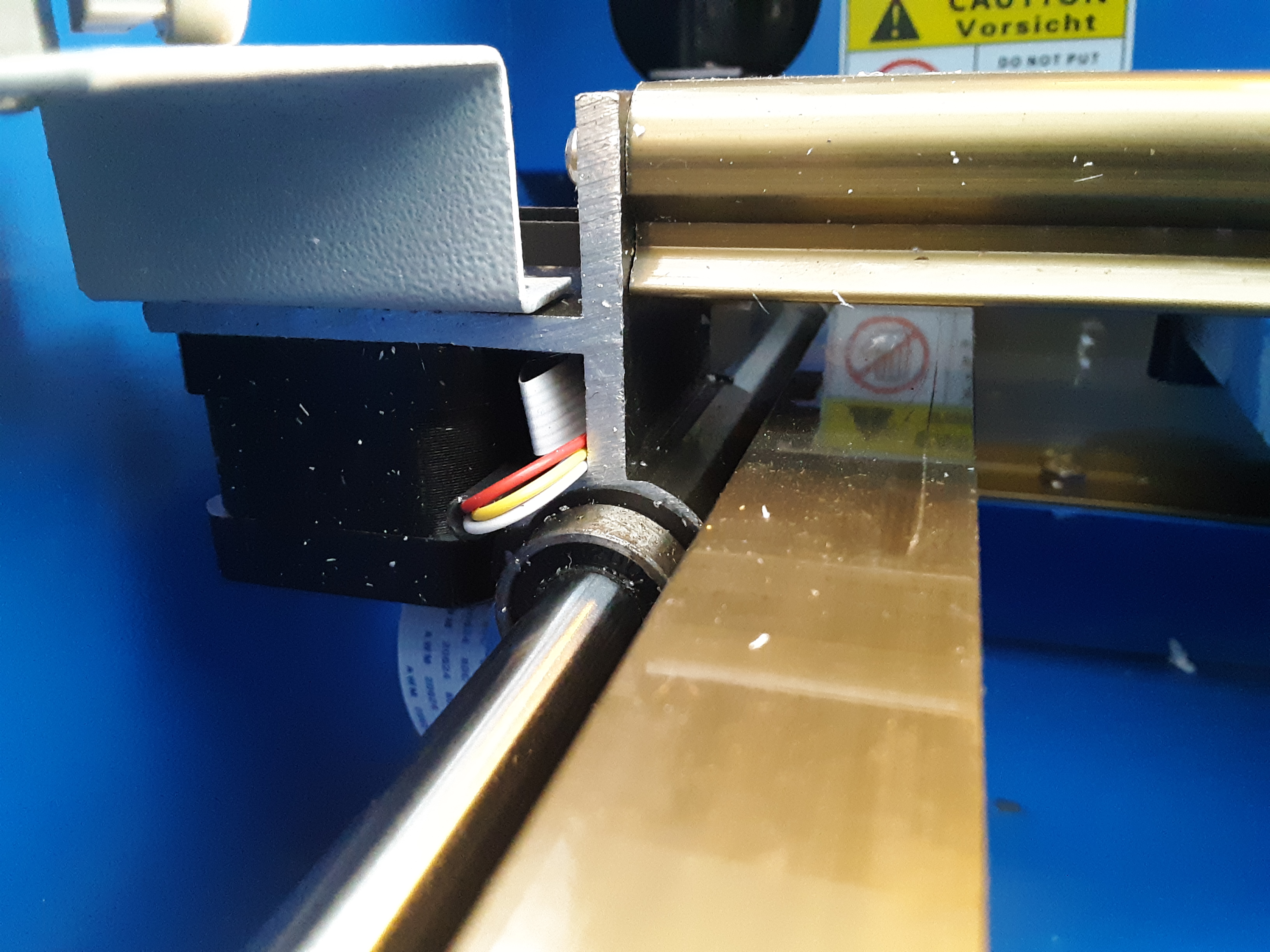

K40s typically come with optical limit switches. For the x-axis there will be an optical pair of an emitter and a receiver under the left side of the arm. The head has a metal tab that sides in between to block the optical beam at the limit. With suspected rough shipping I would check the alignment of the components. I’ve seen it before where something was bent during shipping.
Going to look into all of this, but my priority is to get it to power on, first. It initially didn’t want to work, then it randomly decided to power on and do what was in the 1st video. But after about 15 minutes, it decided to no longer turn on. I couldn’t leave it on while trying to figure things out because when it got power, it automatically did what you see in the video and ONLY that. So leaving it on would’ve kept it grinding the x axis and likely caused damage. In throwing in a couple of pictures to show what’s on the left end of the x axis part of the gantry. I intend on focusing on the power issue first, though. Thanks for the help so far!

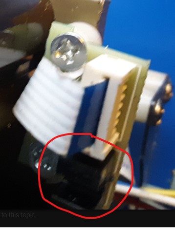

Here is the optical switch. I haven’t seen that arrangement before as mine is mounted under the arm and not on the side. Is there a tab on the head carriage that slides into the switch?
Annotation%202019-07-25%20131200
Yes, there is a tab that goes into that piece. Upon inspecting things further, I found that the head was actually partially off-track. Just slipped the wheels back into place so the head moves correctly and that tab slips perfectly into the slot on the piece circled. So that should fix the x axis issue… now to deal with the core issue of lack of power. Not sure where to begin and the seller I bought it from hasn’t been the most helpful while expressing they are willing to be as helpful as possible… But I digress. How do I figure out the power issue?
