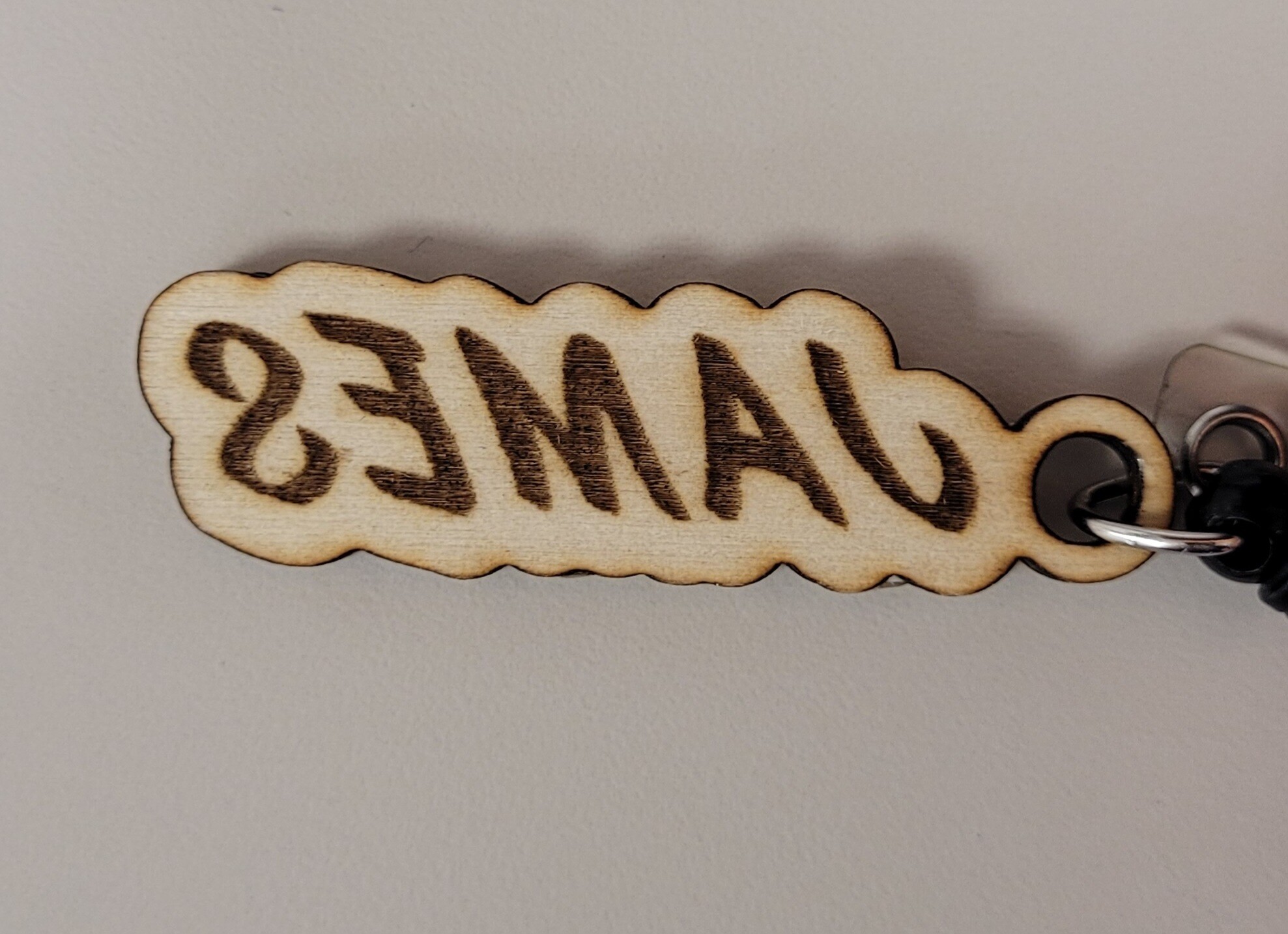

I had to reverse my pin but now my laser is engraving in mirror form. Everything comes out reversed.
Do you mean reversed side-to-side, or engraving where it shouldn’t and not engraving where it should?
Check the machines origin setting in the software…
I understand the problem, I believe. Did you check where the origin of the machine is set?
The motor coil convention is not the same between drivers, and if you are using different stepper drivers than before it’s easy for them to go backwards from what you expect.
If you reverse one of the two coil pairs for a motor, it will reverse the motion of that motor.
