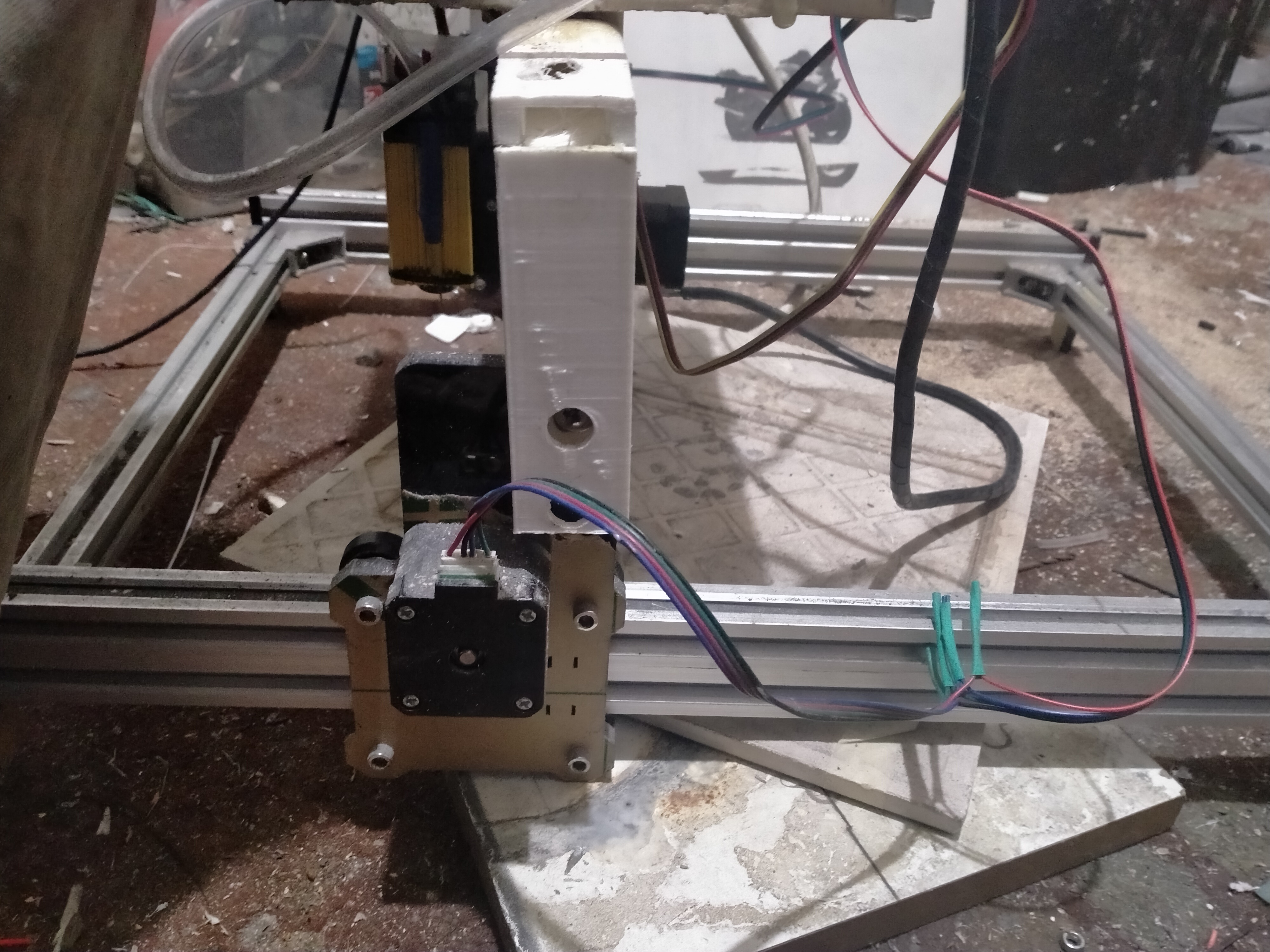

I just 3D printed rectangular box sections, and assembled a basic structure from them using the existing bolts to secure the sides. Below you can see one side (I later ran the stepper cable up the hollow plastic section). It is very crude - a quick and nasty fix - because it is only temporary, until I get an enclosure built.
