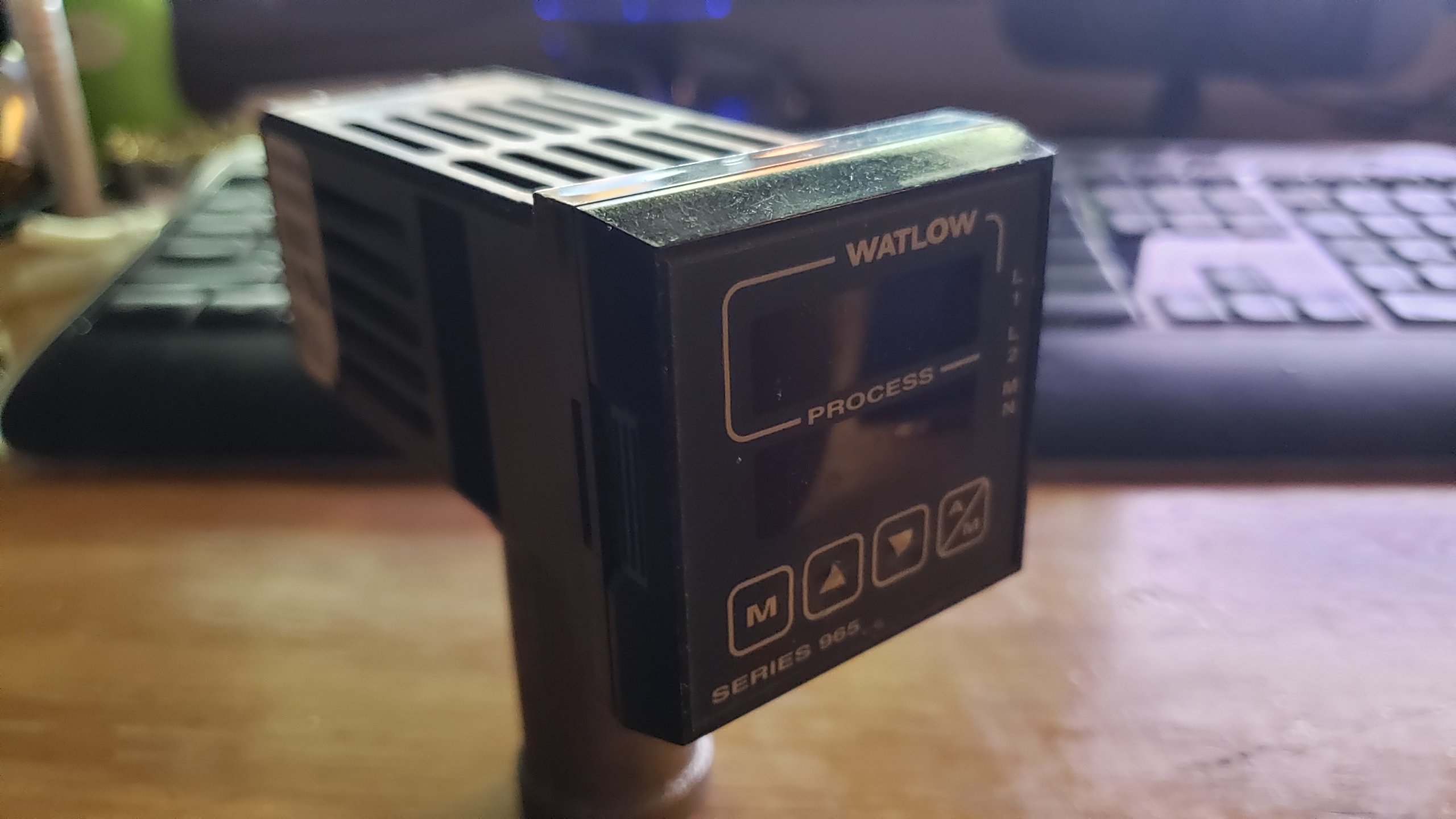

I’m now sifting through my parts bins for controls and other pieces I will need to transform this into a functioning water chiller for my K40 laser. So far I have scrounged up a Watlow temperature controller.
