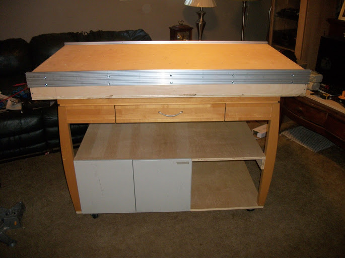

This shows what I am using:
Planned on leveling this surface but to date have not had to do so for the kind of work that I do.

I use a plywood torsion box on my OX. I actually have the rails attached to the sides of the box so I did not need any cross pieces.
The top is not exactly a torsion box but it is reinforced and have had no problems.
