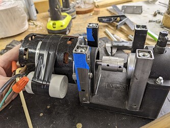

The final motor/cutter configuration. The first version had a flexible coupler to account for motor misalignment. When the cutting head jammed it destroyed the coupler so I made a solid one and got the motor closely aligned on center.

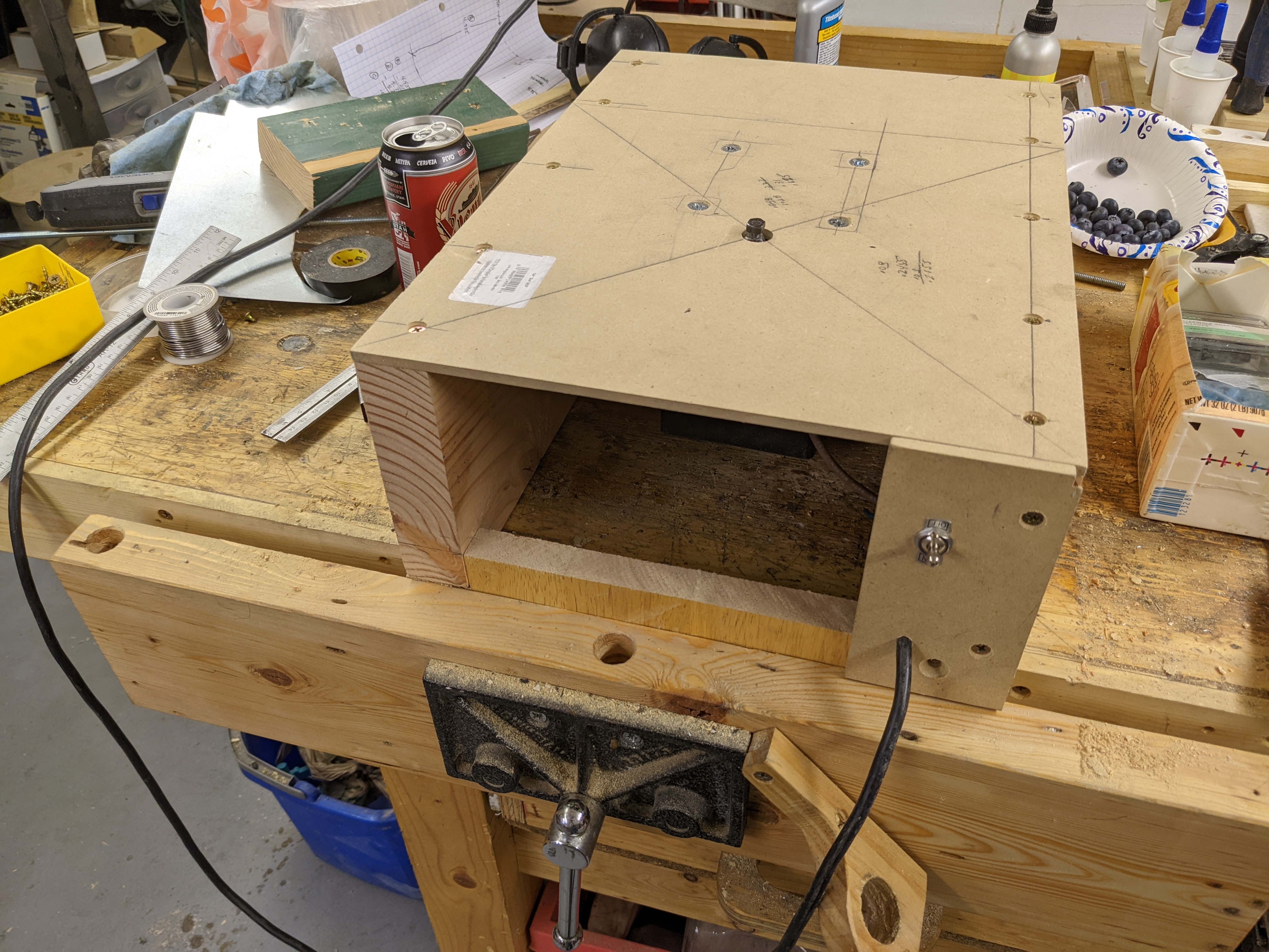

The benchtop nibbler. It is held in place with the bench vise.

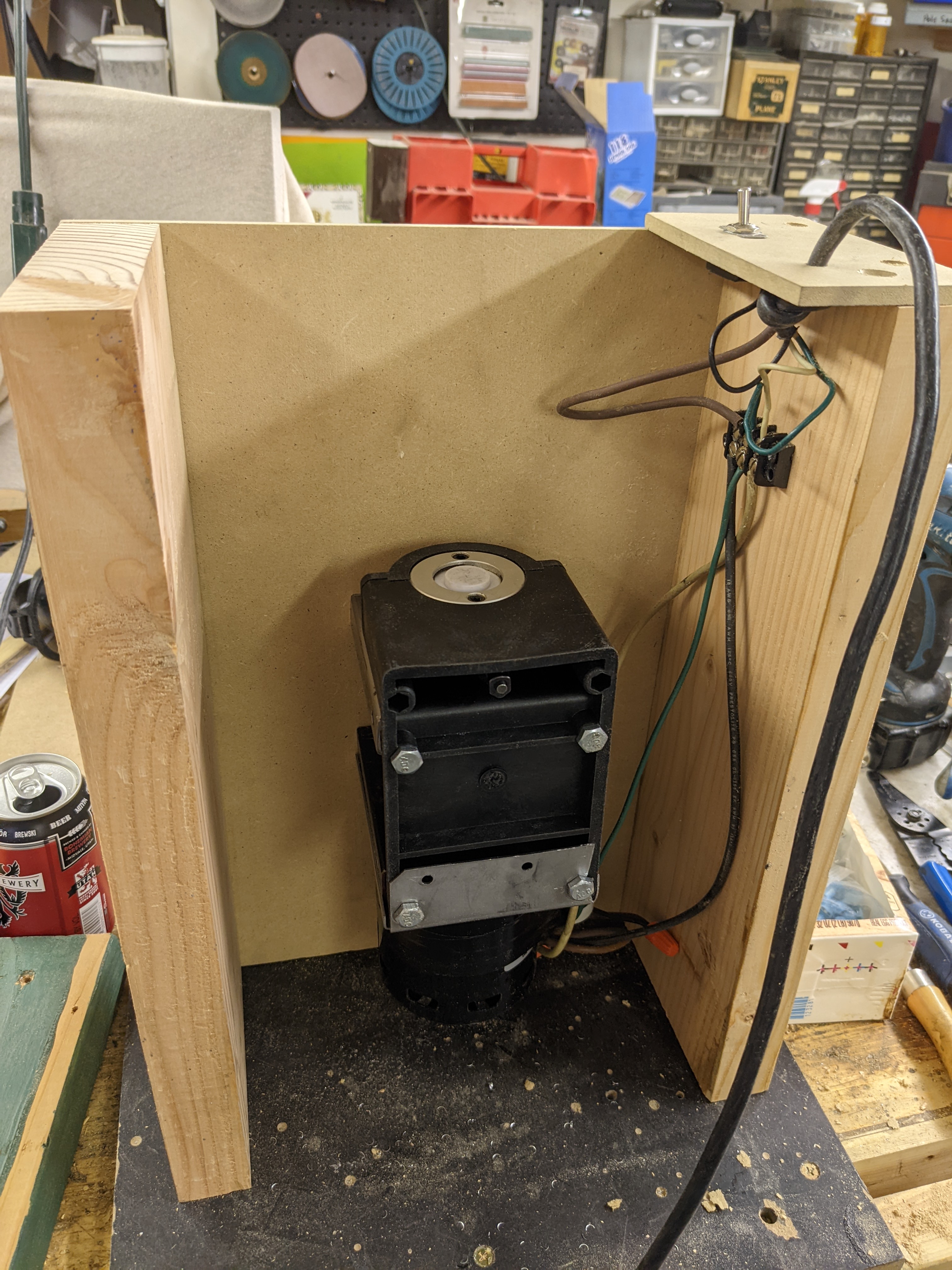

The cutter/motor assy mounting from below. It hangs from the deck. Getting the head at the right depth to the table required ultraprecision fabrication!

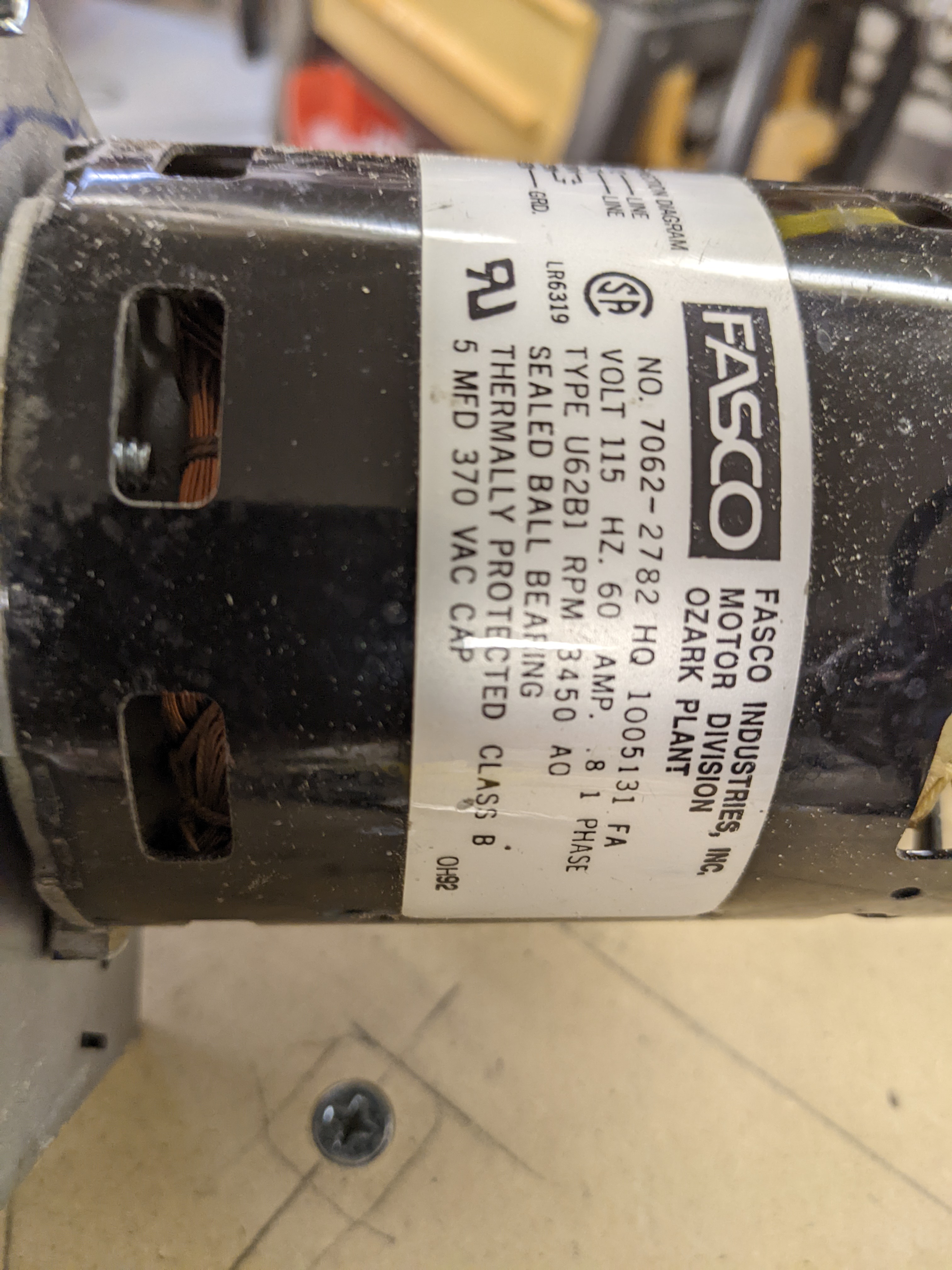

The motor, I wish it was slower but that is what I had in the bin. Maybe connect it to a speed control later.

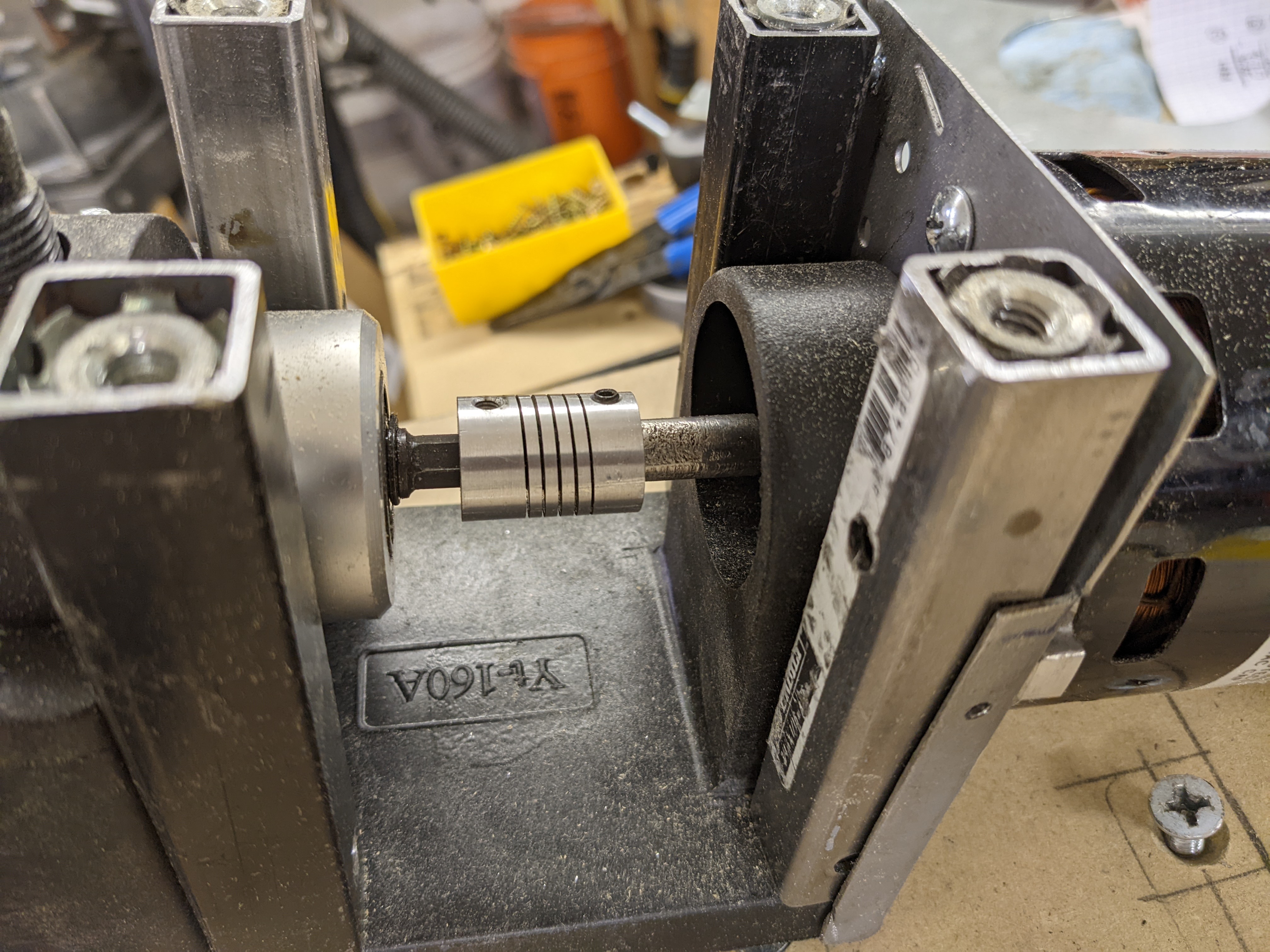

This coupler couldn’t take the jolt when the head jammed and self-destructed.
Made a solid coupler and redid the motor mounting so it was on center with the cutter. I may still find and add a stronger flexible coupler.

  • The motor does not need to be this fast. The nibbler produces significant vibration. The set screws in the coupler kept coming loose and it’s noisy. It does cut fast!!!

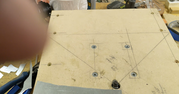

  • Getting the bottom of the cutter aligned with the top surface of the table was painstaking. I finally thickness sanded the entire tabletop until the bottom of the cutter was at the right depth.

  • A lower speed and stout flexible coupler would reduce vibration.
  • A variable speed would be nice.
