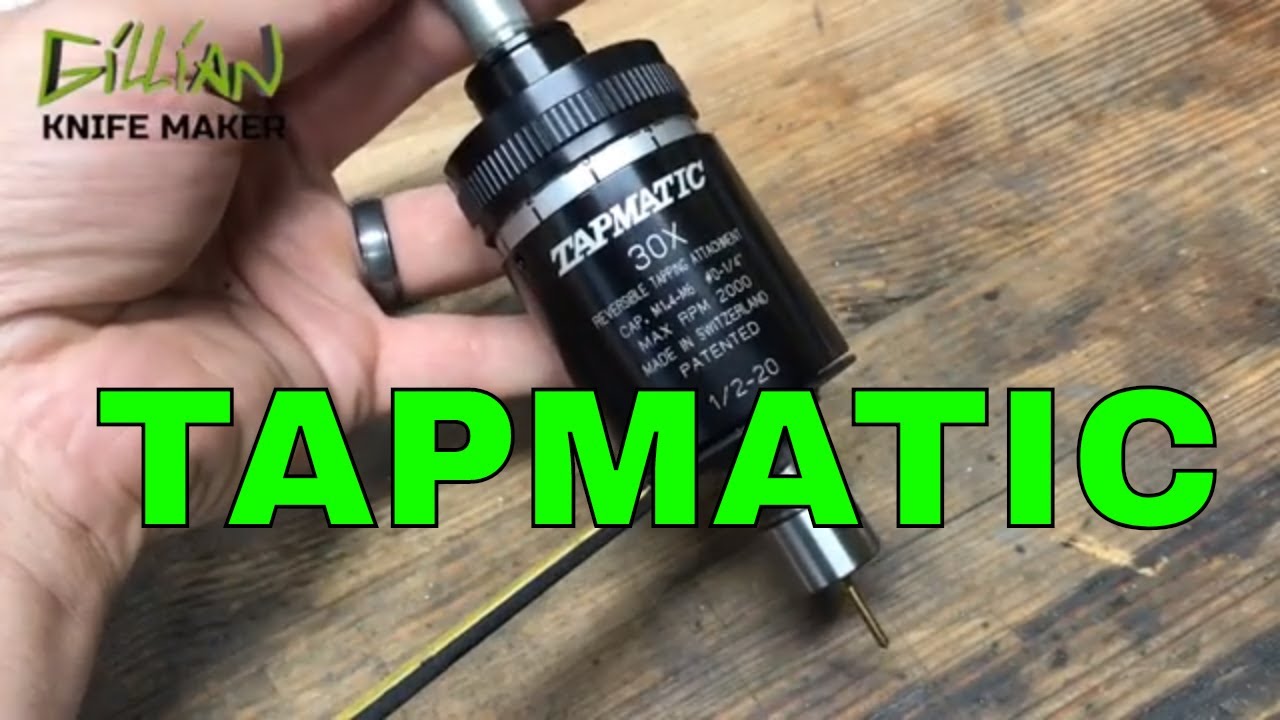

Have you guys seen the auto-reversing tapping head for drill presses?
They get all kids of great reviews but are usually $200 to $400 and I was thinking of ways to make one. That got me thinking of how often I see people using drill motors to do manually but fear that the movement of switching to reverse would/could break the tap. So I was thinking of modifying an old 15V drill with an external button for reversing direction.

I’ve never heard of tapmatics changing direction breaking a tap. Is this commonly a problem?
Love these things. After WWII, the San Diego surplus lots had tons of these for about 10 bucks. We had two, one ended up with my brother and I have no idea where the other one went. Many times I’ve wished I’d kept track of the other one.
I went to buy one and the sticker shock got me then and now…
I was told that they were gear driven, no springs except to make the clutch work… I never did take one apart…

My Makita, Royobi and Craftsman cordless drills all have a push-thru button for Forward/Reverse and it takes a bit of force to push in from either side. Maybe those bits are tough and threads won’t get cut too poorly if the angle of the tap shifts. Surely not as smooth as the auto-reverse mechanism of those golden tapping heads.
I’ll be tapping some 2mm and 3mm aluminum to make some of the Russ Spec lightweight laser heads for the K40 so not lots of material to bite hence my thoughts on keeping that tap straight at all times. I will be using a metal tapping guide but probably just holding it in place with my left hand while my right does the drill motor tapping.
You know, I think part of the complexity of the tapmatic is that it allows for radial as well as axial float. You don’t need radial float for a freehand power tapping auto-reverse. The only need you have for axial float is to disengage the dog clutch to switch direction!
You don’t want to over-torque here anyway. It’s not impossible that you could make an auto-reversing mostly 3D-printed freehand tapping head with a body that clamps to your drill body somehow. It sounds like a fun design challenge.
But honestly, for tapping 2mm/3mm aluminum, a handheld tap guide and reversing the drill should be fine. I’d be surprised if you broke a tap; activating the direction button is probably less sideways force than just using a hand tap, and I’ve successfully hand-tapped M2.5 in ¼" aluminum with a straight flute tap. For 2mm/3mm aluminum, I’d hand-hold the metal down to the table while tapping and just let off pressure on the metal while engaging the reverse trigger on the drill.
