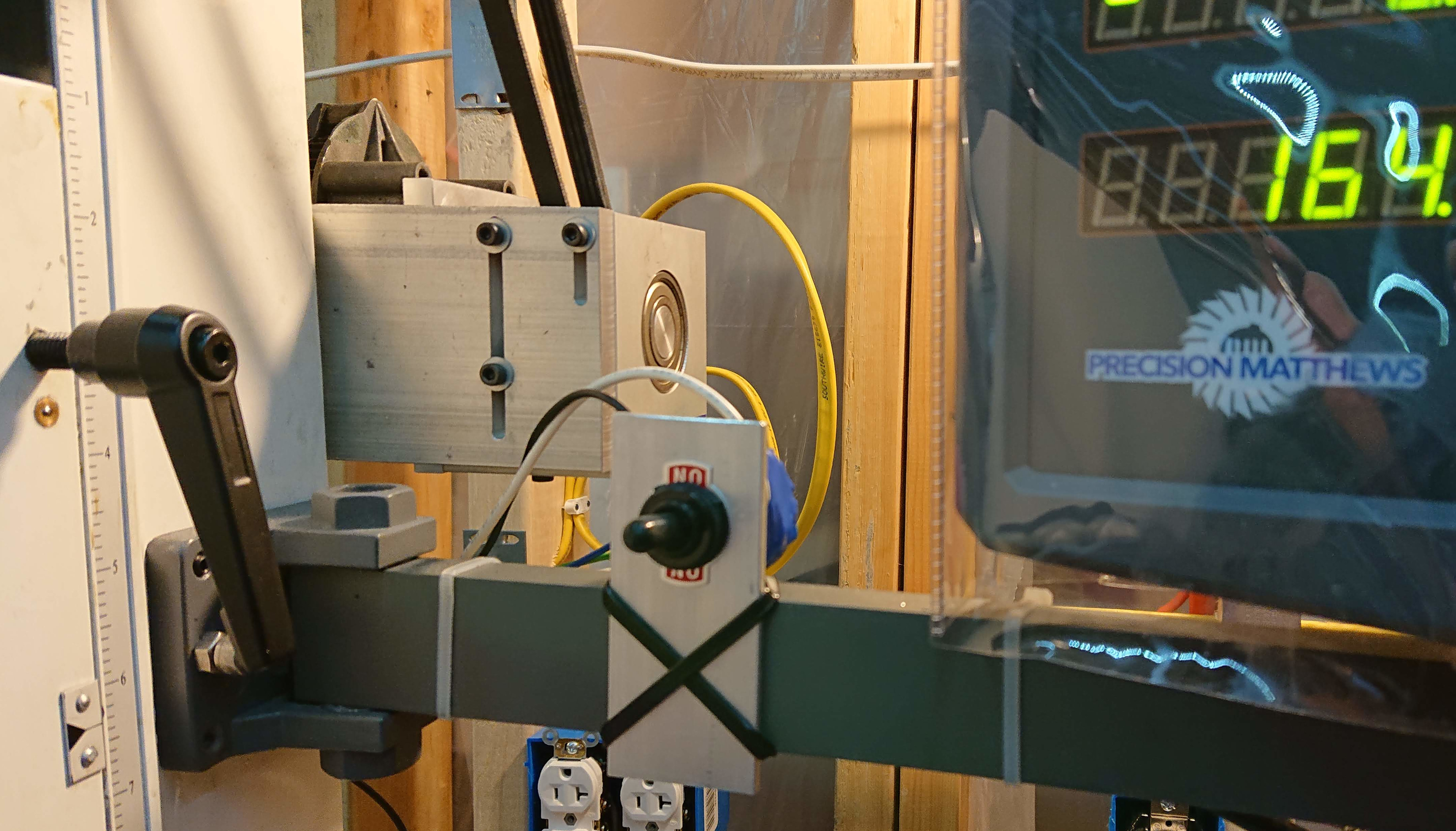

Tonight I went looking for a switch to complete my build.
I have a DPDT (on)off(on) momentary switch, which I can use to run the motor forward or backward. However, the brush trimmer — that sacrificed itself (in my hands, as I was using it) to make this project possible — had a nice feature that when it wasn’t supplying power to the motor, it shorted the motor to stop it more quickly.
I could do this and also be able to switch polarity so that I can run the head both up and down with a 3PDT or 4PDT (on)on(on) switch, but so far I’ve found exactly one of those with screw or spade terminals, and it’s $50. So I think I’ll hope that with the load of running the head the motor stops easily without being shorted! :slight_smile:
I had been thinking of mounting the switch in the hole that used to hold the wires for the safety shield that gets in the way of, you know, actually using the mill. (It’s very safe as long as you don’t turn it on or tip it over!) But there’s not enough room inside the head for the body of the switch; the hole is too low.
So now I’m trying to decide whether to 3d print a switch housing and fasten it to the electronics box, or drill a hole in the electronics box, or something else.
I prototyped a switch location:
It runs!

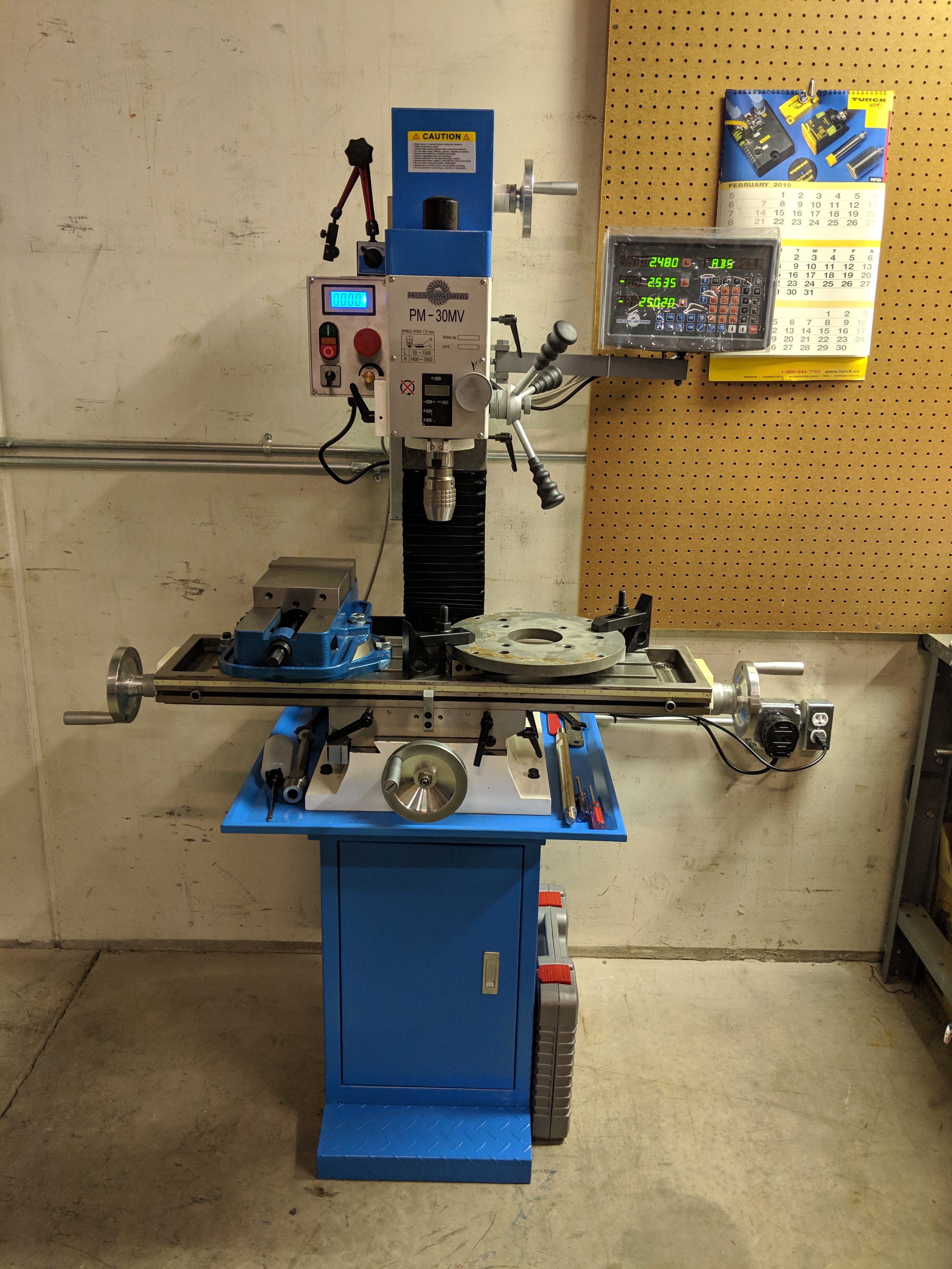

What size is that mill?
Still not big enough, but better than the mini-mill that I’m CNCing!
Max. Drilling Capacity 1-1/4″
Max. End Milling Capacity 3/4″
Max. Face Milling Capacity 3-1/2″
Table Size 8-1/4″ x 33″
Cross Travel (Y Axis) 8-3/4″
Longitudinal Travel (X Axis) 23″
Spindle Travel 3″
Net Weight (Not Including Base) 530 LBS
The Y travel is less than listed because of the DRO scales.
