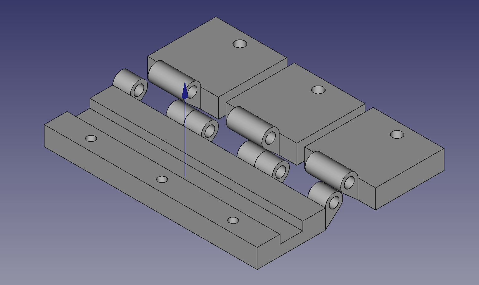

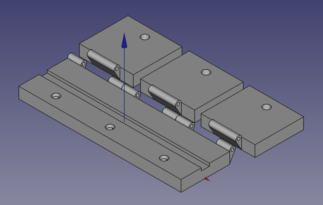

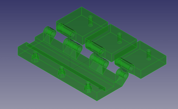

I have created a 3d-printable jig tool that allows you to make a well-aligned splice in many timing belts that preserves at least much of the strength. It is unlikely to be as precise as a commercially-prepared closed loop, but may be good enough for many uses. As long as the teeth are as wide or wider than the gaps between teeth in the belt profile, the spacing should be consistent.
It is possible to use this process without a jig, but alignment is harder to get perfect. My first attempt did not use a jig. I just held two pieces of belt together, and it was therefore out of alignment by about 0.5mm which annoyed me even though it ran through pulleys just fine. This is why I designed the jig.
Please feel free to comment with questions or to ask for help parameterizing to make a model of the jig for another kind of timing belt. All you need is a set of calipers to measure the belt, and I’m happy to help make variants of this design for additional types of belt.

  1. Parameterize the FreeCAD model or choose the model for your belt, hinge pin, screws, and nuts. Pay particular attention to:
    1. Width of the belt
    2. Pitch of the teeth
    3. Number of teeth to overlap (I suggest 15cm worth of teeth or more)
    4. Extra teeth visible in the center of the jig when the two side blocks are clamped in place.
    5. Sizes of holes for clearance and size of nut if you substitute something else for M5.
  2. Print the jig. The type of plastic won’t matter unless you glue the bottom belt in place, in which case you want a plastic that the glue will stick to.

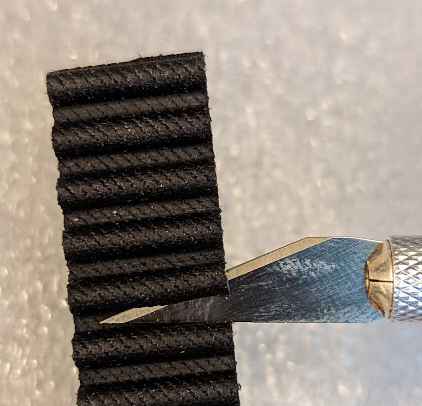

  6. At end A, use a fresh blade (the typical x-acto #11 is a good choice) to cut away the designated number of teeth. Start by cutting off most of the tooth, then carefully slice off layers of neoprene until you feel and hear the blade touch the cord. You should see the cord on the cut surface. You may find that a chisel is useful.

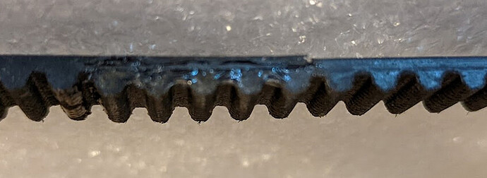

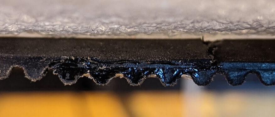

The belt will be slightly thicker (by the thickness of the cords inside the belt) than the surrounding areas, but the teeth should be well aligned in the direction of travel:
The glued section will (at least with CA glue) be stiffer than the rest, but in my experience it runs fine through even small toothed pulleys, like this:

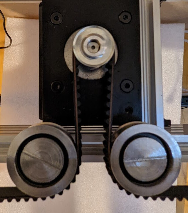

The GT2 belt that I tried to use to drive the Z axis on my monocle build skipped once I put load on the bed, so it just wasn’t good enough. I cut the belt out, but intentionally not at the joint, so that I could see how strong the joint is. I haven’t managed to pull it apart yet using more force than is comfortable on my bare hands. So my scale would be insufficient to show how much force it takes even to pull apart the joint in the GT2 belt.
For replacing the belt with beefier teeth, I went a bit over the top and got 15mm wide HTD 5M belt instead.
Now I need to make another closed loop. The alignment wasn’t absolutely perfect on the first one even if it was good enough, so now I’ve started designing a parametric jig in FreeCAD. The idea is that you can put in parameters like belt thickness, pitch of teeth, number of teeth you want to overlap, etc., and then you can print a jig for belt splicing.
Here it is, set up for ¼" rod as a hinge, and M6 bolts to hold down the flaps that keep everything aligned while setting up.
After this works, I’ll make the whole thing public.

Preparing the belt

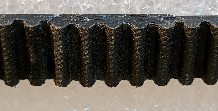

I chose to splice a section 5 teeth long, so from one end I removed five teeth:

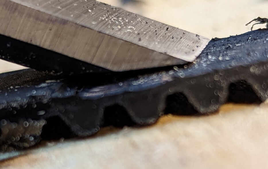

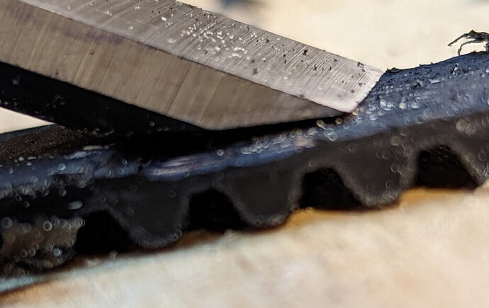

It turns out that the HTD 5M belt is harder to splice than the GT2 belt I spliced before.
So I brought out a very sharp chisel:

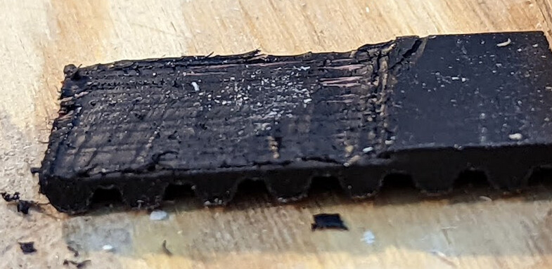

From the other end I removed the exact same amount of the back of the belt:
I was still facing this:

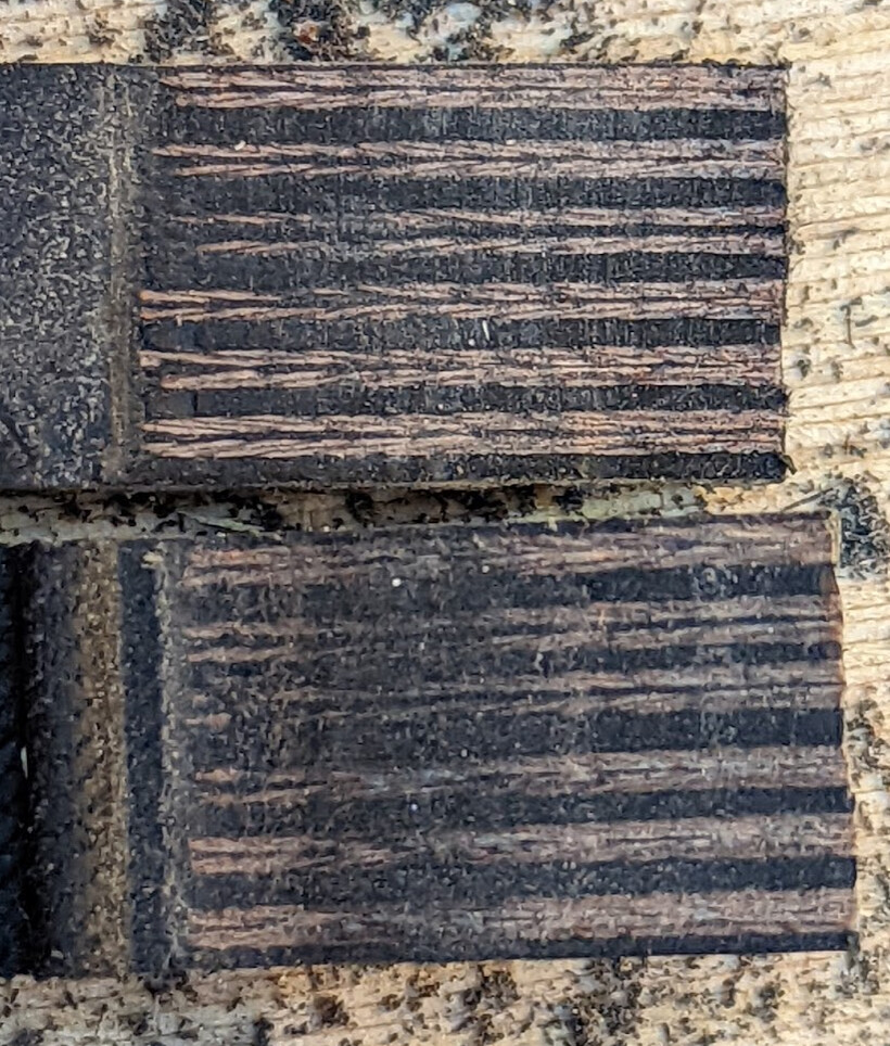

Here, you can see the fiberglass cords starting to show:

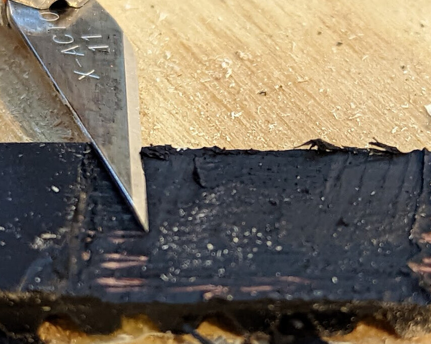

I alternated cutting and scraping with the chisel and using a fresh X-acto #11 blade.

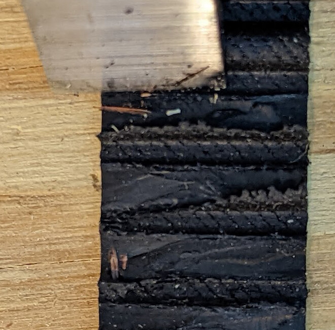

Finally, i used an 80-grit sanding block to expose the cords and get a flat surface. It is these cords being glued together that will make the splice truly strong:
I trimmed the ends carefully, trying for a clean fit with no overlap but not much gap either, testing by holding them against another piece of belt to make sure they were aligned correctly.

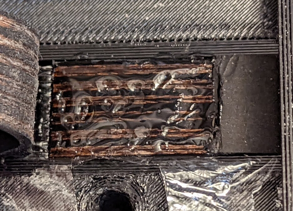

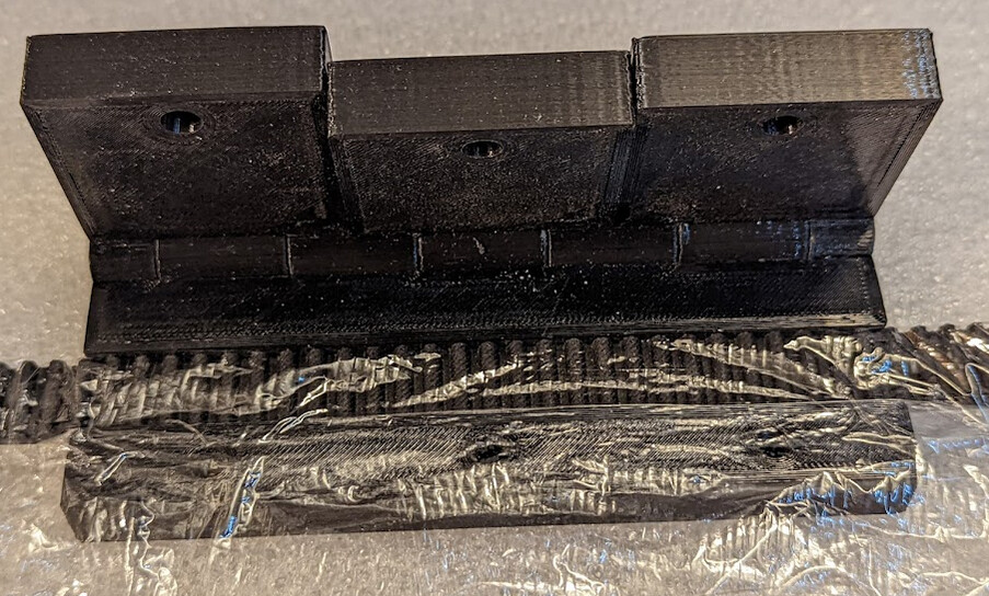

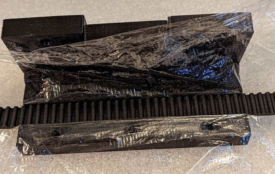

Using the splicing tool

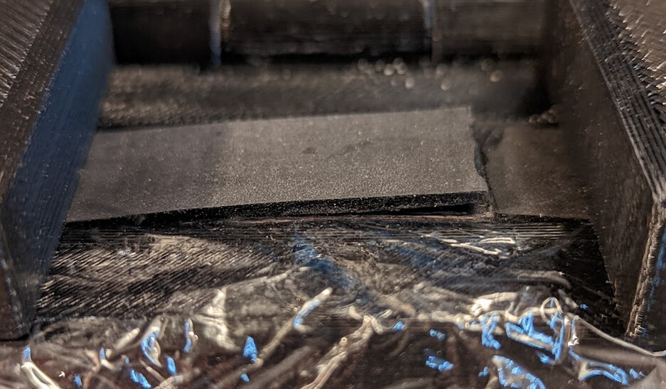

I laid cling wrap onto the base, then pressed a section of belt, teeth up, into it:
Then I folded the cling wrap over:

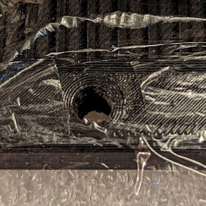

Cut holes for the bolts:

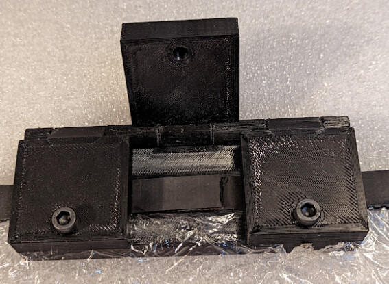

I put the end with the back removed, engaged with the teeth underneeth, and screwed down the block at that end to hold it in place.
Then I put the other end of the belt (with the teeth removed), being careful not to have any twists in the belt from end to end, into the other end, meshing with the area that was cut away on the back, and bolted its block down:
The ends are aligned but not yet glued:
Holding back the top flap with the teeth cut off, I applied the glue to the cut-away back, wetting it thoroughly but thinly:

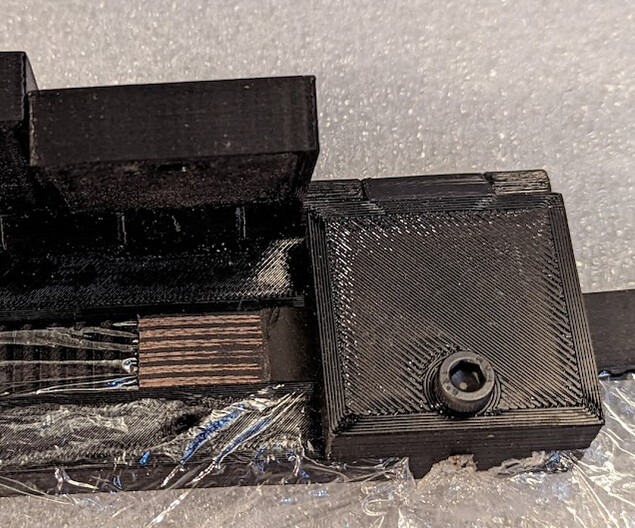

Finally, I closed the middle block and screwed it into place, and waited several minutes. (The glue said 20 seconds, but I wanted to give it extra time.)

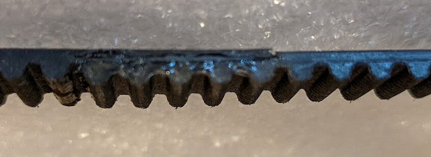

The join is quite even:

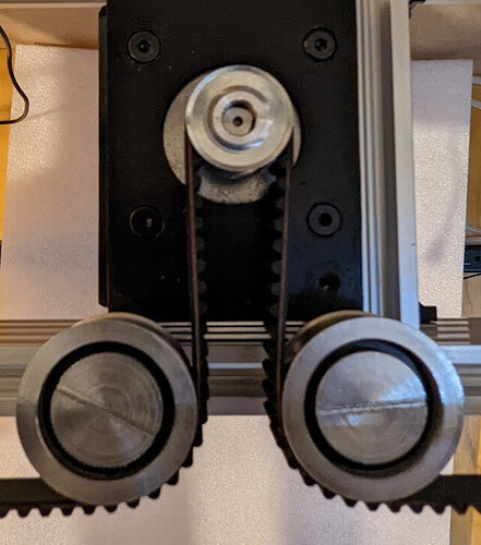

It is slightly thicker in this section, but not much. It runs easily through the smallest pulley in the system:
I hoped that a long section of tapped plastic would be strong enough for the bolt, but I could feel the threads giving way, so the next one of these that I make I’ll use nuts for the bolts. I’ll put space for nuts in the model before I publish it. Here the model is transparent to show where they will be installed:
The FreeCAD model is highly parameterized, and the README.md has extensive instructions for use.
There is a version for 2GT/GT2-6mm belt there now that uses filament for the hinge pin. Not sure whether that will work. I was just looking for something that most folks would have handy. Would be interested in other suggestions for hinge pins that people would be likely to have handy.
