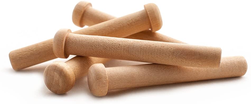

This is what you mean but you want a flat on the head??
Yeah, that’s the kind of thing I had in mind! :slight_smile:
If I were doing it on the lathe, I wouldn’t do a hemisphere top, but:
On the lathe, I had imagined something more like this:
But given those ⅜" pegs I expect I’ll just buy them, size the holes ⅜", and trim the peg tops to make them fit. That seems easy.

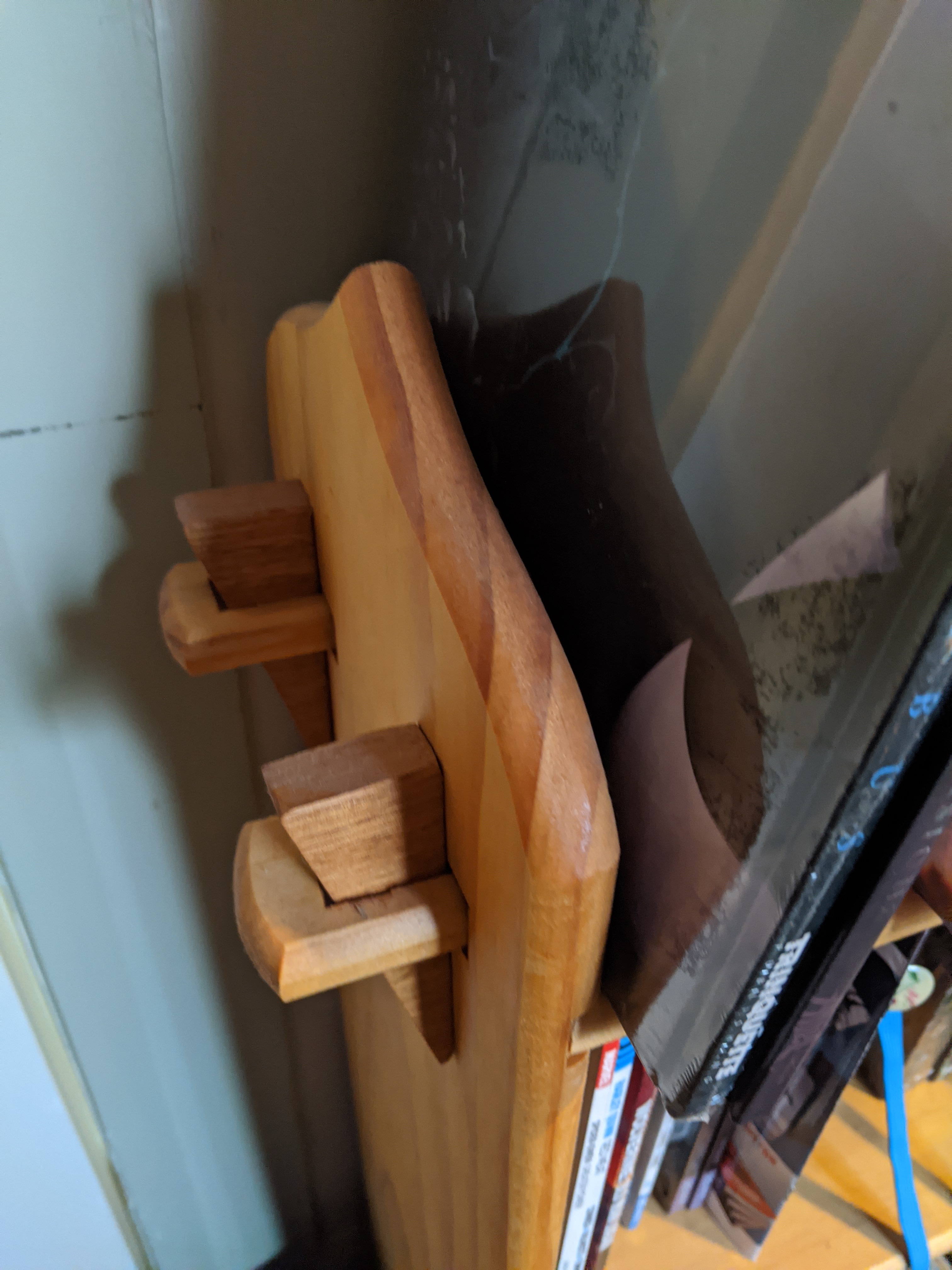

I would go with a square hole instead with the outer edge having a slope, that way you could just make some small wooden wedges to hold it in place.
This is a shelf I made for my office last year that does that… would just need to go smaller :slight_smile:
That is more elegant than my solution. I’ll probably play with different wedge shapes in cad, maybe using truncated wedges.

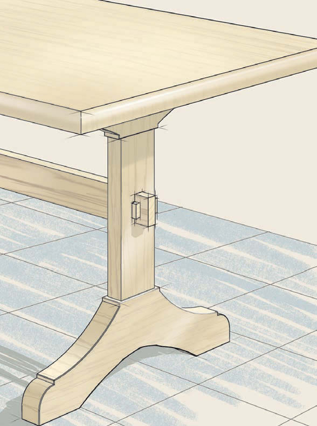

Type of Loose Tenon they are!
With the peg, it will be harder to get the shelf to draw tight to the side frame where there is only a small area of contact. Then as the load is applied and the wood is compressed the joint will likely loosen. The hole and peg position, size, and materials will be critical, not things wood, which is malleable, is good at. I have had this kind of problem using a dowel offset from its hole to draw in a joint.
Whereas:
The tusk tenon typically has a larger contact area against the side frame and the inner surface of the mortice. By definition, the wedge has the ability to draw the shelf and frame together over a larger range of tolerances. A plus is that you can tighten the joint as the wood moves over time.
One challenge with any kind of loose tenon is that with larger dynamic loads the wedge can work its way upward and loosen the joint. The angle of the wedge and the mortice-wedge contact area matter. The angle on both must match. Typically the wedge is made of hardwood.
There will be a lot of stress at the corners of the wedge’s mortice. I would endeavor to make the area around the mortice as large as practical and aesthetically possible. Especially pay attention to the corner of the mortice if there is inadequate material at that point the mortice can fail. Less likely with plywood.
And for maximum “draw,” the outer face of the wedge and wedge mortise should be beveled to a shallow angle of about 5°. The inner face of the wedge mortise extends slightly into the main mortise. This ensures that the joint will close up when the wedge is driven home.
The pressure exerted by the wedge on the outer face of the wedge mortise is how the work gets done. This means that you want the angle of the wedge and the mortise to be a perfect match. And to avoid splitting, be sure to leave adequate material beyond the wedge mortise at the end of the tenon — a minimum of 1 ⁄ 2 .
