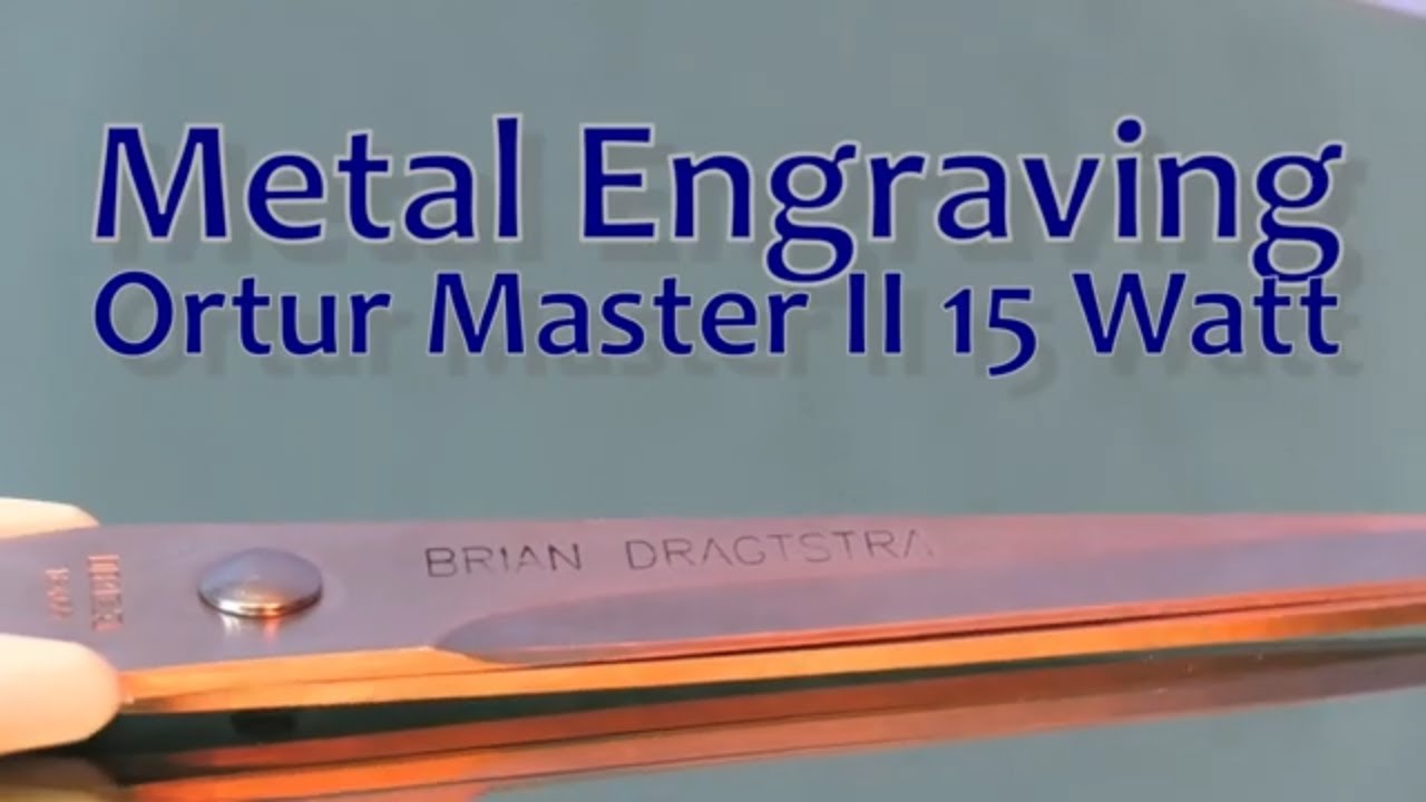

Via hackaday which has some interesting comments, we have a video that suggests marking steel with a moderately heavy coat of plain yellow mustard on a blue solid state laser. The rest of the video is suggesting doing a google search for “shx fonts” to get some single-line fonts for use in LightBurn, and his latest iteration of an air assist tool for Ortur engravers.
