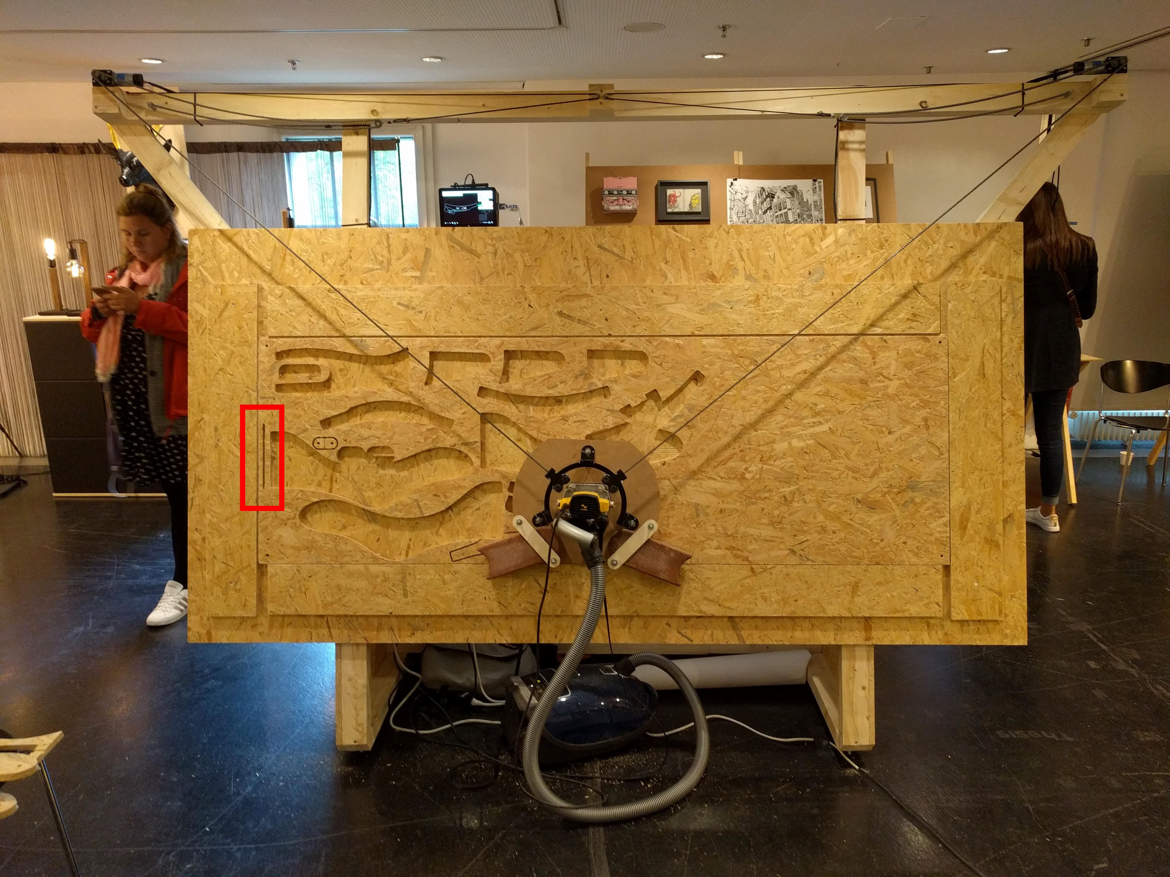

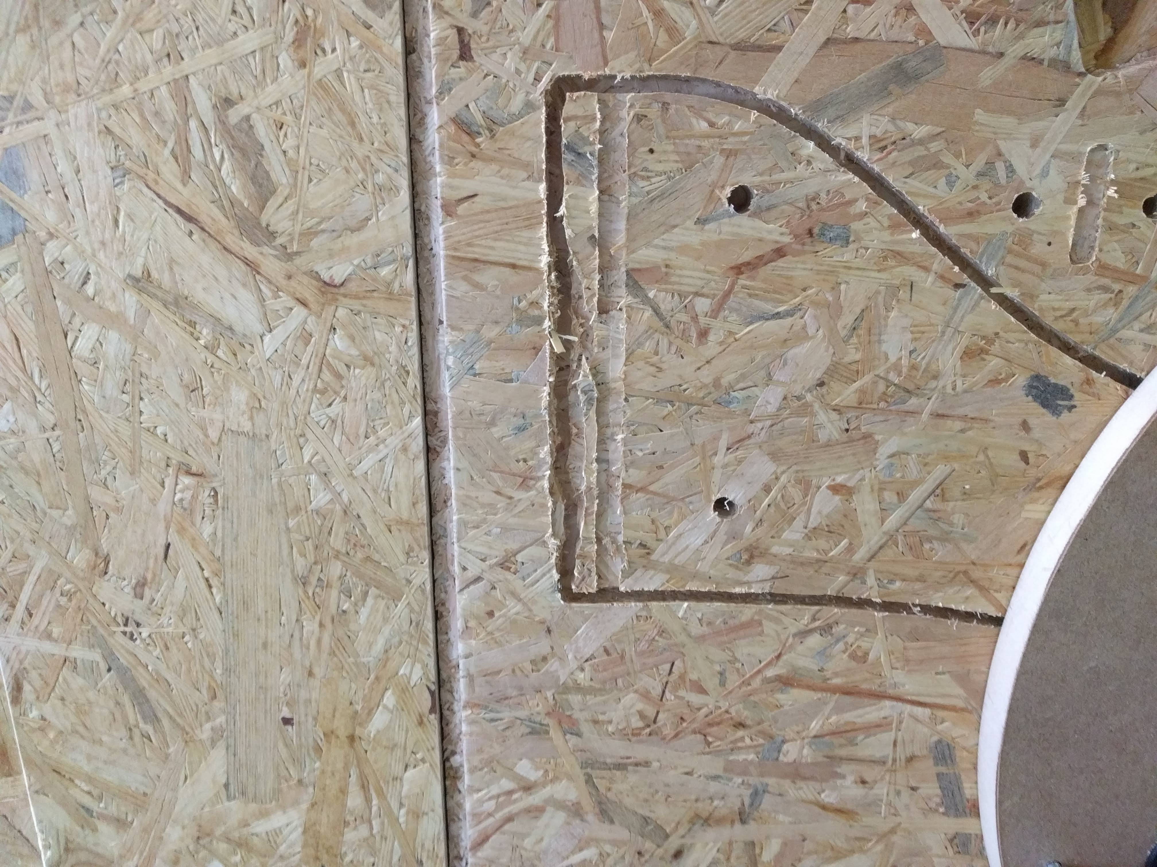

MaslowCNC does not like vertical cuts
I’m wondering how it cuts those vertical lines if I rotate the shape by 15 degree. Or if I could teach the CAM to generate “climbing” paths.

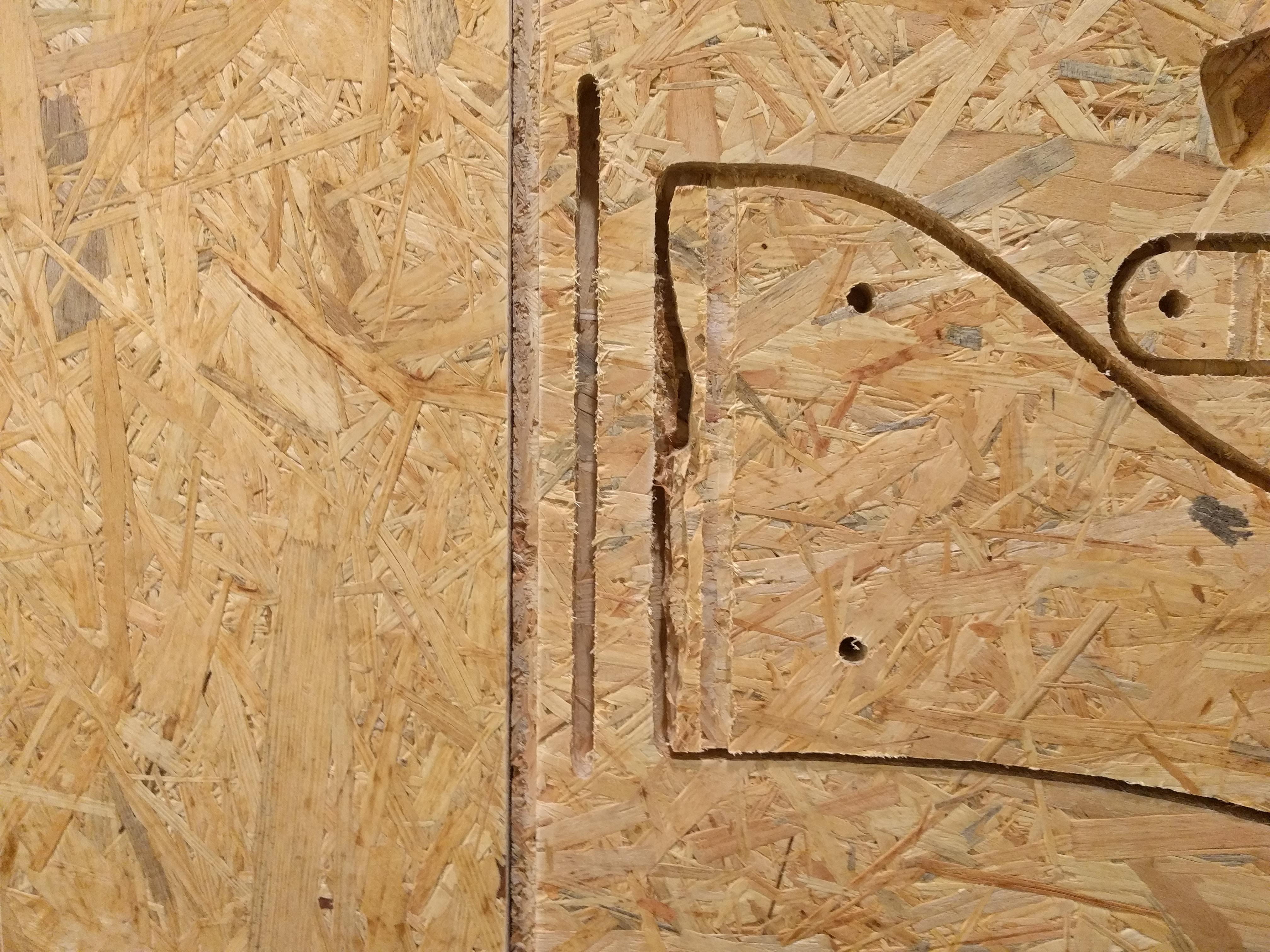

This time I forced the machine to do a climbing cut. The result seems to be ok. :slight_smile:
Seem to me you are far from the center, I would say near the far left edge where it is the most sensible. good to know that upcut is better than opposite, and it make sense when you think about it. more you are going up more the chain angle increase on top of the pressure the bit have on the wood (motor force vs gravity) .
