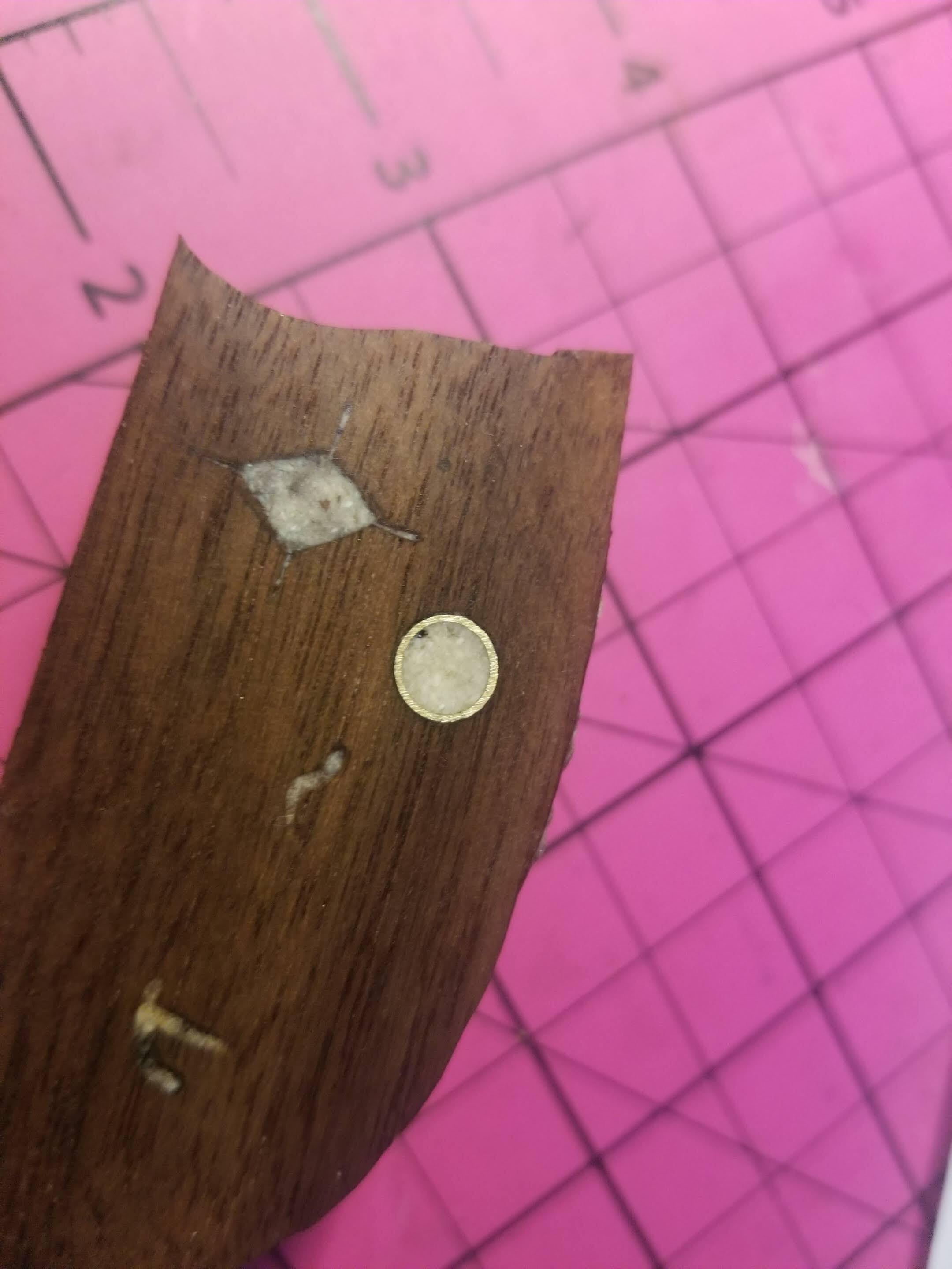

I use various materials for infill.
This one is animal bone [get chewing bones from pet store they are already dry]
I grind chips of them in a coffee bean grinder and fill, in this case a brass tube. Then saturate with thin CA glue followed by accelerator. Grind/sand to finish.
Other fill materials include ground coffee and various fills you can find a Michaels.

I love this idea and the outside the box sourcing for material! While this wouldn’t work for my current project it is without a doubt something I will keep in mind or future projects. I can think of two right off that would probably be a good match with this method.
