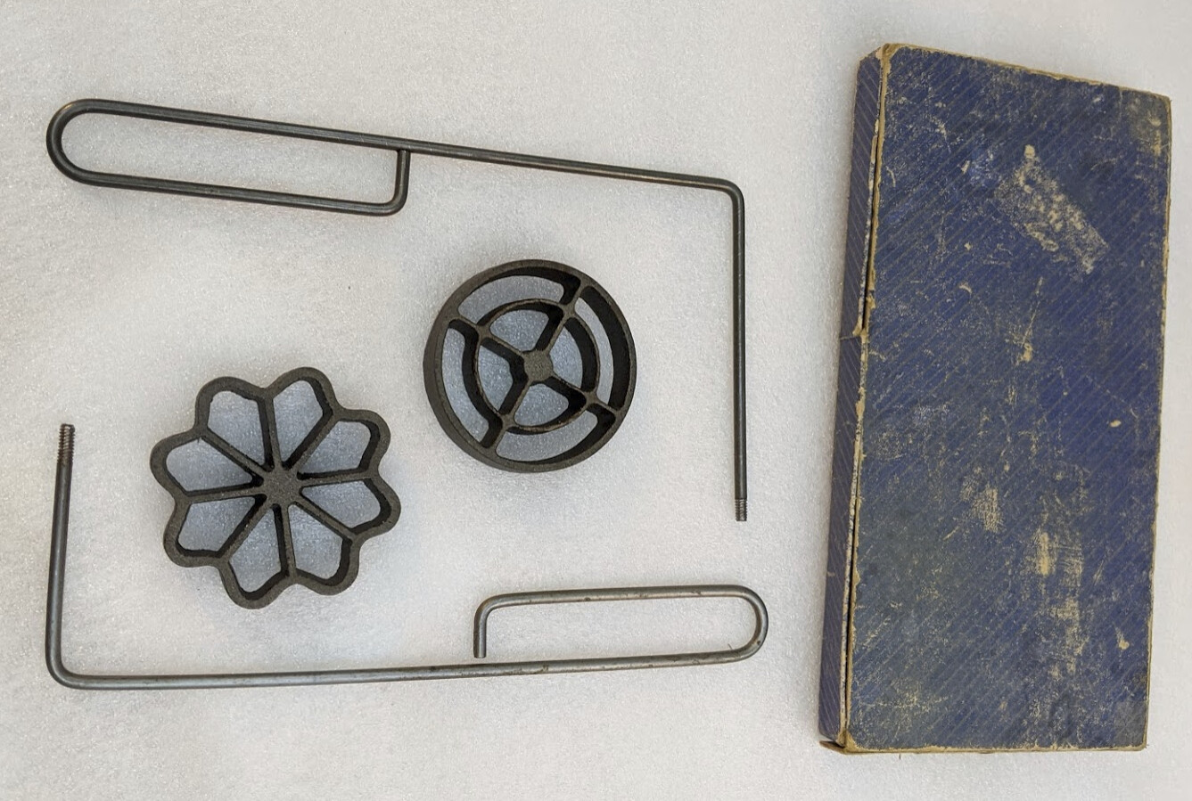

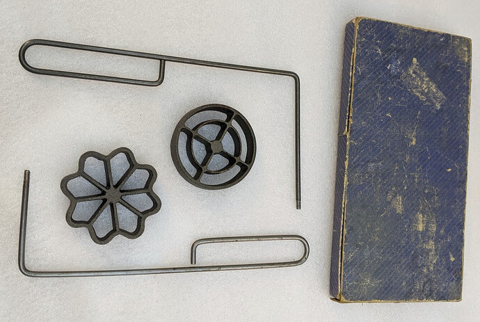

My wife is a mathematician. She also has some Scandinavian heritage, and she has a family heirloom that typically gets used around Christmas: Cast-iron rosette irons in two classic shapes:
However, the threads on one of the handles were a bit damaged, and when I cleaned them up, I got the bright idea that there are a lot of beautiful mathematical shapes. Maybe I could make something that honors both my wife’s Scandinavian heritage and her calling as a mathematician. Both of us enjoyed spirograph as kids, and the idea of using the simplest of those shapes, the rose or rhodonea curve, as the basis of a rosette iron got hold of me and I couldn’t seem to let go of it. Especially when I learned that new rosette “irons” today are made of aluminum, and I remembered that I had some ¾" cast aluminum plate that I picked up from the scrap yard a couple years ago.

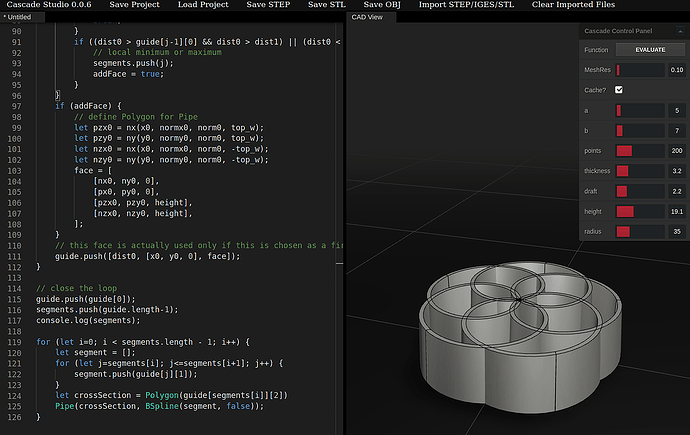

Meanwhile, through LWN I had learned that Kiri:Moto exists. However, it couldn’t handle the non-manifold objects, so I had to heal them in meshlab to toolpath them. Separately, last summer I played with CascadeStudio right after it was released, and liked it. So I started over and modeled it completely differently in CascadeStudio. The resulting object was a valid manifold! It was also much simpler, so it was much faster to process.

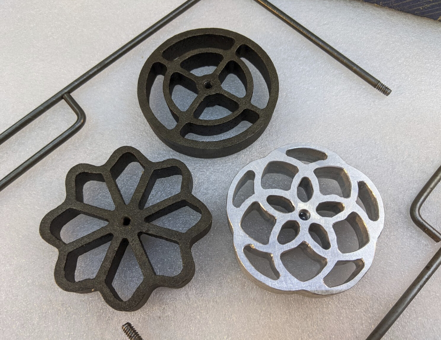

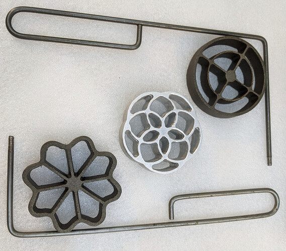

Here’s the whole family together now
The bright one in the middle is my new aluminum rosette iron. It’s a 5/7 rhodonea (rose) curve. The surface is rougher than I intended due to technical difficulties that prevented a finish pass, but this actually might be a feature that makes it work better; a smoother finish might not hold the batter as well.

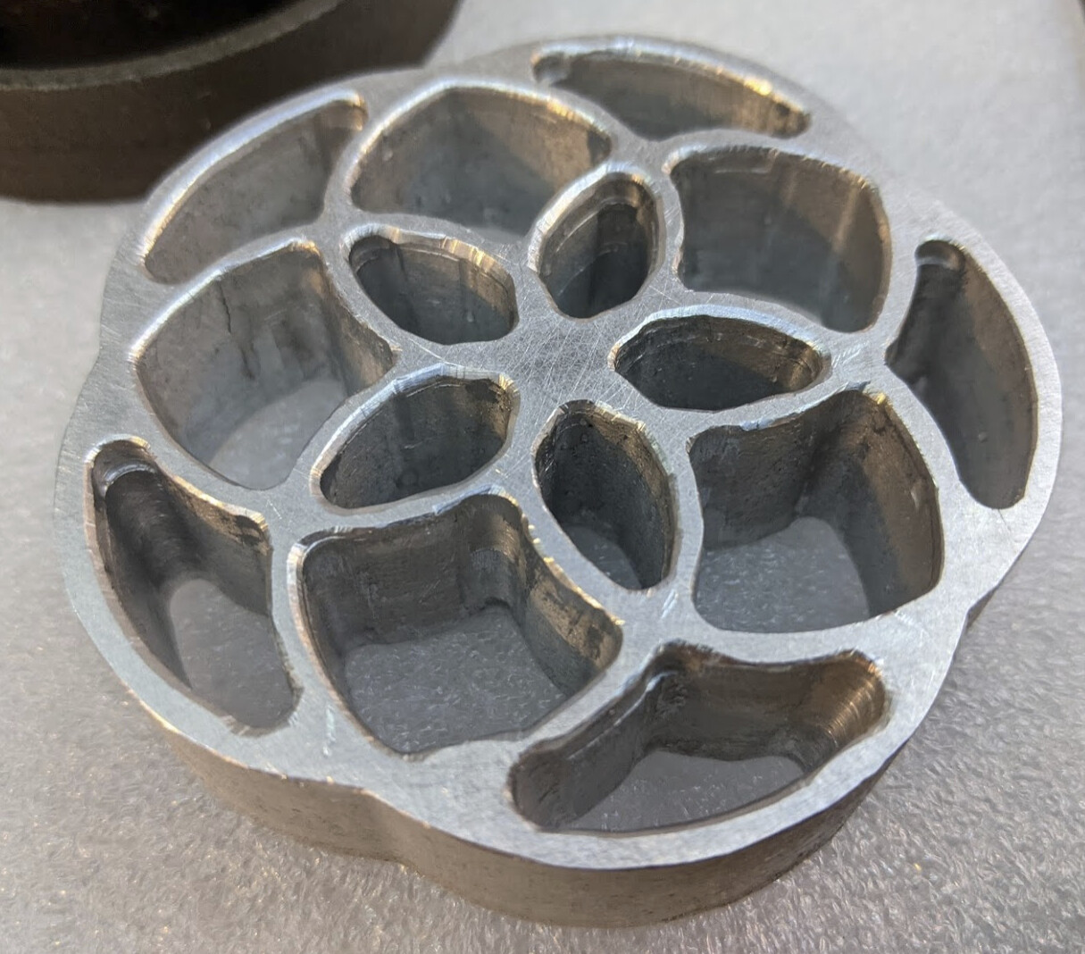

My 10-24 tap is a piece of junk, which made tapping no fun, but I got it done. Here’s the back side of each iron. Note that the back is thicker than the front; this is the draft angle of the mold and is meant to help make it possible to remove the rosette cookie from the iron after it is cooked.
Breaking all those edges took a while even with a deburring knife, and I had to find several different files to touch up a few places. No one would mistake this for professional work, but I’m very happy that I found a way to make this work, and I’m looking forward to trying it out.
If the smallest holes in this pattern end up too small, the 3/5 and 3/7 curves might be simpler and work better. If I end up deciding to make another one, hopefully I’ll have the flaky router problem that resulted in not being able to do a finish pass diagnosed and fixed. :smiling_face:

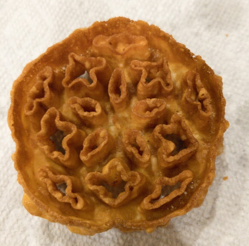

The first attempt stuck terribly to the iron and I was afraid that the surface finish was too rough. The second attempt wasn’t much better. But then the surface seasoned, my technique improved, or… some of each!

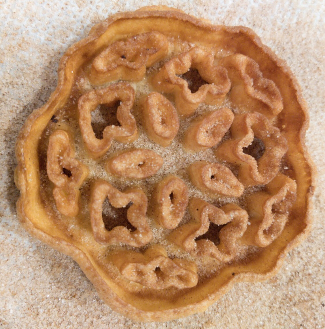

These exist in many cultures around the world by a variety of names. We tried Mexican Buñuelos de Viento, so they were dusted with cinnamon sugar rather than confectioners’ sugar:

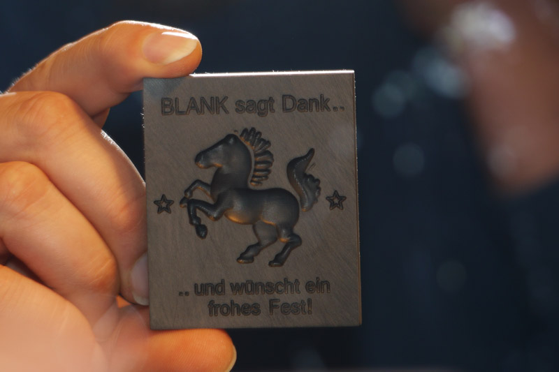

I was confused how your stamp was readable without being in reverse, before I realized that you posted it in mirror image! :smiling_face: Very nice! Is that a shortbread?
I also cut my watch case on an extruded frame router, but recognized that fast speed and low tork are not good for xsteel. With a 3mm bit you end up at about 6000 rpm and need liquid coolant not to heat the surface over rehardening temperature.

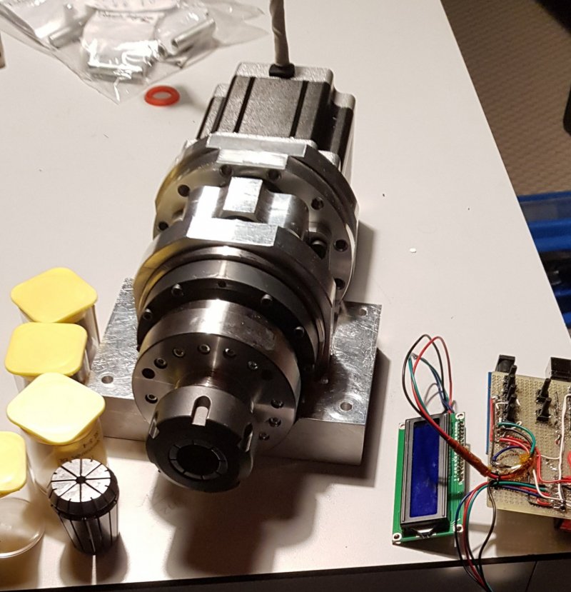

The air hardening xsteel (dependent on the alloy) should not exceed a rather low temperature short above room temperature… comming down from higher levels the surface gets harder. Even much harder to cut is temper cast as you have a pretty hard surface skin due to the temper structure below its pretty decent but gettin trough the skin is not easy… I bought an ER32 collet for my devider head which was cast and afterwards had been ground to finish… hard to even get the screwholes into
