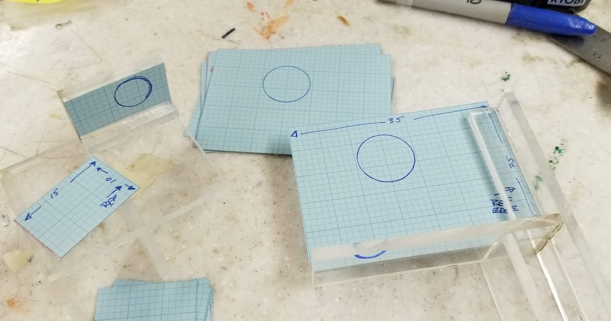

As I see it the problem with alignment is knowing where the beam is in 3D space relative to the gantry.
The most difficult alignment is when your tube is not parallel to the gantry and the beam exits the first mirror at an angle relative to the gantry.
This set of tools is referenced to the gantry and give you the ability to see the beam in all axis, x and y along the beams path.
By placing a target that is referenced to the gantry in two locations along the path you can see complex misalignments pretty easy.
I have only used this setup a few times but found it pretty easy to align the beam all the way to the surface.

My experience is; all that matters is the beams alignment with the axis of the gantry.
I ignore the machines frame etc. and reference some carefully cut pieces of acrylic with precisely registered targets. Could be laser cut of course.
The optical ideas I have tried turned out to be just as hard to adjust as the machines optics and you have the key question of which one is right.
