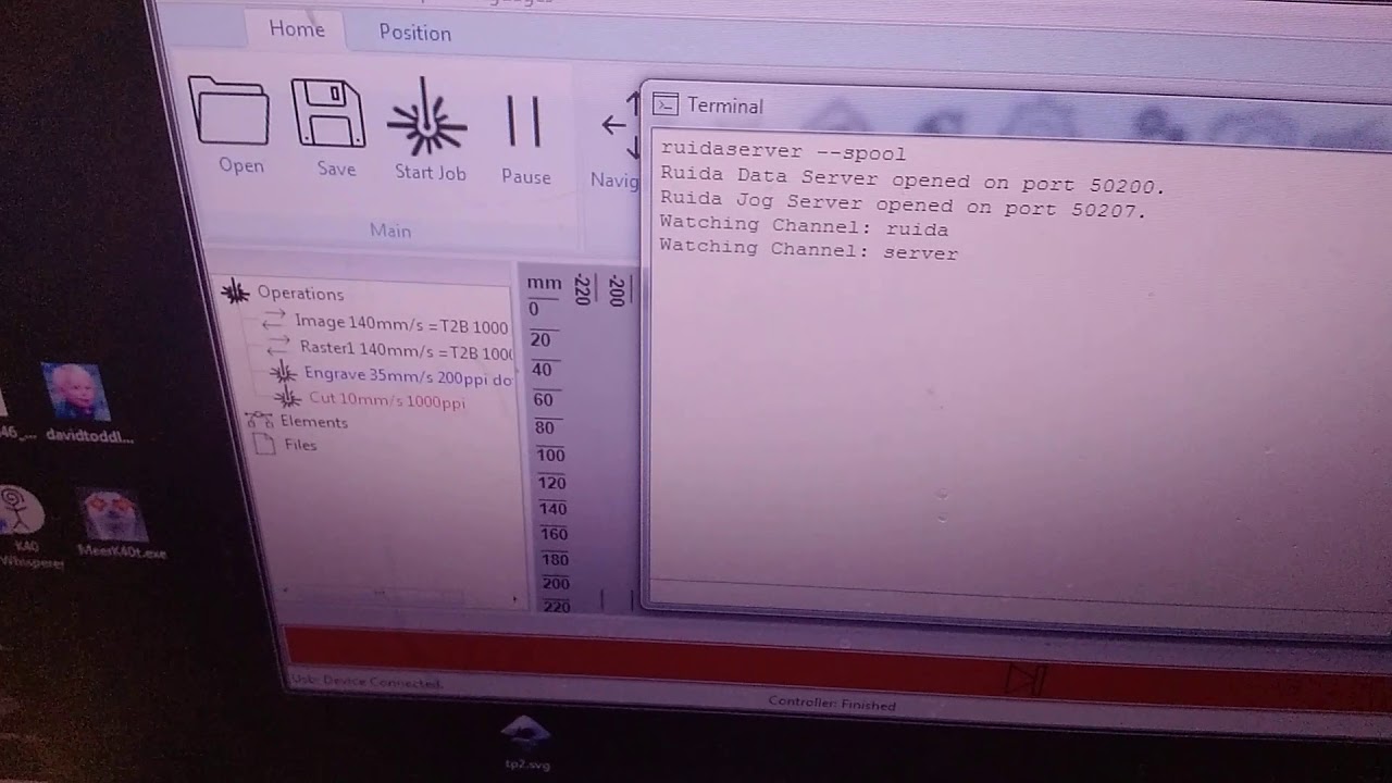

I also have Meerk40t working through pip now, for installation. pip install meerk40t will install meerk40t. The default is CLI only. So you could do pip install meerk40t then meerk40t -czd Moshi -e "ruidaserver --spool" Since meerk40t runs the pip installed script and -c gives you a command console -z suppresses the gui (which wouldn’t start but incase you have wxPython installed), -d Moshi sets the default device to Moshi (omitted this is the M2 as default). -e runs a console command directly, here the command is ruidaserver --spool which loads up the ruidaserver in spooling mode. Which means when you send it an .rd over the network it just converts that to cutcode and sends it into the default spooler, which would be for the ruidaserver currently.
In theory you could run that on a raspberry pi in less than a minute. And then connect LightBurn to that ip address, and have at. Same thing for M2 Nano. Though it hasn’t all been extensively tested, other than knowing the parts work. Also, pip install meerk40t[all] would be more typically for a proper meerk40t install. Though you might not need opencv or the camera so you can omit that and just do the features you need pip install meerk40t[gui,cam,dxf] which will install the extras.
