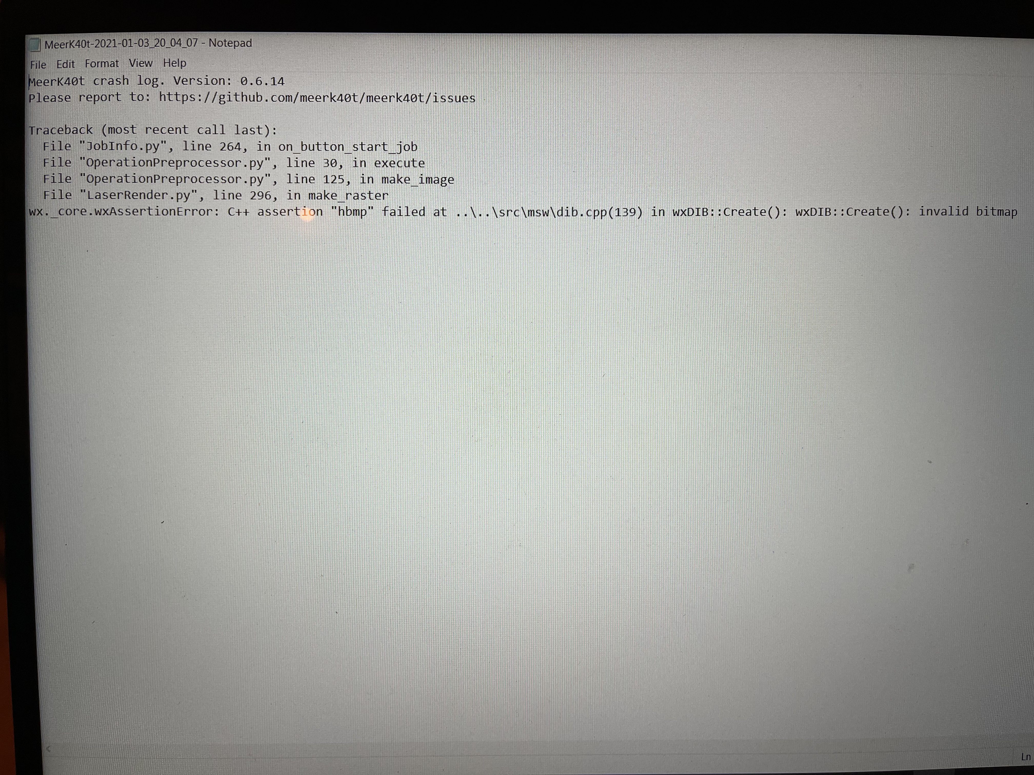

I’ve just started using Meerk40t and have hit an error with my first try.
Any help would be greatly appreciated.

To help others searching for this error to find this post with an explanation, the error text is:
wx.core.wxAssertionError: C++ assertion "hbmp" failed at ... invalid bitmap

That error is something so big that it can’t ever create the bitmap because the memory can’t hold that many pixels.
