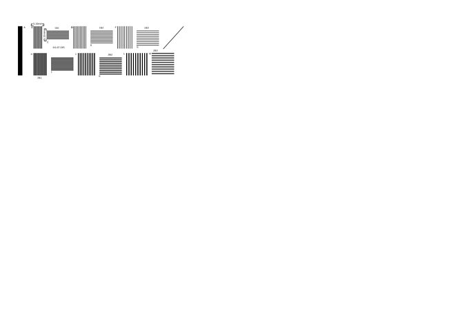

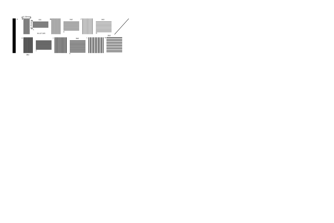

A test that can show the total systems response can be designed as follows
Alternating vertical and then horizontal bars (made up of pixels) imaged left to right on the page varying the dot on/off pattern;
1 pixel on - one off
1 pixel on - two off
1 pixel on -three off
2 pixel on - one-off
2 pixel on - two off
2 pixel on -three off
…Repeat as necessary
With a loop you can measure the marks and spaces and tell how the system responds. If they match the source dimansions [in mark and space} then you are good if not any imageing you do will be degraded from your expectation.

I was not trying to prove the effect of PPI on laser response time with that test.

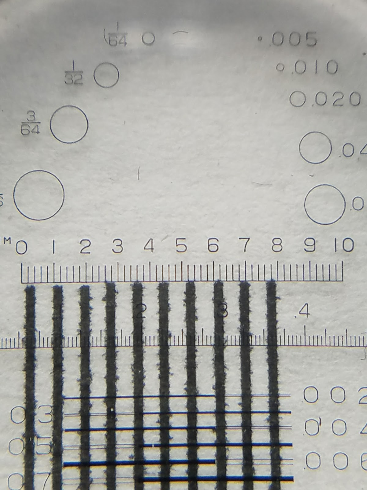

The test I suggested was just see if with and without PPI you had enough response to resolve a dot and if not at what point can you resolve the lines and spaces. This is a pretty standard test for marking system response.
@ 300 dpi you are looking at .003" lines and spaces and yes you can measure in that range with a good loope. The pictures in the last post are from a loope measuring output on a laser printer (don’t remember the resolution).
Your method for measuring the effect of pre-firing sounds like a good idea!

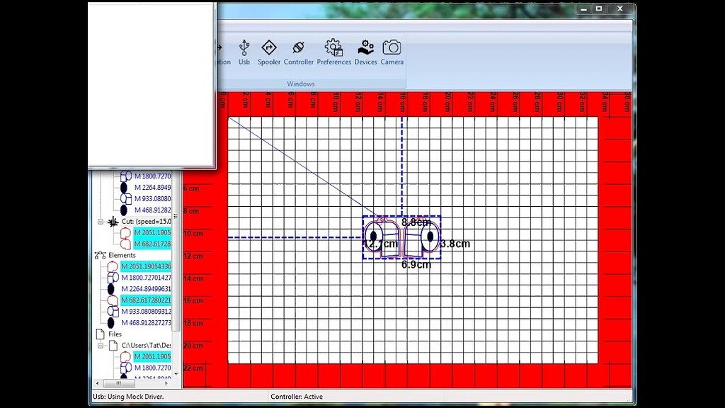

Make a normal svg file like you would for whisperer or some other program, drag and drop that into the scene. And hit the button that looks like a laser beam. Third ircon there. It’ll show you the job as it is arranged current and the operations it’s intending to do on that job. Hit execute commands. Then you’ll get “Start Job” because there’s nothing about the data that needs any tweaking. Hit that and it should start up the laser and start doing the job.
Lemme see if I can’t cook up a quick video.

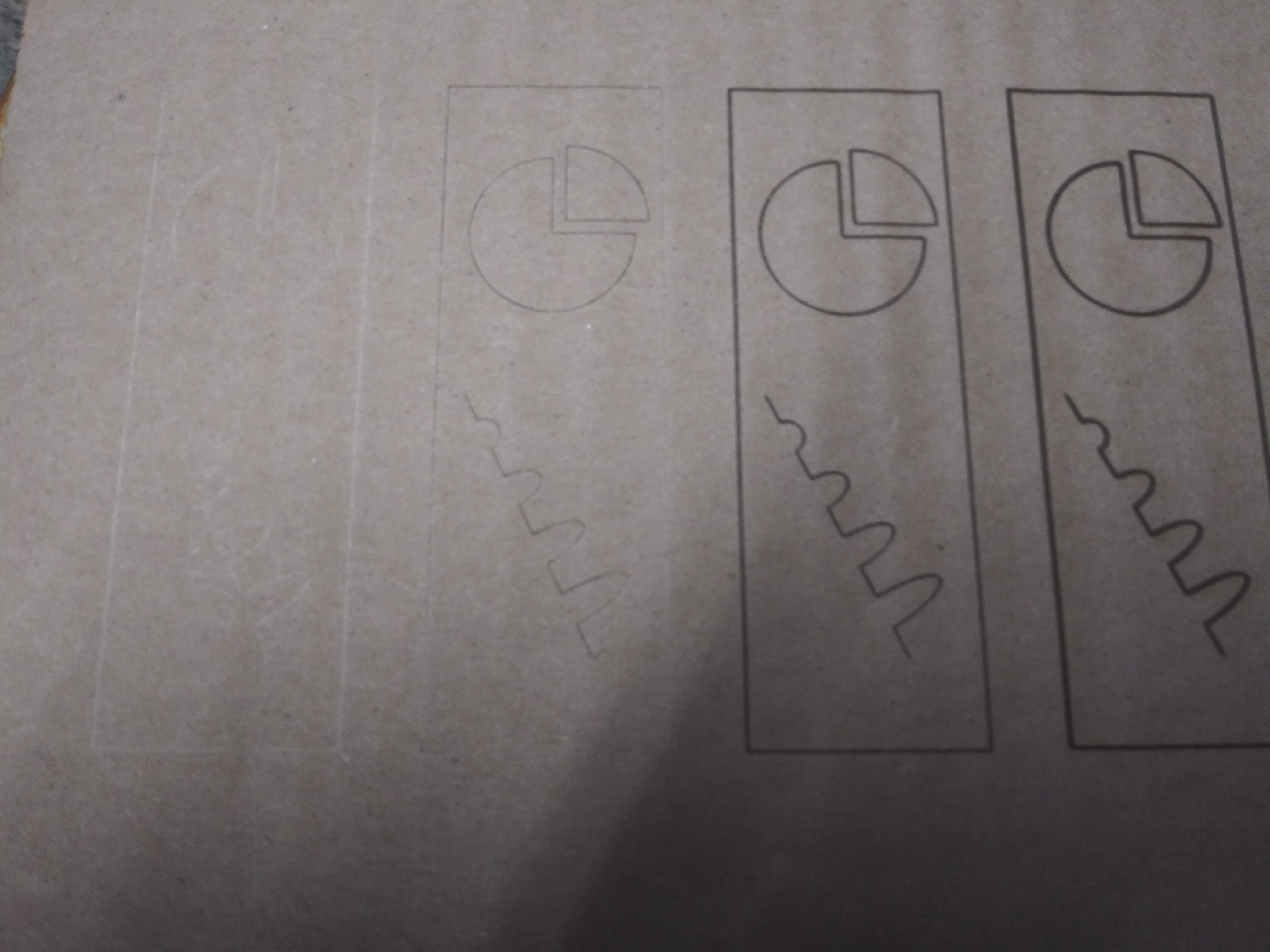

Cooked up a video. Posted in its own thread. If you have any questions go ahead and ask there. I can work up some more basic instructions if they are needed. PPI you turn on and it draws lines with a more flickery laser. Works pretty nicely.
