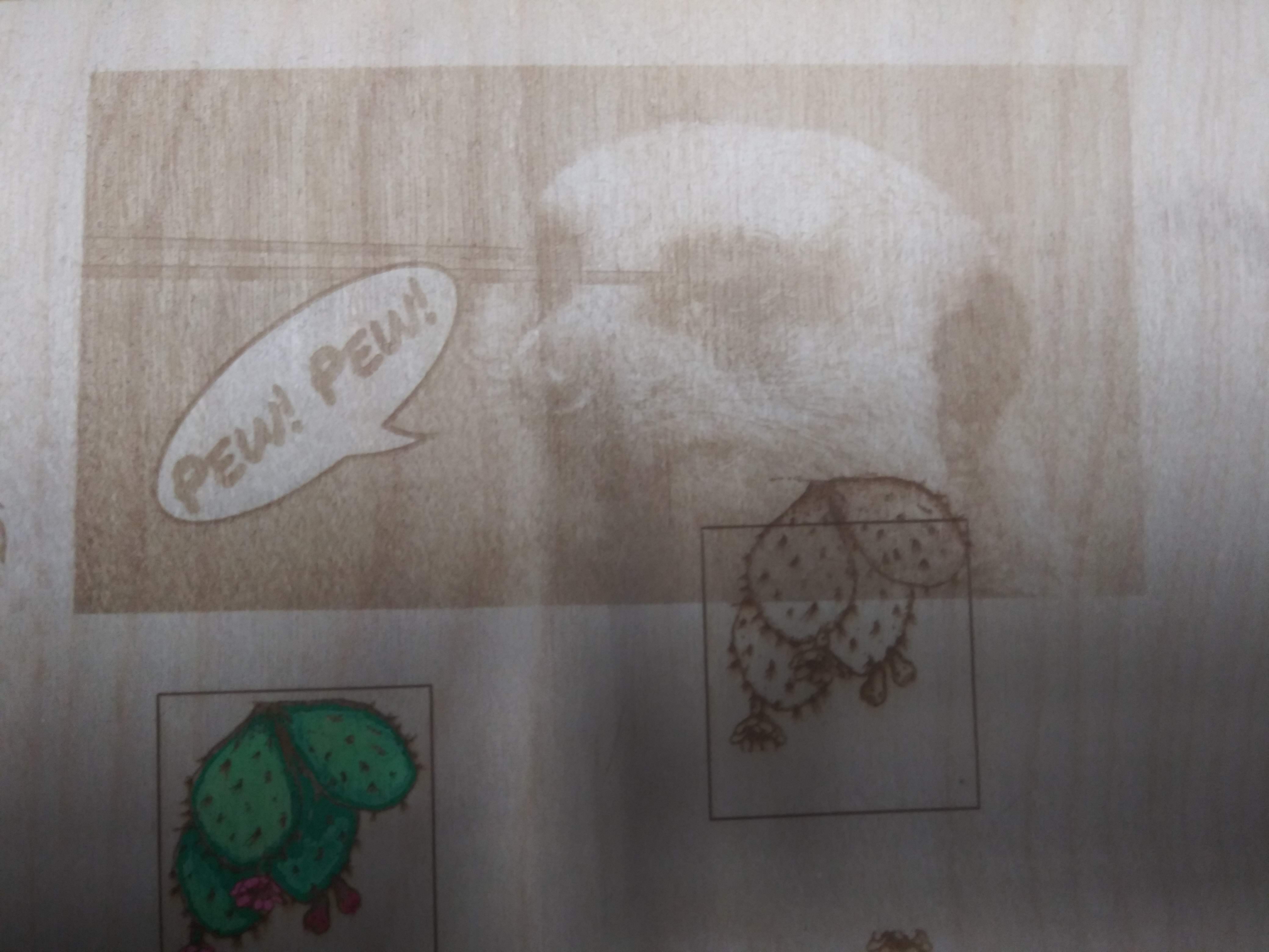

Yeah, not only that but it actually works for rasters too. I had just done PPI from the vector shapes using PPI to then cycle the fire or not-fire pulses. But, it turns out that if you use the same thing with the rasters you can take the value of the pixel and use that just as easy. And carry the extra pulse data forward. So if it’s a 25% dark section rather than saying that’s actually 0% dark, draw no pixels. It says add 250 to the PPI counter. And when that adds up to more than 1000 fire the pulse. So it fires every 4th pulse. In a 25% dark section. But, it can work even in complex data. And can modulate the larger pixel sections even in greyscale. So if the grey is 50% and the step is 4. It should actually do 0101 rather than 1111 or 0000 if the pixel is 80% grey it’ll do 0,1,1,1 (with 200 PPI left over).
Basically the idea behind PPI is that you do a bresenham like error carry algorithm. Usually you go some direction and have a 1 or 0 for whether you fire the pixel or not. The PPI applies a different meaning to the 1 and 0.
1 means you add the value of PPI to the pulse_value.
0 means you do not.
If the value of the pulse_value is greater than 1000.
     You laser that mil of distance (that dot, that pixel)
     Subtract 1000 from pulse_value.
That’s basically the entire algorithm. It could be added to Whisperer in pretty short order too. When PPI is 1000 every 1 gets the laser. When it’s something like 200 every 5th dot gets the laser. Etc. Basically it’s a carry forward value there. The real trick though is PPI is pulses per inch. The stock controller uses 1 mil of distance as its native unit. So when you set the PPI to 200 so 20% power, and draw. It will 200 * 1000 over that inch, which is 200000, which means that the inch will get 200 laser pulses. That’s exactly the definition of PPI. Pulses per inch. QED.
It’s kinda a game changer, but I also have a number of other advantages. And I’m totally all for hackable software. I want folks to be able to figure out how it works and write their own stuff for it.
Here’s video of it running and PPI raster working (though I don’t have that version released just yet, soon though).

I haven’t done the math on this yet but I wonder about the K40’s controller-LPS-Laser system having a high enough response for this to work well.
The PPI controllers that I have seen have been implemented in hardware.
The M2Nano board is tiny. Like it’s an 8 bit chip with some 16 bit registers. It doesn’t do any processing on the chip. It’s basically following ascii like machine code commands. That basically mean weird shit like add 13 mils of magnitude to the right/left buffer. Then when it sees the next directional command it’ll cause it to execute that. The speedcodes are literally two ascii numbers between 0 and 256 stuck together and they control the number of clock ticks until it sends a pulse to the stepper motor. It’s actually pretty neat but it relies entirely on the software doing the processing. It literally stores like 40 bytes of data in the buffer and tells when it’s okay to hand it the next packet.
I had to map out most of the scheme to do the work.
The link should be to the wiki documentation.
It would be entirely possible to build a routine to run a fake gcode reader thing that uses the code here to more or less convert that over to lhymicro-gl code and feed it to the usb. So hook a raspberry pi zero to the board inside and then presto claim that that’s a GRBL. It will still have problems like the lack of acceleration up to speed will cause the machine to jerk beyond about 30mm/s in non-raster mode.
I was thinking of doing some of this stuff for my K40Nano project ( https://github.com/K40Nano/K40Nano ) . But, as the LightBurn folks pointed out they couldn’t use it since Scorch used a GPL3 license and just radically changing everything doesn’t make it not derived from that. And it’s not even a version that permits library inclusion for that license. So I wrote a java version from scratch. Added said java version to Visicut. Then wrote a python version from scratch, based in part on the Java MIT licensed version. So I ended up basically abandoning that project (K40Nano since it could only be GPL3). Though now with the MIT licensed version and more well rounded code here it could be revisited.
It shouldn’t be too hard to break the back end writer and controller code away from the front end GUI etc. In fact, it should be coded up to make that entirely reasonable. That way I could switch out the backend for like Ruida or something.
As for the response time it’s fine, what matters though at some extreme ends is the time per command vs. time to send each command. At 100ms/s and typically 1/2 distance pixels the machine actually finishes all the code in its buffer before it can get more, which makes it lag out and restart in a stop sort of thing. If it’s a bit slower, or has commands that take longer to execute it’s fine. In raster mode we’re talking: DBaUBbDBa means go right 1 then laser up, go right 2 laser down, go right 1. So each 4 bytes to write 1 bit. Though when they are longer you get things like DBzzzz which means laser_on, go right 1024 mils. Which takes a much longer time than it took to send.
But, even when it caps out, which takes a bit, it just goes back to where it bottomed out and starts again without any error.
By response I am thinking of the thread through the controller and the laser power supply and the laser itself.
What would the smallest pulse be at the fastest surface speed?
The lasers pretty close to instant given it’s wires at mostly the speed of light and light at the speed of light. The slow bit is the steppers which have a resolution of 1 mil which is also the smallest pulse of light. You can safely get to speeds of about 35mm/s vector but can go up to 200 mm/s for raster.
However, regardless the speed you’re going at the buffer can be taxed and it’ll slow you down if the time it takes to process the entire buffer is less than the time it takes to add new things to the buffer. The program will have a full buffer in a constant send loop but the machine can’t take it fast enough.
But for minimum amount to hit it with a laser, you’re looking at about 1/7000th of a second over 1/1000th of an inch. Though the laser itself will be a bit fatter than depending a bit on focus.
Actually the laser subsystem does not respond (switch) at the speed of light. There are multiple factors at play, the LPS response but more importantly the ionization characteristics of the laser when presented with short on off pulses.
Unfortunately we do not really know the lasers response and measuring it has been illusive because reasonably priced devices that can see this spectrum are slow and to sensitive to put in the beam.
One of the benefits of PPI is that it should speed up the lasers response due to pre-ionization effects, how much … no idea.
The only published information I have found suggests a 100us response time but doing the math suggests that we would not be getting the good results we are seeing in the images.
Since @Tatarize has demonstrated results, it sounds possible and the question is about quality? I think what matters is:
  • whether total activation time is enough shorter than 143ns to result in no perceptible image change
  • whether there is a difference between activation response and deactivation response times that results in a non-linear power per area
Am I missing something here?
I’d think that if there are non-linear differences between on-response and off-response, applying a gamma curve to the image data before the PPI calculation would be a way to handle any such, and just engraving a series of 10% 20% 30% … 90% 100% areas and comparing them against each other through a 10% gray filter would be a good way to test whether there a gamma curve would be helpful to improve fidelity.
