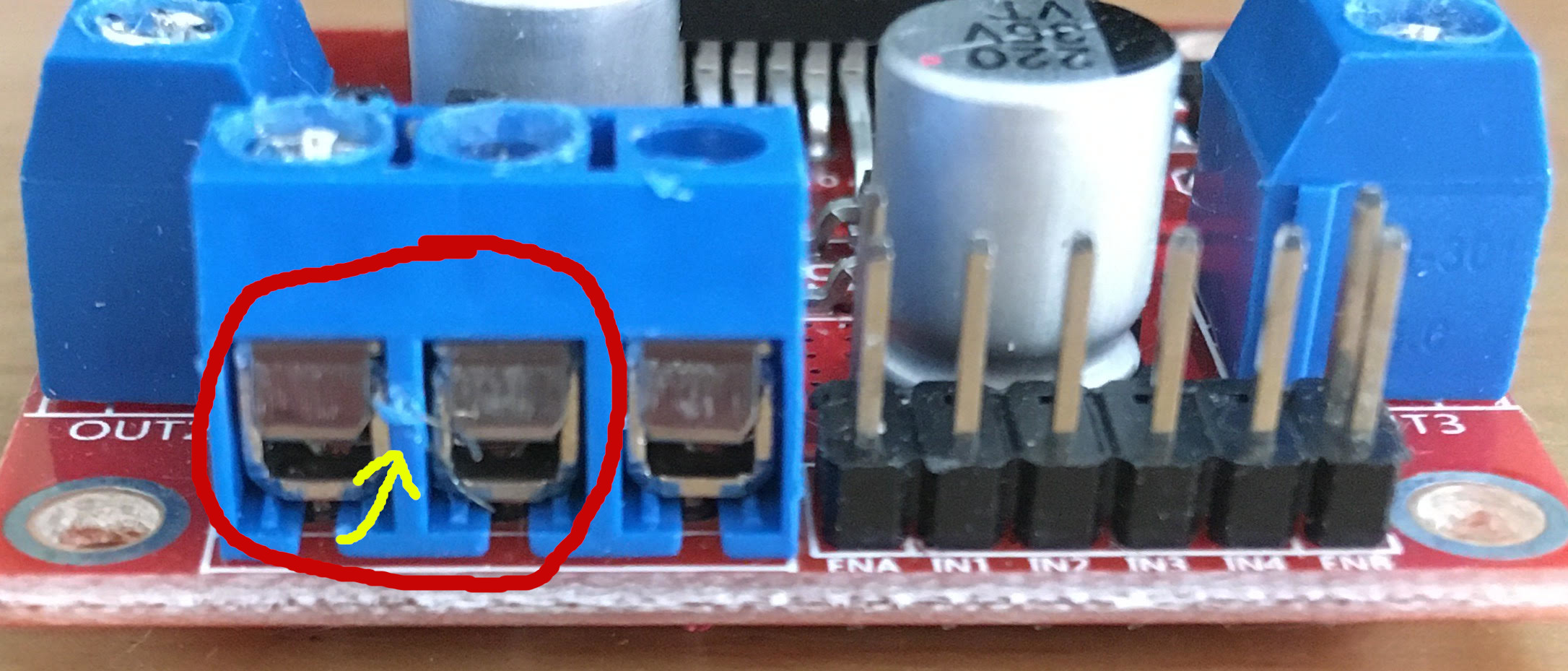

After looking over the driver a little more, I spotted a wire that had melted into the plastic between the VCC and GND terminals -
Could this have caused the problem?

I"m guessing you also didn’t see or hear any motor movement as you inserted the 4th battery.
Yes, shorting out the battery pack leads will melt things. So now you learned to ALWAYS look very closely when inserting Pos and Neg leads into wire terminals when they are side-by-side. It is one reason why, when using power supplies with 3 pos term and 3 neg terminals I will always use the ones away from the 2 opposite terminals which are side-by-side.
Yup, that’s a short circuit! Those batteries have the ability to provide a lot of current. You might want to add a fuse of some sort to your battery pack! :relaxed:

Aye no movement at all, just a lot of heat from the pack all of a sudden aha. Cheers for the tip too, I’ll keep that in mind when I come across terminals like that!
I’m pretty sure most of us have been caught by this type of thing at some point in time.
