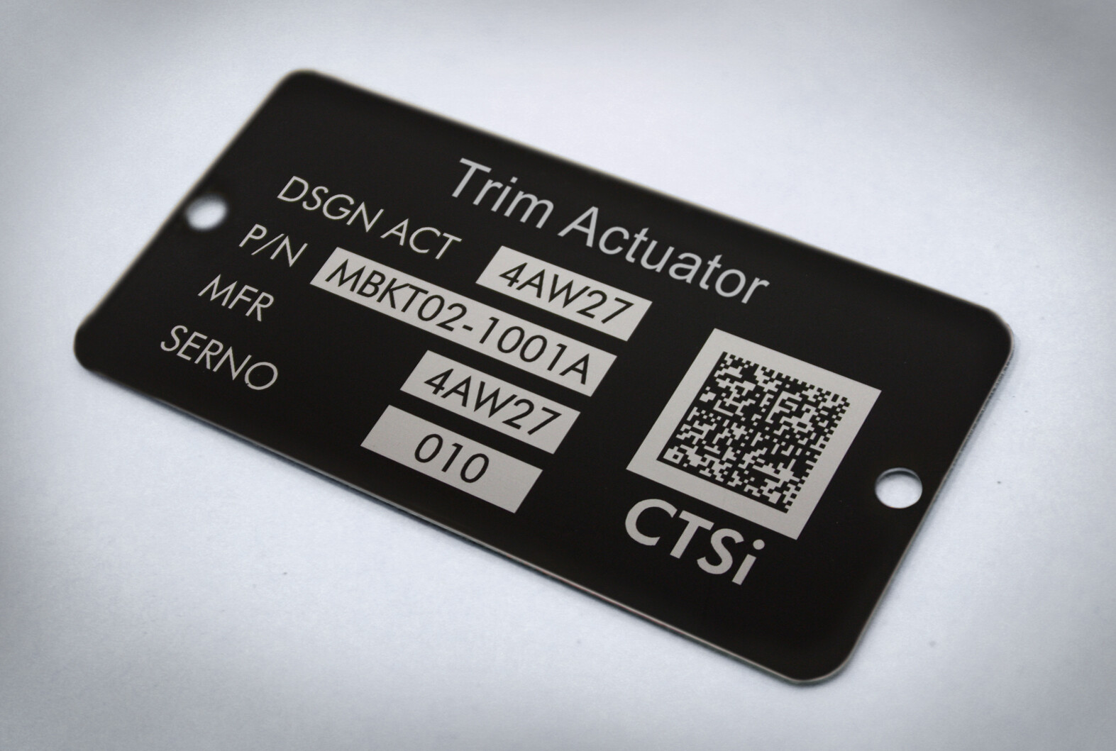

Ok, I think I’ve found the fundamental issue: this is the material I’m trying to use, but it’s meant for CO2 lasers, when I’m using a diode laser.
I think that’s the basic issue.
So, are there any kind people who have had a go at this material even though it’s meant to be for CO2 lasers?
Here’s the settings I’m using [still unsuccessfully] although a very slight wipe fingerpressure,will reveal the shape 75% accurately;
