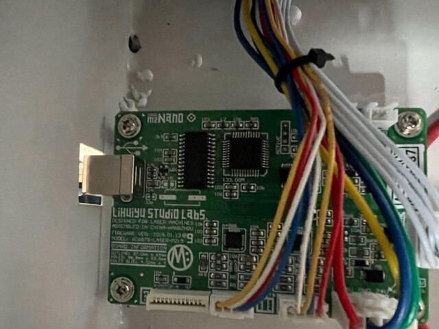

I am assuming the Ten-High 440 is a K40. This machine has a M2 Nano control board. Again LightBurn is not a school approved software which brings me to other controllers, such as the, " OMTech RDC6445G Ruida Control Panel Kit" found on Amazon.

Thank you for your suggestion. It does have a M2 Nano board. I love free software, but freeware is open to modifications. I have some overly smart students that will tear into it and I don’t want to temp them.

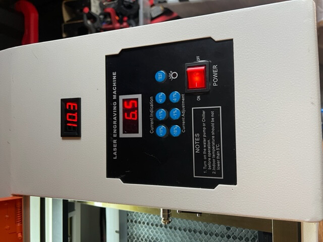

Post a picture of the machine, the control panel, the controller, the power supply, and the entire electronics compartment.

Thank you for your reply and for your request for pictures. The machine seems very rudimentary. It dose have a door switch.

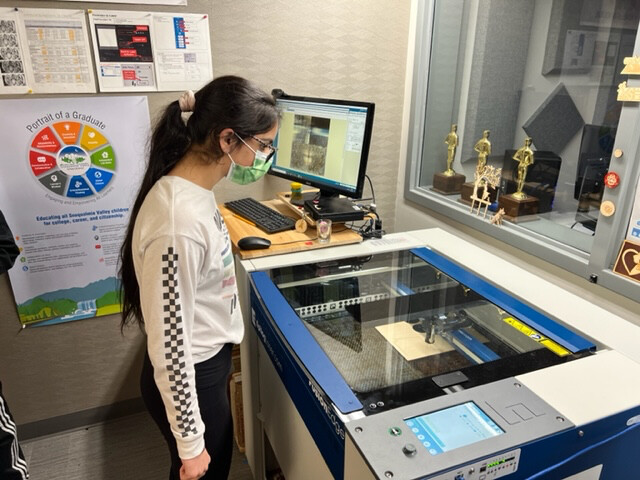

At the high school, we were using Adobe Illustrator and probably had a plug-in for the software to run the laser cutter.

If you’re information is correct, you have two different systems. One is a Ruida and one is a m2Nano. RDworks is the free software that comes with the Ruida controller and the m2Nano uses a proprietary software that you need a USB dongle for.
If you would like to only use one software for both, I would suggest LightBurn which will import AI files. It can also be used to send files to both systems. Unfortunately only the Ruida can use a USB to transfer the files to it and the m2Nano will need to be used with a computer and software.
You can convert the m2nano laser to a Ruida and then you have consistency between the both of them. Unfortunately it will cost will be between $500 and $1,000 plus the labor to convert it.

Alright. That’s a K40-like machine with an M2 Nano controller, a separate low-voltage power supply, a larger work area (should be 400x300mm), and a motorized Z table (AC motor, not a stepper motor).
It doesn’t use that flexible flex cable. That’s good news. Upgrading the controller would be relatively pain-free.
The machine should have a flow switch installed (in the tube compartment).
I don’t seen an EMI filter. Does the IEC socket have an integrated one? If not, consider swapping the IEC socket or installing a separate EMI filter.
The machine lacks an ammeter. I recommend to install one. An analog 0-30mA one would work, for example.
The machine has a K40-like XY stage which is a bit lame, but it does have a good head with air assist and a red dot. It should be able to produce pretty clean cuts with a sufficiently strong air source (e.g. a 60W aquarium piston pump or better).
Overall not the most amazing machine, but it’s quite a bit better than typical K40s. It’s perfectly usable as-is.
You’d need something like a Ruida RDC6432G or a (sort-of Ruida) Ryxon KT332N and two stepper drivers. The current low-voltage PSU looks relatively big. It’s probably powerful enough.
