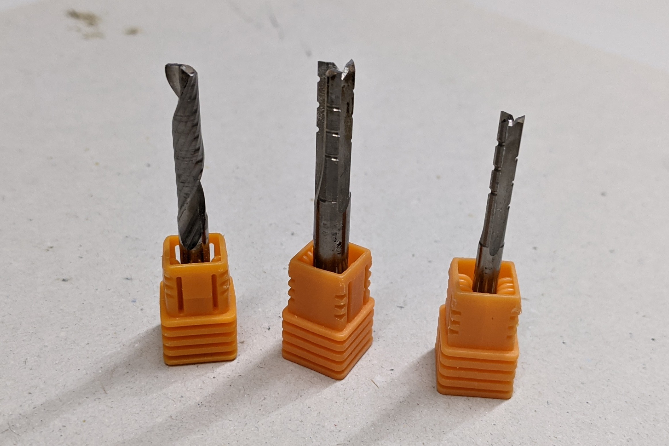

Shortly after I jumped into CNC machining I ordered some single flute mills from Aliexpress (the 5mm one on the left [1]). I’m still happy with the quality of the cuts I can get with them. :slight_smile:

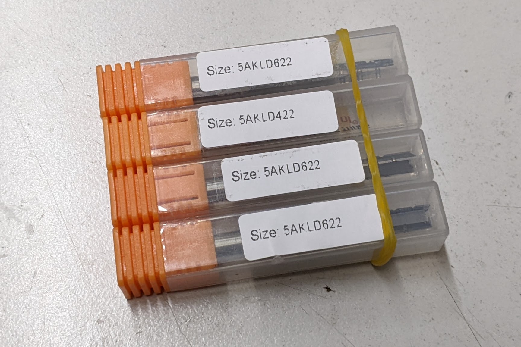

Some weeks ago I ordered the two roughing mills on the right (6 and 4mm with three flutes). I started with 6mm bit [2] and got nice results and less noise during the cutting process. It struggles a bit while diving straight into the wood (ramp plunge would definitely help).
Today I took the 4mm one [3]. I was impressed how easy it cut through the material and diving did not seem to be a problem. :slight_smile:

Is this the same tool as the 4mm you used [global aliexpress site] ???
Yes, it is. :slight_smile: Mine was not that long. I think it was a “4-22”.

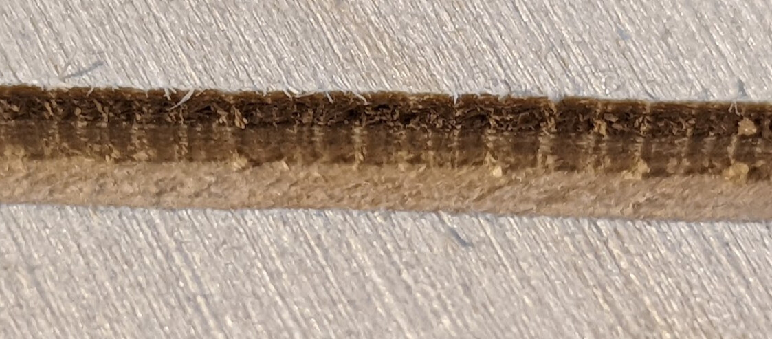

I ended up testing 4mm DoC, 4000 mm/min, 12K RPM (because 200Hz was easy to set on the VFD) and it worked great until the router drove off in an uncommanded rapid diagonal. It still didn’t snap the mill, which surprised me, but it didn’t cut cleanly at however fast it was going (at least 6000 mm/min).
That’s not the first time this board has glitched, but destroying a block of 18mm baltic birch is probably the most expensive failure I’ve had so far.
Here’s the rapid (>8000 mm/min since I had 8000 mm/min max on Y and 10000 mm/min max on X):
At 4000 mm/min, I saw a relatively decent edge is most places, but a few wobbles like this at small hidden knots (my router isn’t the stiffest available), like this:
I think 4000 mm/min would probably be fine in a stiffer router. But I next tested whether I could get better results in my router by dropping all the way down to 2000 mm/min for my next cuts, and got this edge:
All these were 12K RPM.
I hope that’s useful to the next person who is looking for this information!

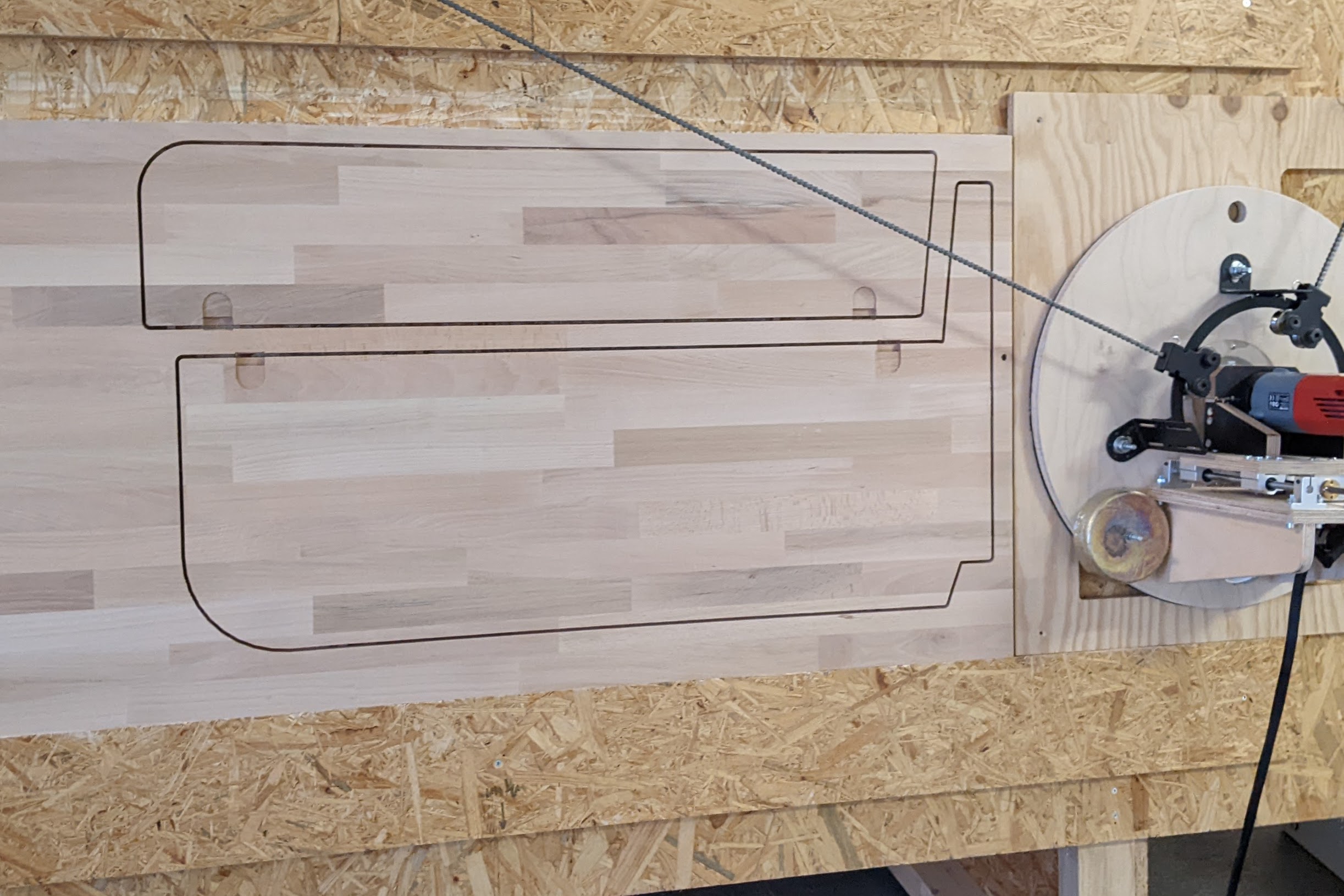

I was a bit concerned that the 4-22 bit would be able to handle this milling job. But it did it like a charm:
Material: Beech wood
Thickness: 18mm
Bit: 4mm dia, 3 straight flutes, 22mm long
Pass depth: 3mm
Milling time: Approx 3h for all parts (see pictures below)
Since my Maslow can not handle ramp dive, the 4mm bit did a much better job than the 6mm one (diving in without hickups).
