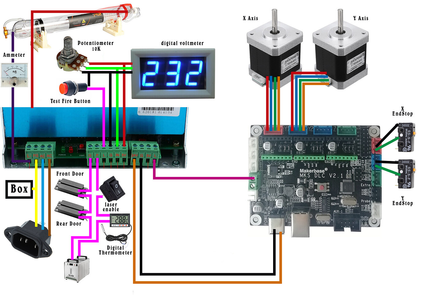

I have removed the original electronics of my K40 laser and I have put a MKS DLC 2.1 controller board, I have followed several schemes that I have seen on the internet and I have connected it in the following way:
But the laser does not activate, the power supply works fine, the axes move, but the laser does not turn on.
Does anyone know what the problem is?

Remove the wire (red) from the L pin (rightmost) on the LPS
Add a jumper wire to pin L
From the control panel enable the laser to fire
Briefly touch that jumper (on L) to the ground.
Does the laser fire?
  1. If it does not something is wrong with your LPS [go to 1a-b]
    a. If you have interlocks check to see that they are closed
    b. If you have a water sensor check that it is shorted
  2. If it does then something is wrong with the PWM signal coming from the controller
    a. Check controller PWM configuration
Let us know what you find from the above.

I have tried what you tell me and if I bridge L with ground the laser does not fire. I also have bridged G and P. I understand that the problem is the power supply, is that correct?

Currently I have the LPS out since I have enlarged the laser and made a 3D printed box for it. I have changed the electronics for an MKS and the laser cathode comes out from the L- pin to the ammeter and from the ammeter to the laser and the positive comes out directly from the LPS.
The power supply led turns on and the fan also turns on.
In IN I have 5V which is provided by the original potentiometer.
I have nothing connected to pin L of connector P3.
Do I have to make a jumper from the L pin of the P2 connector?
The FG pin must be in contact with the metal case of the laser?

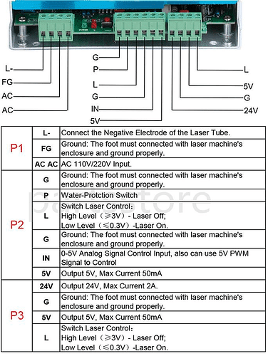

Now I have the following setup:
But I have realized that even if the potentiometer is at 0, if I press the test button on the front of the laser, it shoots me with a power of about 10 mA.
Also if I disconnect the potentiometer (0V in IN) and give the test button on the laser frontsl, it also shoots me at a power of 10mA.
I suppose this should not be so. Right? Is it possible that the power supply has arrived damaged?

Pulling the L input to 0V while the IN input is also at 0V should not fire the laser.
Did you measure with a DMM the voltage between Ground and IN to verify it was 0V?

In L and G I have the test button and in G and IN I have 0V measured with a multimeter.
As I said, being IN at 0V, when I press the test button (L and G) it shoots me at about 10 mA.
With L at 0V and IN at 5V you should get maximum power out from your LPS. With IN at 0V I don’t believe it should be firing like that.
What is the voltage on IN while you pull L to ground(press the panel Test Button)? A better way to do this would be to put a jumper between Ground and IN to make sure it is pulled to 0V.
