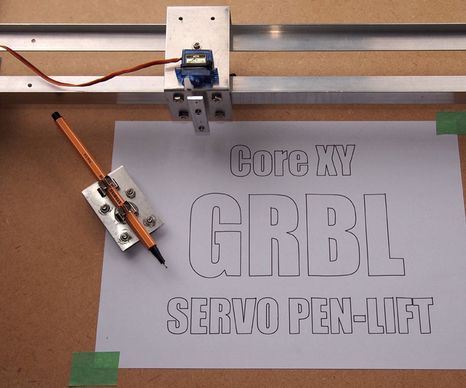

Have you seen this?
This is the official MakerBase resource which says that it’s meant to work with plain grbl without modifications, so it’s possible that the instructable above will work with it.
After following those link, what i understand is that there is no readily available version to print through pen, i have to tweak code to make it possible,
BTW is there some other framework available that i can use with arduino for pen plotter.
