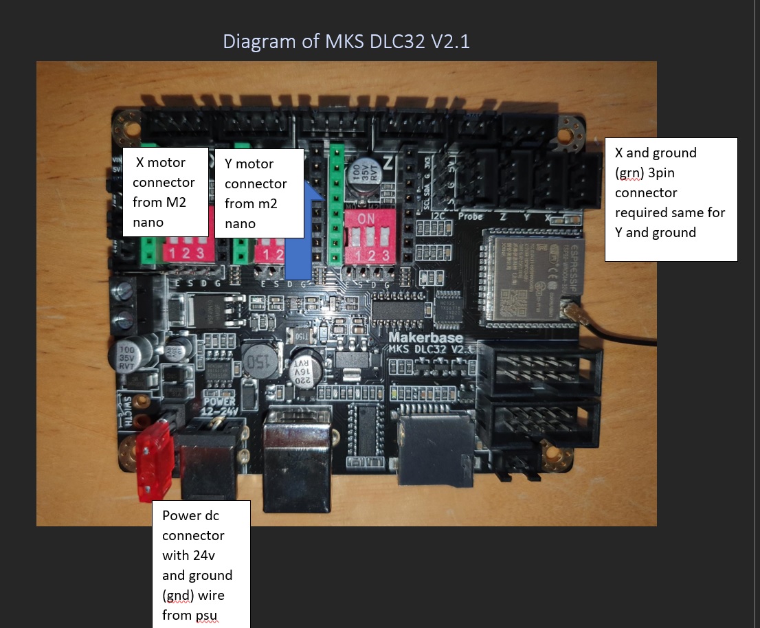

I’m looking for some assistance as I have just bought a MKS dlc32 2,1 board for my K40 as it would be nice to wifi and to be able to use lightburn directly instead of going via meek40t, now looking at some forums and you videos I have managed to work out where some of the wires go, see attached picture
and that I will need to order 2 x 3 pin pcb connectors for the limit switches and a dc connector for the 24v power required

I’m not sure what you mean here. What jumper switch, and correct one what?
There’s a general rule never to connect or disconnect a stepper motor with power on, as it can easily kill the stepper drivers.
Yes, you need to connect up your laser PWM control. It is common to leave the POT connected to the LPS( 5V/IN/Gnd) and use that to set your maximum avg current output(~18mA) and then you use one of the FET connections on the board to pull the LPS-L signal low for PWM control.
Stock motors are 9deg motors so 400 steps/rotation. As for the switches on the board, those set the micro-step setting and you can use 1/16th or 1/32 and after you set the jumper, install the motor driver boards(tmc2209 can be a good choice) you have to setup your firmware config’s “Steps/mm”
  • so that when you command it to move 100mm it moves the motor enough steps to truly get 100mm of movement.

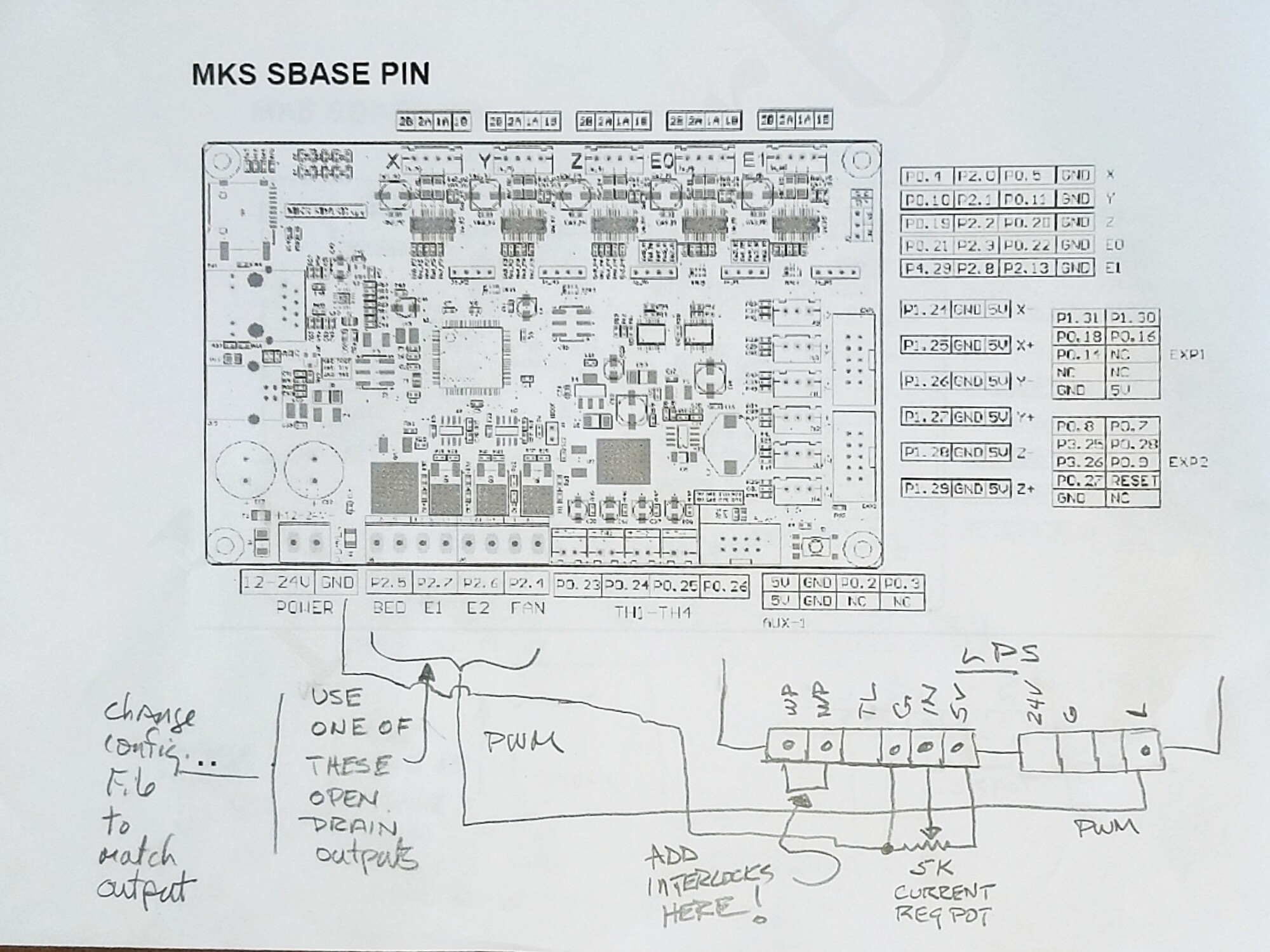

This is a conversion I helped with but is not the same board. The implementation should be similar.
Perhaps you can use this as a reference to choose the equivalent connections on this alternate board.
Found this over on the Lightburn forum:
This configuration does not use a pot.
I would suggest using a pot rather than digital IN control.

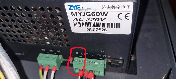

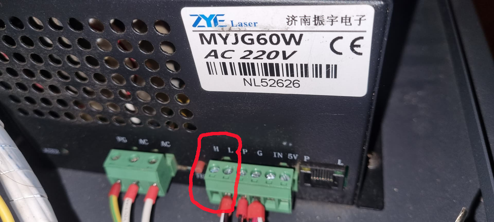

What LPS do you have? Please post a picture of the connector.

The L input is laser enable, but most also have an H input, which is enabled high, so you wouldn’t need to invert the output signal… just wire it to the H input instead …
I just don’t think much of the ‘pot’ to the IN structure… That is not how it’s designed … Seems to work …

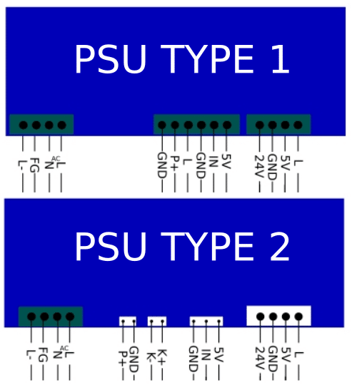

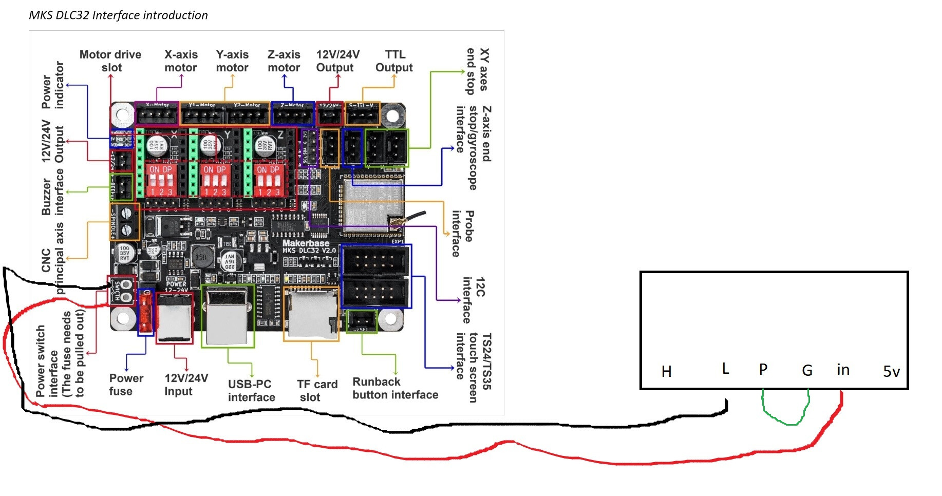

Hi all,
So just need to confirm something and we are hopefully up and running. So from what I have understood for the laser to fire we need the L- and the IN from the psu type 2 wires from the psu going to the motherboard spindle and L- on the spindle negative and IN on the positive, is this correct?
The reason for asking is I may have accidently killed my tube
