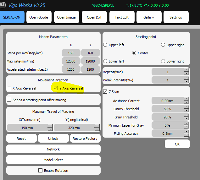

The carriage X &Y were reversed, doh! cables were backward. Both X & Y moved 1/2 the expected distance. Doubled the step settings and it now works correctly. The default settings were loaded by VigoWorks based on selecting this model unit. Seems the default settings for this model are wrong in VigoWorks.

The X &Y cables were swapped and that explains why the Y-axis default setting is REVERSED.
