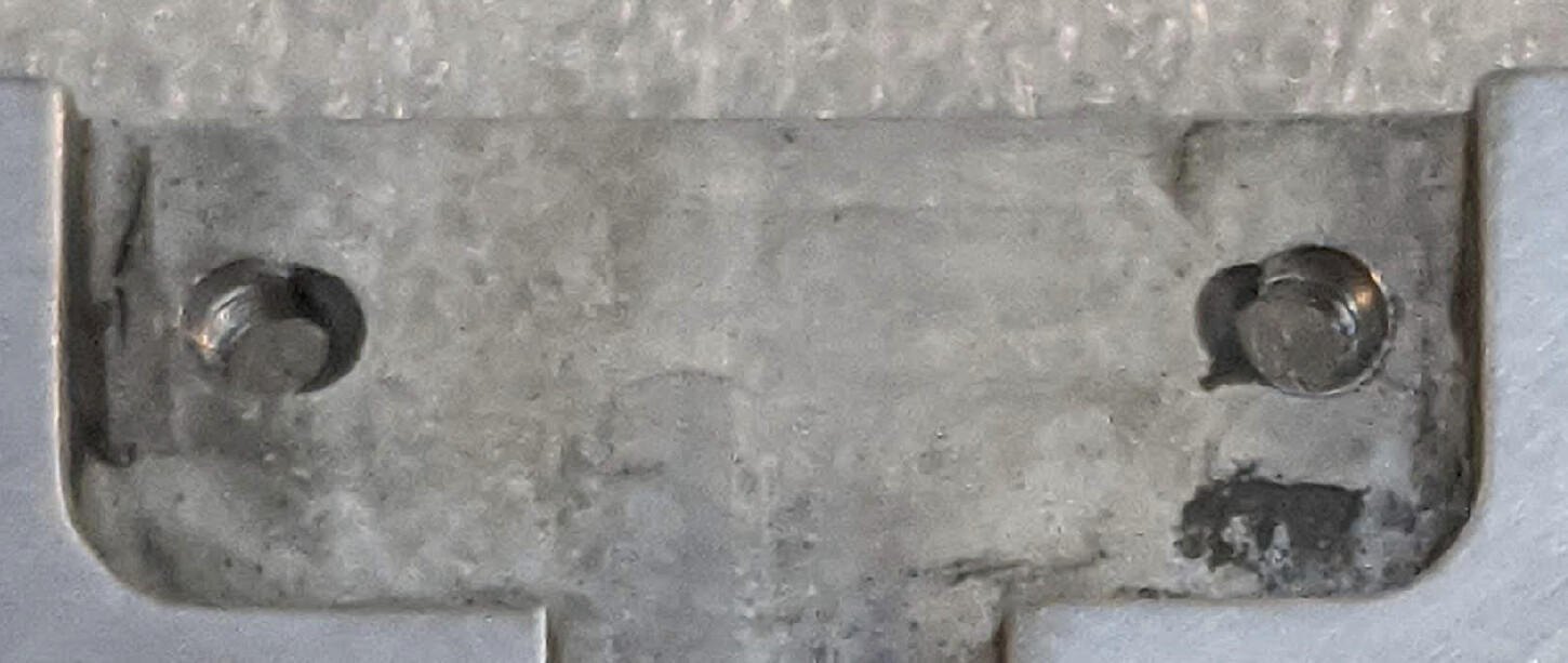

Filling in the tapped holes with JB Weld, letting it cure, and redrilling and tapping worked well. Here’s the usual blurry cell camera picture that shows the overlap.

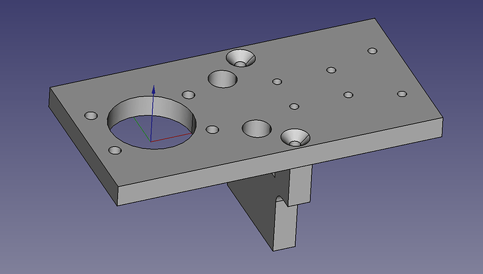

After all that work, I realized that moving the belt to the top was going to cost me some X and Y travel. So instead I’m first trying to use the belt position I came up with initially. I’ll drill two more holes for M4 screws to attach a belt fixture. A typical 40mm x 9mm belt clamp screws into the bottom, holding the belt in place. (This part could still be 3D printed trivially enough, but I’m going to use the mill.) The cut-out at the top goes around the carriage.
The new design, done with the latest realthunder build of freecad, is pushed to the repository. I haven’t cut it yet.

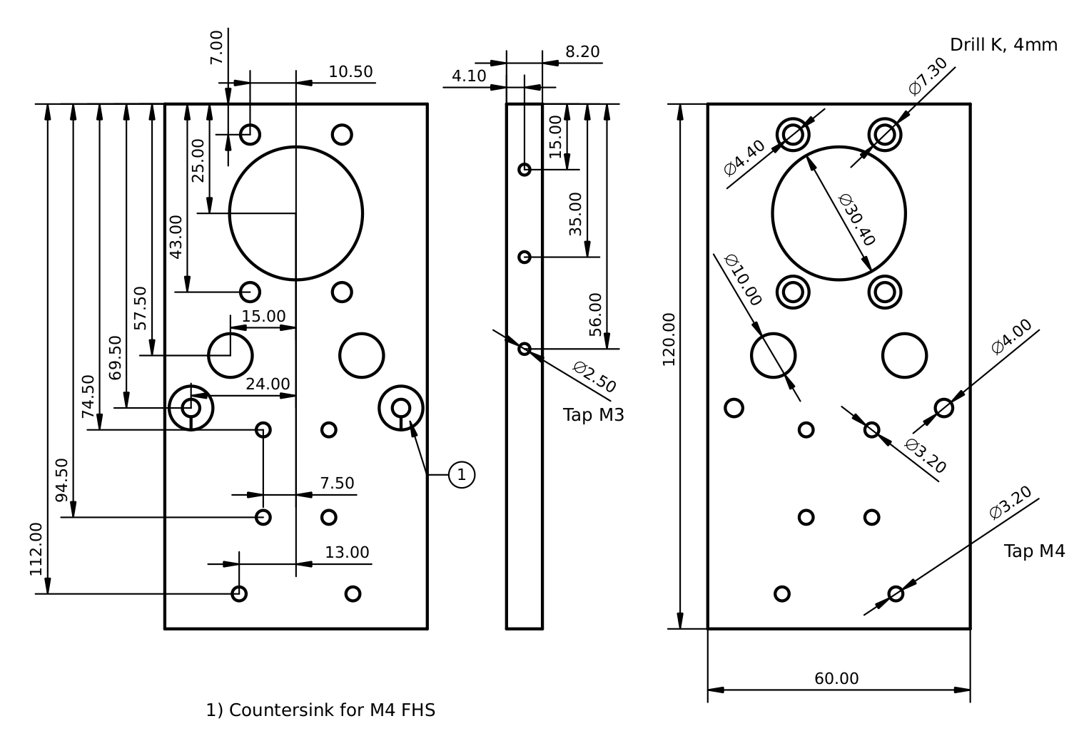

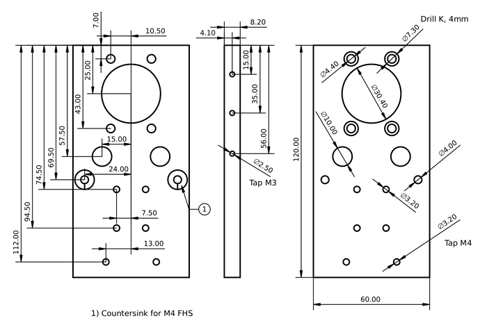

Here’s my print, such as it is (if you know what you are doing, sorry if your eyes bleed when you look at my prints):
Edit: updated print for latest changes; one actual change in dimension, and a few missing dimensions and annotations added to the print, after making the latest version.
